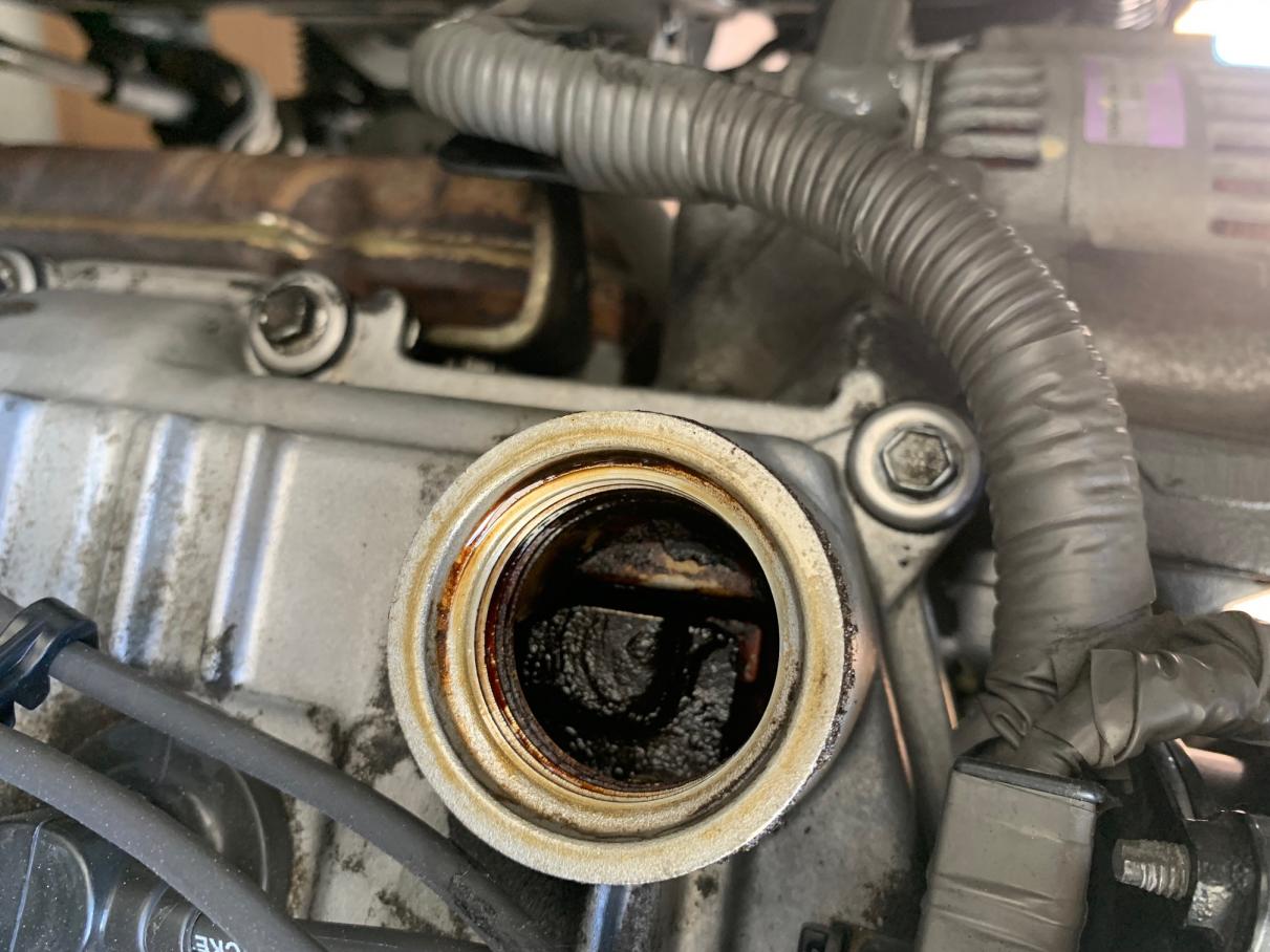

4- My biggest concern: I drained the oil to change that while I'm at it since the truck is new to me. I had a look before refilling, it looks a little scary in there. (pic attached) any magical cleaners I can run? I did not fill it with oil yet in case there are good ideas...

DO NOT run a flush in the engine. It is very normal to see that build up on the baffle in the valve cover. When you replace the valve cover gaskets if the whole inside of the head looks like that the that's a different story.

Thanks guys! I'm relieved to hear that about the spot under the oil cap, I nearly had a heart attack when I looked in there...

I definitely hope the underside of the valve covers don't look as crisp as the engine oil fill hole... lol.
