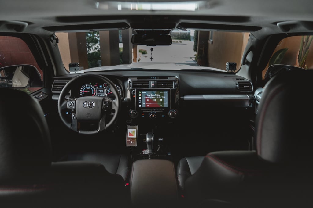

Couple shots of the new addition. Why did i do it? Probably because I spend so much time traveling and driving vehicles with much better infotainment systems. (get with the times toyota)

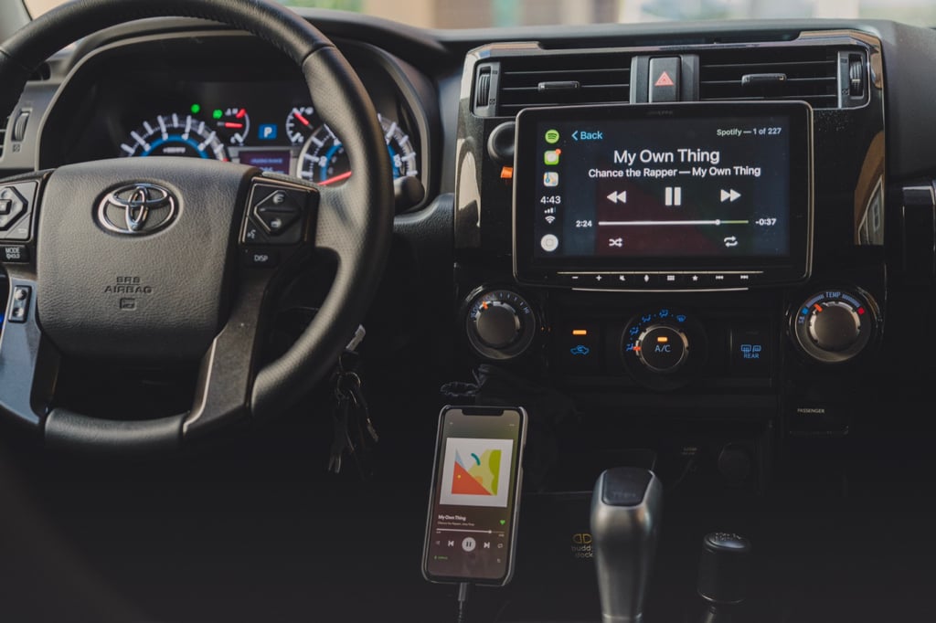

Additionally I wanted to display more vehicle information. Overall I'm really happy with it, relocated it to the lower slot using the DIN mounts that came with the dash kit as you can see in the second image.
The sound quality (especially with the R series speakers) is incredible. Amp was installed under the drivers seat though, wasn't too keen on that but its a clean setup regardless. Took a bit to learn the system but overall its fairly intuitive, and the interface is as responsive as any of the good cell phones out there. The only thing I wish it had was pitch and roll indicators.
Cheers.
Additionally I wanted to display more vehicle information. Overall I'm really happy with it, relocated it to the lower slot using the DIN mounts that came with the dash kit. The sound quality (especially with the R series speakers) is incredible. Amp was installed under the drivers seat though, wasn't too keen on that but its a clean setup regardless. Took a bit to learn the system but overall its fairly intuitive, and the interface is as responsive as any of the good cell phones out there. The only thing I wish it had was pitch and roll indicators.
Cheers.
Sweet. I am looking at getting the same unit. Some have complained on a start up delay issues after 2-3 start-ups, can you confirm the unit doesn't have the issue. How was the install? With the amp, which amp did you use? an alpine in-line amp or another after market? Anything else you can share would be appreciated. Thanks for sharing!!!
Used all alpine components. Can’t remember which amp it is, think it’s the upper mid-level one they make. Haven’t had any issues with startup delays. Usually takes about 10 seconds for the system to load, during which time it displays the blue alpine opening screen.

I love the interface and looks of this unit but I can't get past how it partially blocks the center AC vents. We live in south Texas and that AC on blast is an absolute must May through September and impeding that direct flow seems like a major fault.
Very nice! Trim piece matches very well, what is that trim kit #? did you have to have it colored or did it come like that?
Take a look at the second pic, just uploaded it to show the difference between mounting in the upper and lower DIN slots. The Metra kit comes with brackets that let you mount it on the lower one. makes a HUGE difference, I'm currently living in central GA, we get all the heat you guys do.
Can you take a side profile pic with it installed in the lower slot. Just looking at the Alpine plug and play and it appears to not be in the lower position...so does your unit include everything as this one but just using a black metra trim?
Any idea on the amp wiring side of things...assume rca inputs to the amp and then speaker leads back to the main harness...did the use a patch harness, tap the leads or extract the pins out of the harness?
Cant speak to the amp wiring, recommend you go to the alpine homepage for that info, i didnt do the install.
Metra makes both dash kits, silver and black. The kit has two rectangular pieces that are double-din mounts. The intent is for the system to be mounted in the top portion, but those mounts let you place it in the lower slot. you can kind of see it in the first picture, all the way on the far side of the radio you can see the black piece with two obling holes in it, thats one of the pieces. Only down side of doing it this way is there's a gap in the upper din slot now as they didnt create a piece of trim to cover it. you can see it from either of the front seats though so im good with it.
