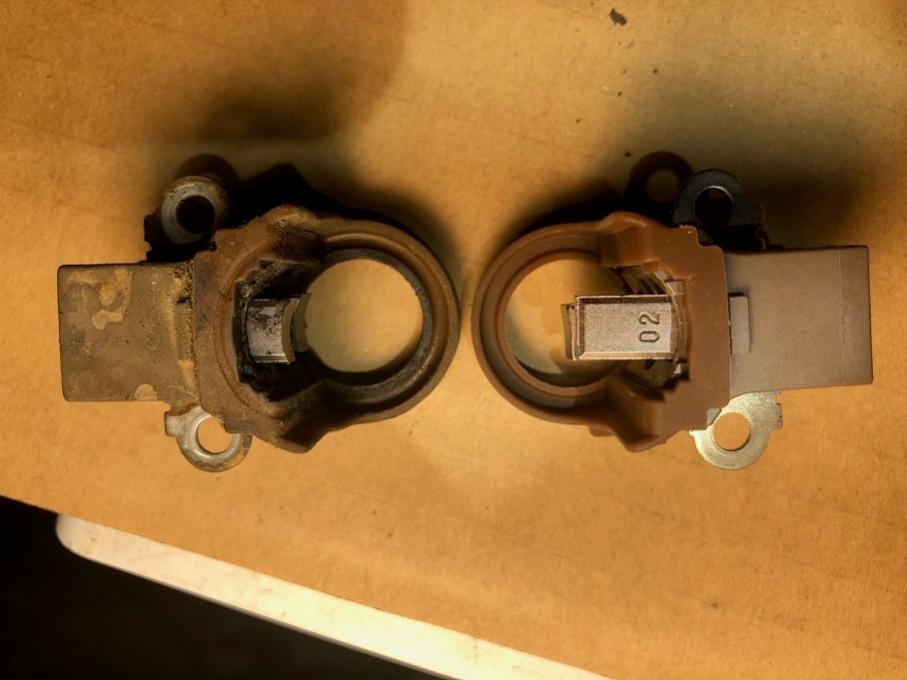

Do you have a hammer? If you do give the Alt a good shot and start the engine. If the battery light goes out it’s your brushes. They are cheep and easy to replace.
This is what my brushes looked like compared to new brushes at roughly the same mileage as yours. I would seriously consider new brushes or Denso reman even if your alternator tests good.

and yes it is easy to just do brushes

It’s easy Changing the brushes. But up to you.
Most reman companies only replace what was bad/failed. Is Denso the same……probably…….pay the extra 40 dollars for a lifetime Warranty on a high milage rig. They figure it will be in the junkyard before it fails again.
As an example. they receive a Alt with worn brushes……the correct thing to do is Chuck it in the lathe and turn down the commentator where the brushes ride. They don’t. Put cheep China soft brushes in and 1 year later you get the battery light again. Pull brushes and they are nubs. Like they had 200k miles on them and the Alt only had 20k miles on it.
