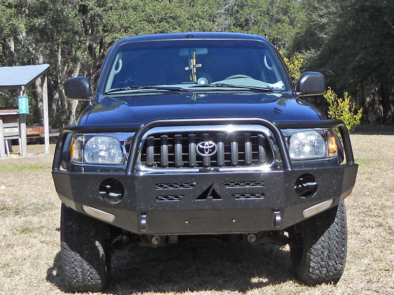

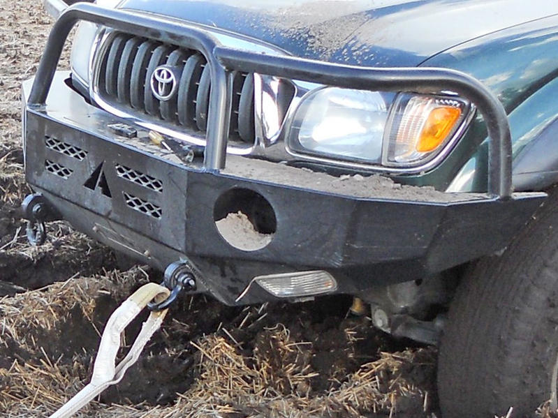

I've been looking into an aluminum front winch bumper and of course there aren't a lot of options but I managed to find one that looks like it could work. Aluminess makes a 1st gen Tacoma bumper and looking through the installation guide it seems pretty similar to the ARB Tacoma bumper. I'm just wondering if anyone has put this on their ride or if this bumper even looks like it would work on our 4runners. It's pretty spendy but it looks good and is something different than what most people are using.

Holy big bumper batman.
I dont know if its just me but that thing just looks too big, dont really flow with the lines of the truck.
It does look huge but the site says it weighs only 70 lbs.
The ARB is only 78 lbs (claimed weight)… hardly a savings.

the mounts may be the same but by the looks of the second picture, it looks like it follows the lines on the taco front end.
