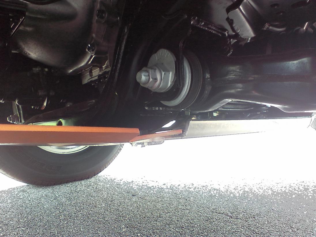

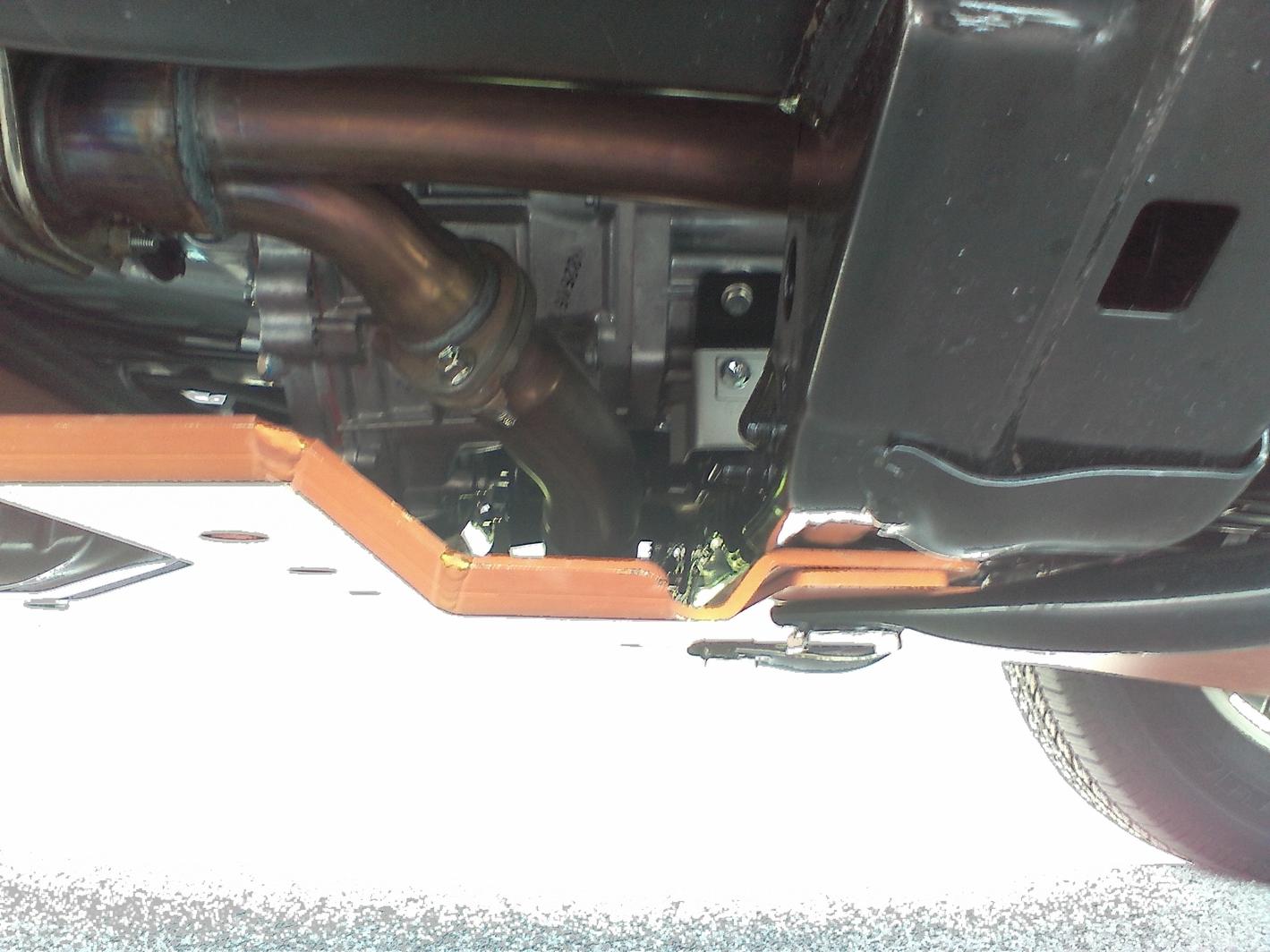

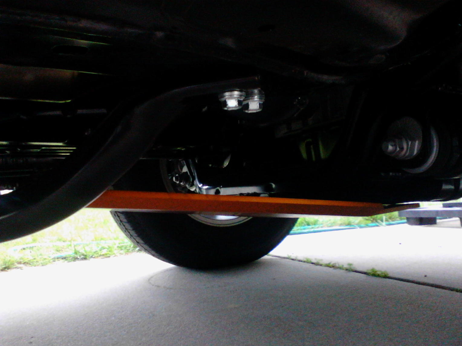

I also have found that the Asfir customer service is top notch. Kelly Ruiz, the Territory Manager at Asfir contacted me a week after my purchase to ask how the install went, if the instructions were complete, if the hardware was all there, etc. She also wanted pictures of my 5th Gen with the skids on for their website. (I did ask them if they were looking at producing a gas tank skid, they are not.)
As LimaMike noted, we all know the debate and can go back and forth forever on trade-offs and the benefits/drawbacks of steel and aluminum. I haven't tested the Asfir skids out myself as I just got them on a week or so ago, but from what I see these are perfect for my needs.
Of course time will tell, but for me the aluminum skids were the way to go.
