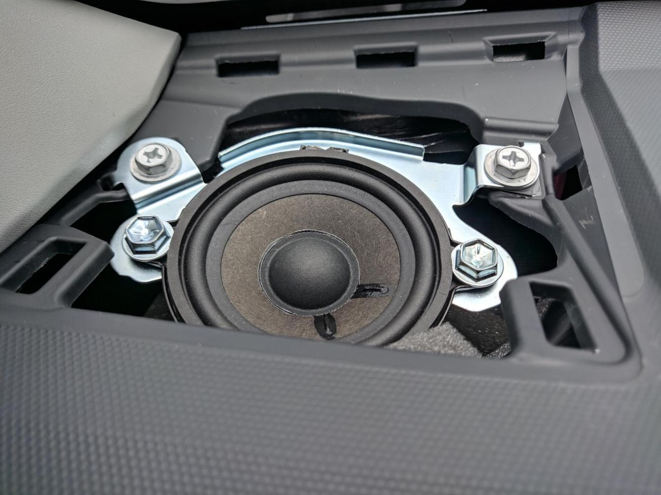

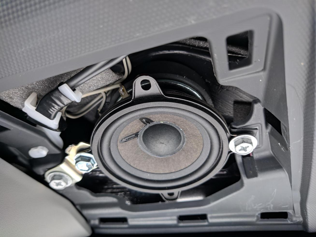

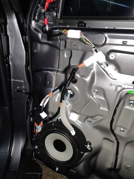

Pretty much same as the other threads. Used stock harness. Replaced the resister with a 47uF 100V Electrolytic Non-Polarized Crossover Capacitor (about a 800 Hz highpass).
Driver side speaker bracket was almost a direct fit, just had to trim the inside "ears" from the stock speaker bracket and one of the speaker tabs. The passenger side removed the left side bracket, trimmed to fit and installed.
Overview:
Probably the best sounding single speaker (not coax) upgrade available. Mid bass super tight but could use a little more top end. Overall a worthy alternative to the JBL, JL, Infinity everyone else is using. Might consider changing the resistor value to get a lower high pass, maybe a 133uF (around 300 Hz), but it sound good for now. Guess depends on if I change door speakers or not, or if adding amplifier.
Being in Hawaii, shipping costs from PE was crazy expensive, but you continental folks might get small or even free shipping. Cost per speaker is $20. I ended up buying them from Amazon for about $50 with shipping.
attached install pics

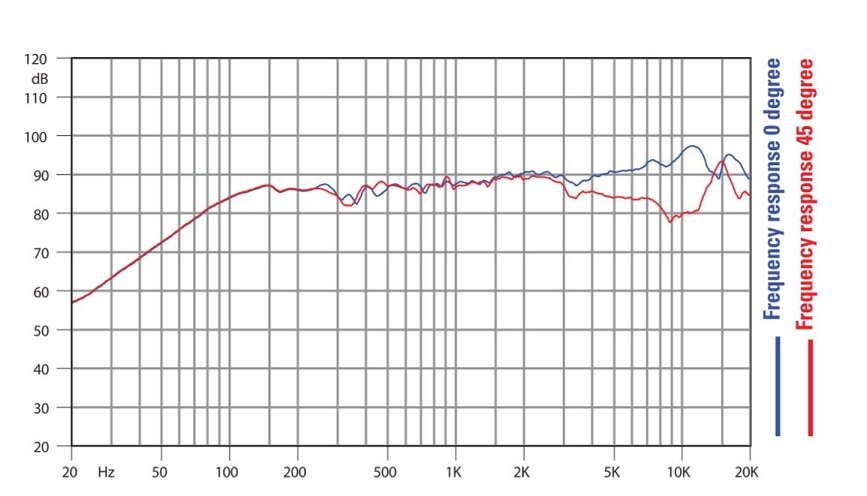

I have this driver as well. It's made in Italy and the build quality seems pretty good. Got it about a month ago or so. It has the highest sensitivity I have seen in the 3-3.5" range, meaning that it can get loud with little power. It is very, very detailed, more so than the Kappa 32.9 cf or the GX302. The driver is a bit bright on the upper frequency range. The frequency response chart on parts-express shows a peak on the upper range, but that it goes down when placed a bit off-axis. So I'm still playing with the EQ and the driver positioning to try to tame the brightness a bit. I have the JBL on a 2013, which may have a bit of boost built in the app in that range as well. Have you noticed the brightness in yours and have you done anything to correct it?

Not sure why this is listed as a woofer, since this is a full range driver that goes up to 20k Hz. Here's the frequency response chart.

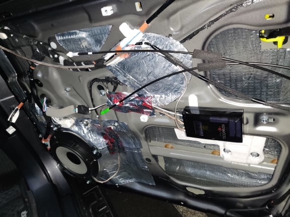

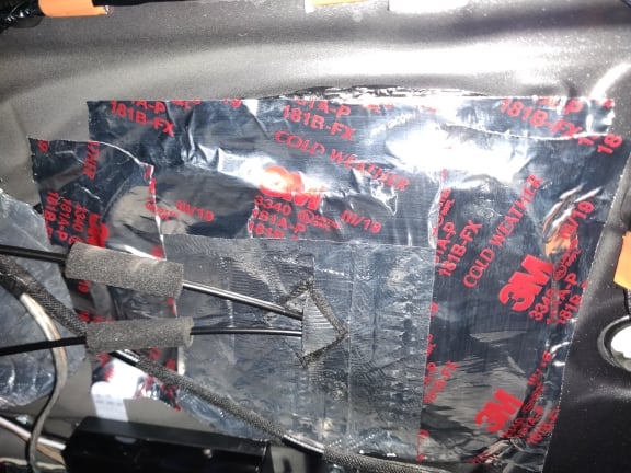

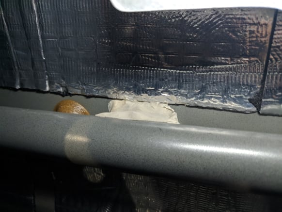

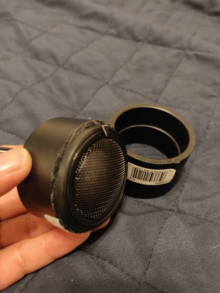

Installed some new components
Kenwood XR-1800p $179 on Amazon
7" woofer with mounting bracket
1.75" tweeter
Crossover unit

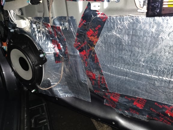

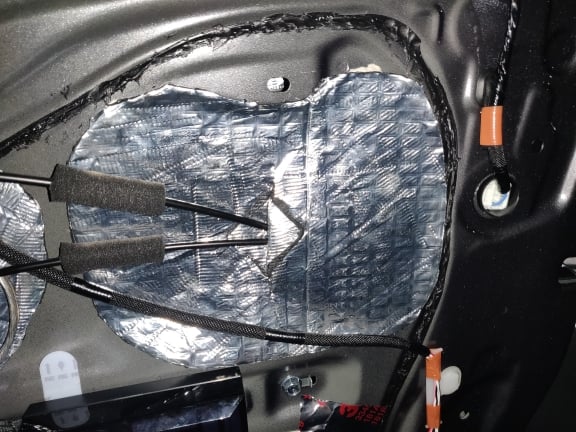

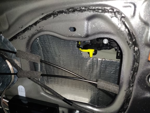

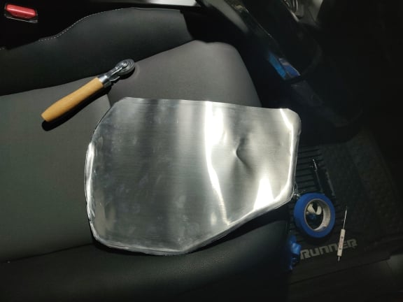

80% outer skin cld coverage

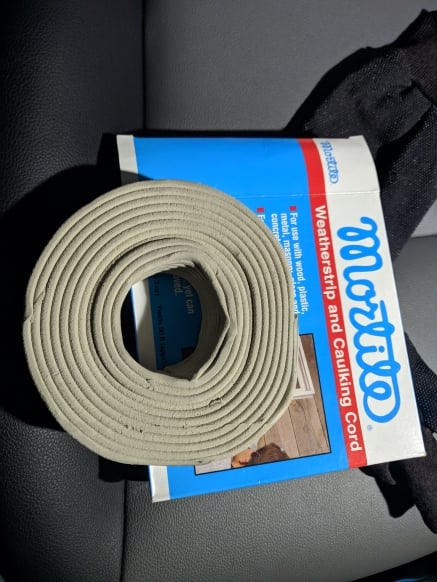

Caulking rope for reinforcement bar
40% inner door cld coverage
Aluminum flashing with cld to cover holes
Don't mind the crossover mounted in door. Temporary till amp install. Just needed temp mount using factory speaker harness to power and break in.
Overall, mid bass is much tighter. Hits some pretty low frequencies much better than stock. Had tweeter installed (not shown) temporarily for sound. Pure ghetto just dangling in corner.
