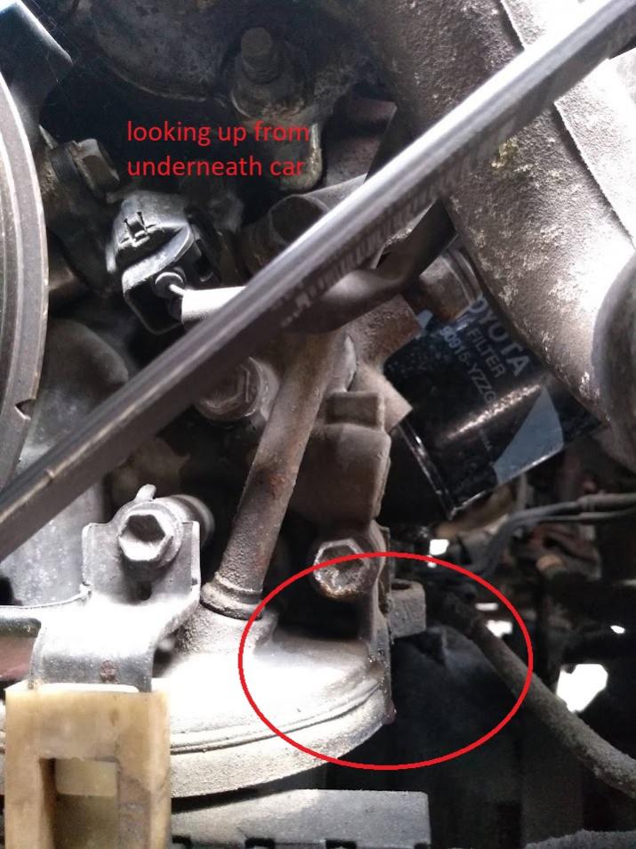

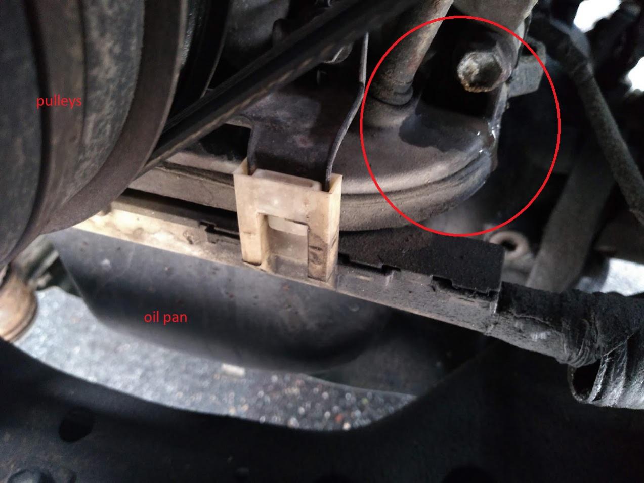

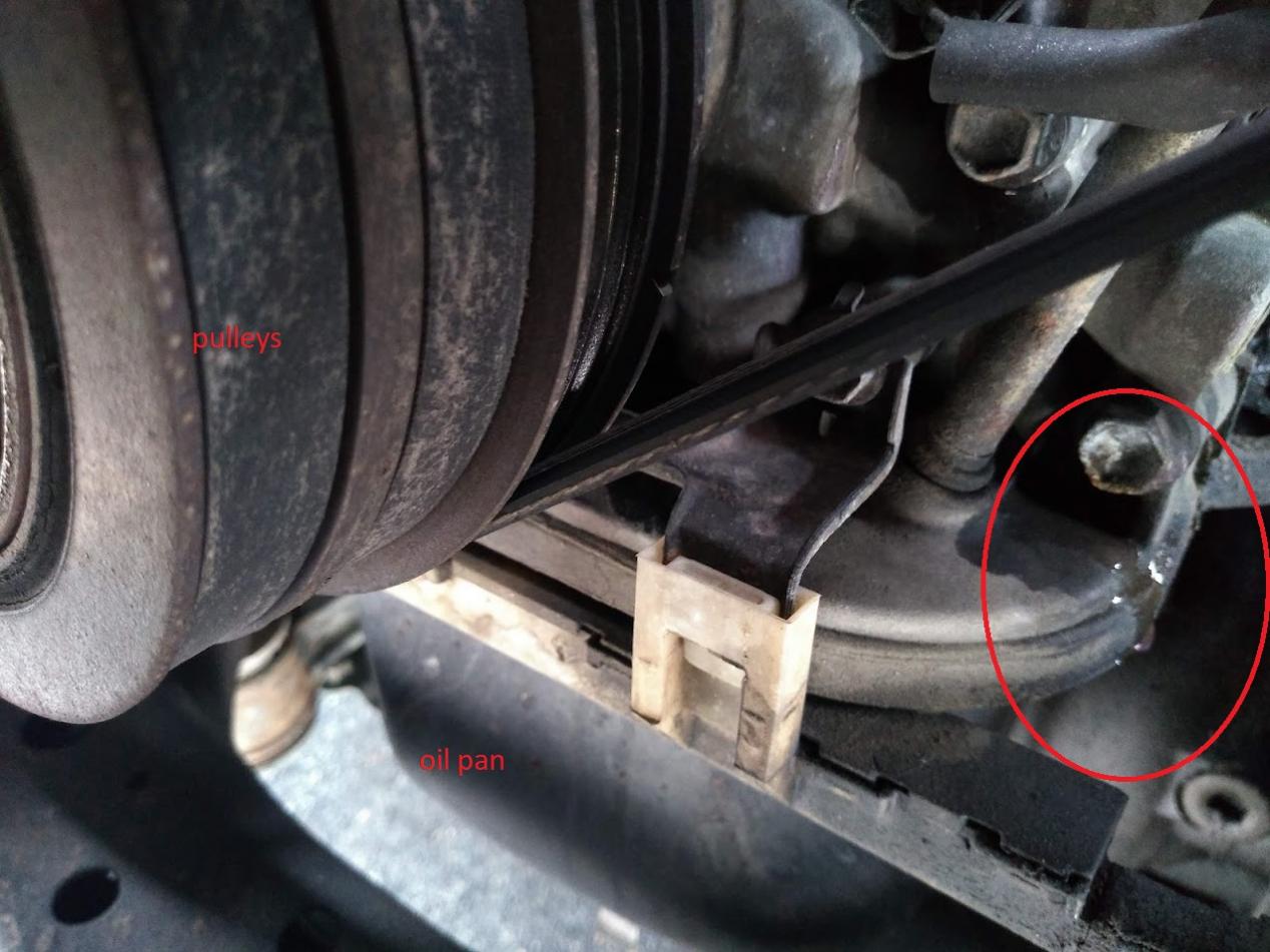

Well, here's a game changer. I went out to my car at lunch and found water running out from under it. t was steady dripping from what I assume is the water pump. No info from PO on TB/WP service. Is the coming from the pump? No signs of water 2 hrs after I got to work, but 4.5 hrs later, I find this leak. Did the engine cool down and allow a seal to contract and weep?
Is it water or coolant?
It's hard to tell from the picture.
To check if it's the water pump you have to pull the top plastic timing belt cover back.
It's coolant. I'll pull the cover in a few minutes and see what it looks like. It could be coming out of the thermostat housing as well. It's near that general area.

That's the whole system for cooling the engine, minus the fan and fan clutch. The leak is most likely the water pump but could be the thermostat housing. Since you ordered a new thermostat that's the time to check if the leak was coming from there. Do not use any sealant on the thermostat but be sure to use a new gasket as that's what actually seals the housing. If that doesn't fix it assume it's the water pump.
Put some UV dye in the coolant, and use a uv light to see where the fluid is originating. You can get a kit for this at any autopart store and it works well for large leaks
OK, so I pulled the timing cover and it was dry. The belt and pump actually looked like it has been replaced at some point. The coolant is leaking from back behind the thermostat housing. It looks like a flange of some sort? It doesn't look like it's coming from the actual housing, but whatever it is bolted to behind. Maybe I'm wrong. It may just have to go to the shop.
An oil cooler hose attaches just to the right of the thermostat.
Could be leaking there.
Are the thermostat stud nuts tight?
The thermostat housing and the oil cooler nipple are part of the water pump.

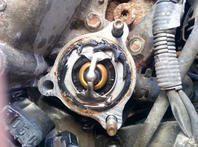

Thanks for this info. It looks to be coming from the oil cooler nipple area (actually where it seals to the head). I have ordered a timing belt and water pump kit and will get it replaced next Wednesday.
