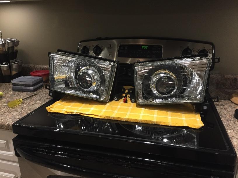

Something I do a lot of are retrofits, it's a consequence of living somewhere where we have 4 hours of daylight in the winter. I finally got around to doing the runner!
It's not exactly a budget build but I also didn't go all out.
TYC Housings - $46 Each ($92.00)

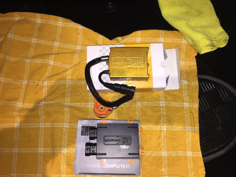

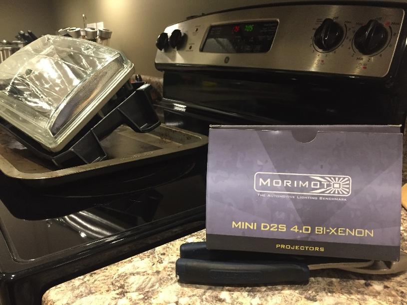

Morimoto D2S Elite Kit: ($124.00)
- Mini D2S 4.0 Projectors ($120.00)
- 35W XB35 Ballasts
- D2S 4500k Bulbs
- Iris Shrouds
So all in, I'm in for about $336 plus two hours of my time. I have to say, it was one of the easiest retros I've ever done!

Those look sharp. This is definitely something I plan on doing soon. Dumb question, but does Morimoto supply all the necessary hardware for the projector install?
Depending on which projector you pick, some come with threaded shafts so everything snugs up on its own! Other ones you have to get more creative with JB Weld and screws. I know for sure that the Mini H1 and Mini D2S are threaded.

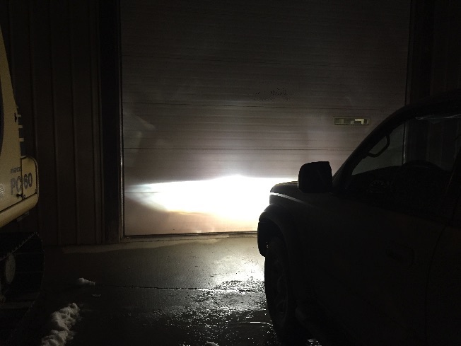

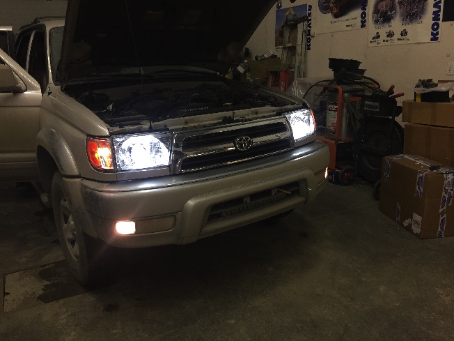

Got everything installed tonight. Spent a bunch of time chasing a bad ground on the drivers side - fixed it by changing the orientation of the igniter from 6:00 to 9:00. Strangest thing.
Still need to adjust the passenger side cutoff as it's a hair too low.
