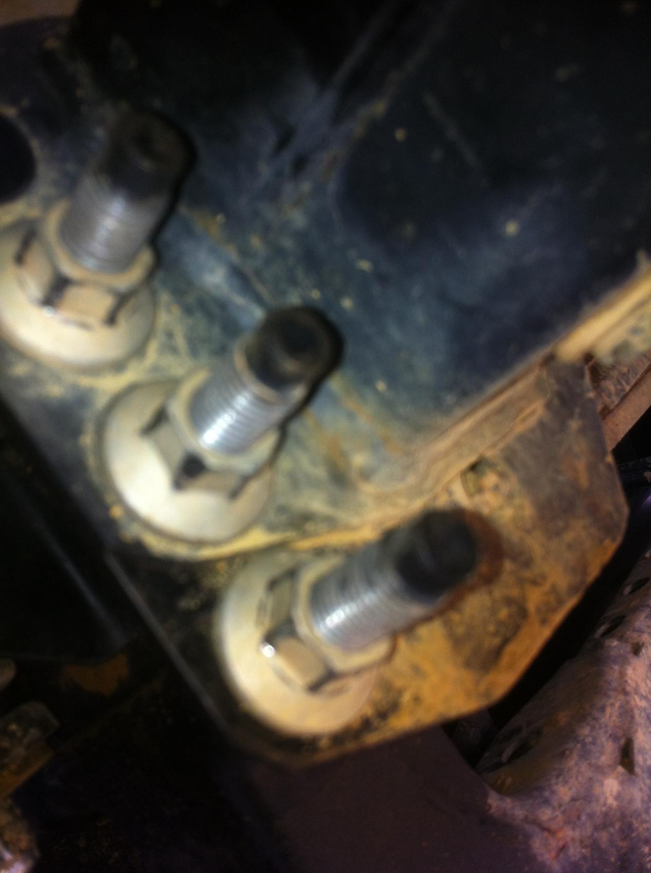

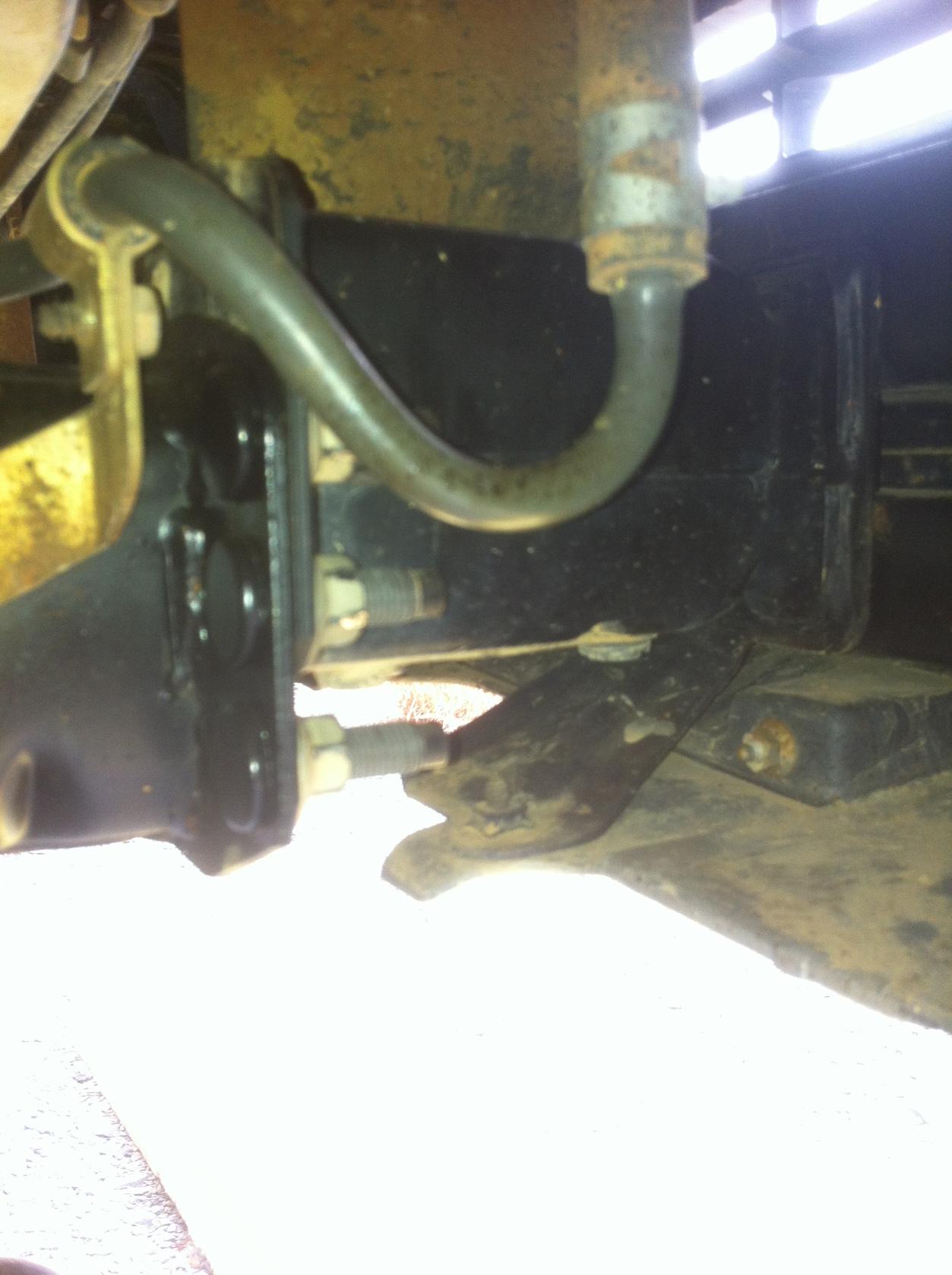

yep, pull the bumper cover off, (ie four 10mm hex head bolts on the front underside and two screws at each fender well front, bumper side of the fender well. the on the front top of the bumper theres that black trim piece thats held on with a series of clips unclip that trim piece theres two more screws behind it for the bumper cover.)
once the covers off you'll have exposed the main bumper bar thats mounted to the main frame rails, each side has 4 studs remove all the nuts from the studs pull the bumperbar off then remount the bar moving it up the stud pattern of the main frame rails when finish the top two outside studs will be the main mount studs being used to hold the bumper on; however, put the other nuts back on the mounting studs not being used and you'll find the nut flange still catchs the bumper bar mount plate.
