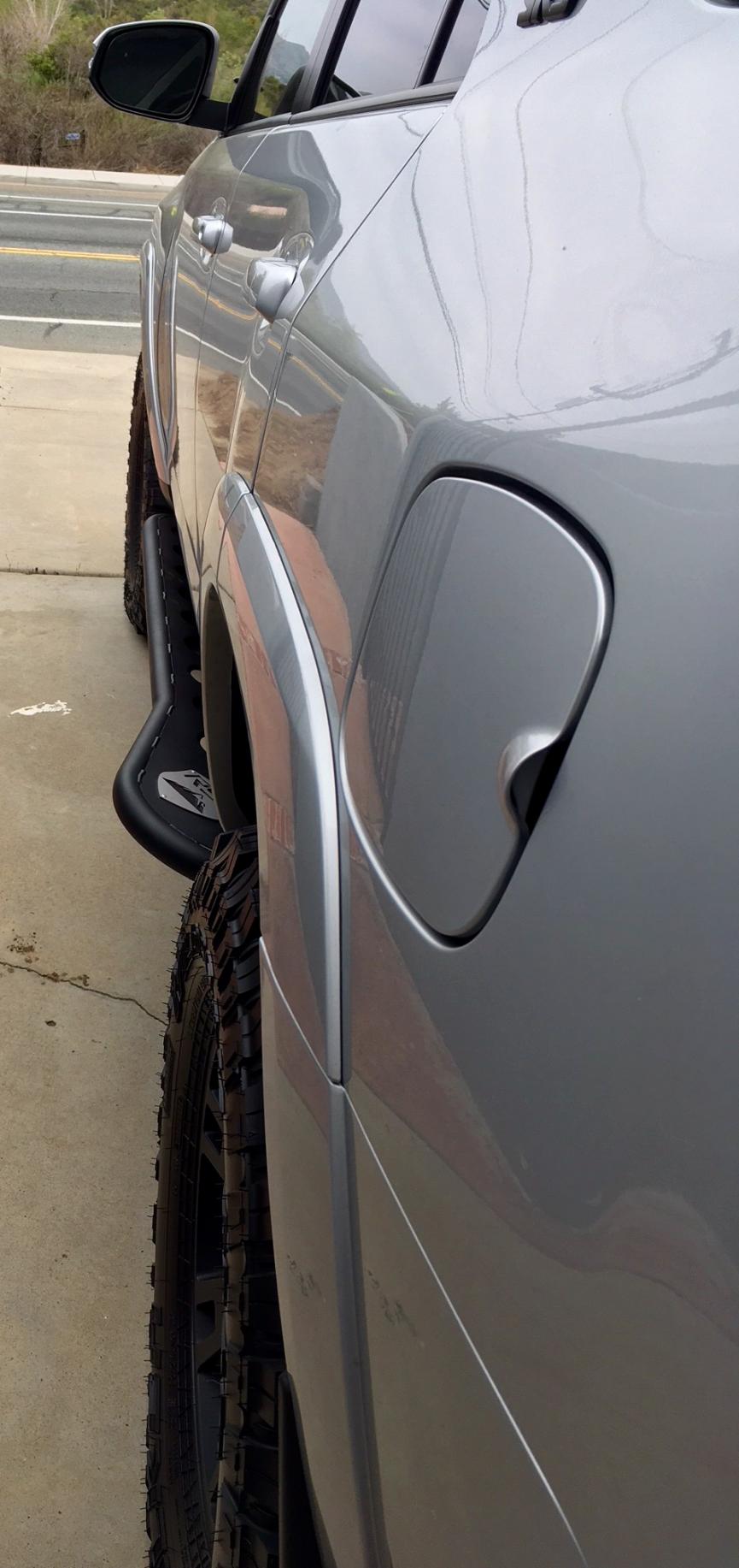

I’ve got the savage sliders a post or two up but had Roy add a second set of kick outs so there is a step for front and rear. They look pretty sweet. Cleaned them thoroughly, auto self etching gray primer and then truck bed liner.
