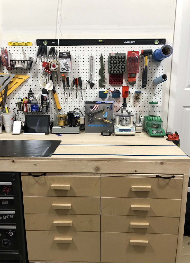

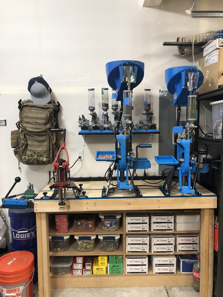

I run dual Dillon 650's for both pistol and rifle calibers with a Co-Ax for precision long distance stuff.
Calibers:
9mm (124 plinking, 124 SD, 147 Subs, 165 subs)
38sp/357 Mag
223 (bolt and AR)
223AI (bolt)
300blk
308 (Subs and plinking)
6.5 Creedmoor
7 SAUM
Calibers:
38sp/357 Mag
223 (bolt and AR)
223AI (bolt)
300blk
6.5 Creedmoor
7 SAUM
