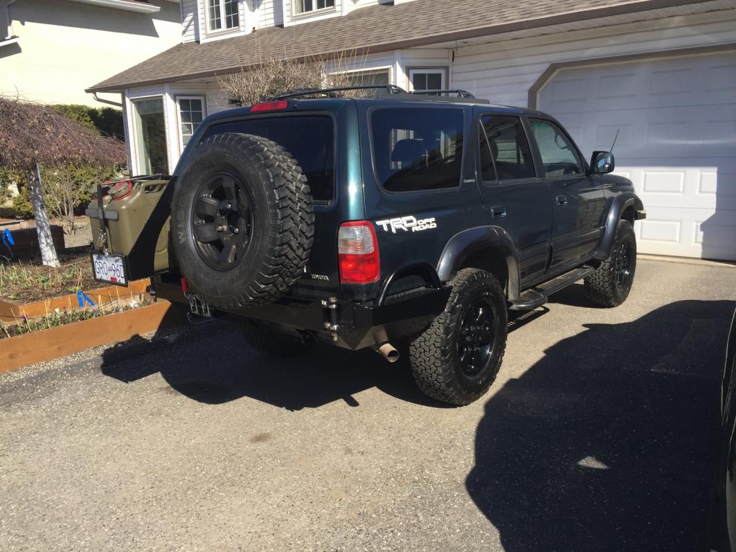

I've just finished the Coastal Offroad rear bumper and swing out kit. It is VERY solid and complements my CO skid plate, rock slider and front bumper kits. However, my 110V MIG was not up to the job of welding the thick bumper plate, so I farmed out the welding of all except the skid plate.
It took about 10 hours to build the rear bumper and swingout kit to the paintable stage.
Note that the fuel holder will only hold two military SPEC fuel tanks (C$100). It will not hold military STYLE fuel cans (C$25) because they are 1/2" wider at the base than the military spec cans. Brandon is willing to modify the fuel holder kit on request.
Mark, thanks for clarifying my confusing post. In a nut shell YES, the Princess Auto fuel cans DO fit!
The red Scepter 3609 fuel cans sold everywhere for $25 are called "Military Style" cans on Amazon.ca. They do not fit because they measure 7.5"W at base.
However, the olive Scepter 05552 fuel cans sold for $80 (+ $40 for pouring cap and hose!) by Princess Auto DO fit, they are built to military spec Mil-C-53109 / CID A-A-59592A, hence why I called them "Military Spec". They are 7" wide at base, and I have two of them in the fuel holder of my Coastal Offroad swing out.
If I had known that the normal fuel cans would not fit before building the bumper I would have asked Brandon to modify the fuel can holder. He was not aware of the problem, but has indicated he can modify the fuel holder size upon request.
