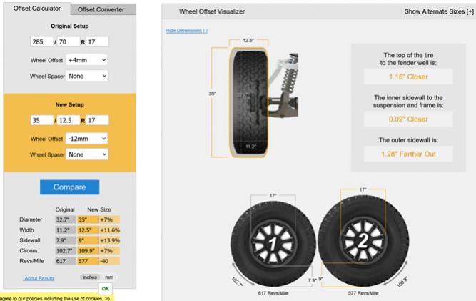

Comparison of 33" BFG KO2 on TRD wheels to 35" Cooper Disc. STT Pro
I did a ton of research and finally selected wheels & tires - moving from my current 33" BFG KO2 A/Ts on the 17x7 +4 offset TRD Pro wheels to 35" Cooper Discoverer STT Pro M/Ts on Black Rhino Primm 17x9 -12 offset wheel.
I chose the Primm because they're designed for Toyota and light weight at 29 lbs vs the TRD wheel at 25 lbs. Plus I think they look good in matte black with the rig’s mag gray color.
I chose the Cooper Disc. STT Pro because it's cheaper and 8.8 lbs lighter than other tires, like the KM3 and Toyo M/T but has overwhelmingly positive reviews and low road noise reported compared to other M/Ts.
All in, increasing weight by about 62 lbs across 5 wheels going from 33"s to 35"s. Not bad considering with other options, it could be much higher. Total weight will be 476 lbs for all 5 wheels/tires.
I used Wheel Offset Calculator to calculate and visualize the fitment difference.

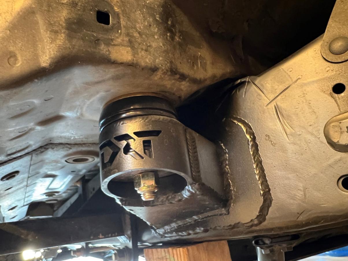

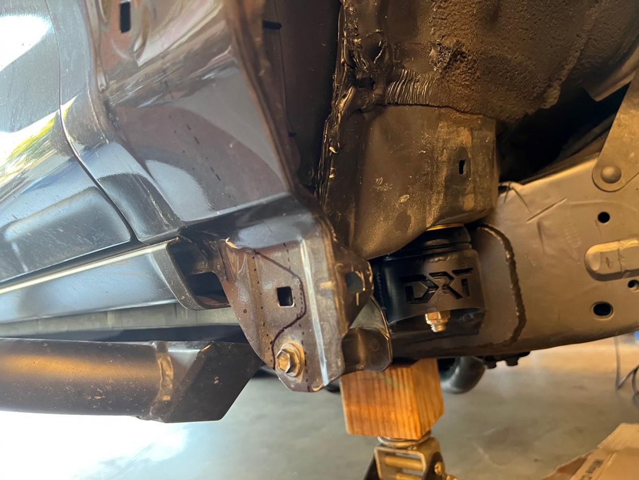

Update: cam mount relocation, regearing complete, cutting started
The folks at Shaffer's Offroad did a great job installing the DRT fab cab mount relocation kit and re-gearing to 4.88. the proper break-in is now completed and I will be changing gear fluid this week. The noise level of the rear diff was high upon pick up but slowly went away since. It's very faint now and I'm sure will decline further over time.
