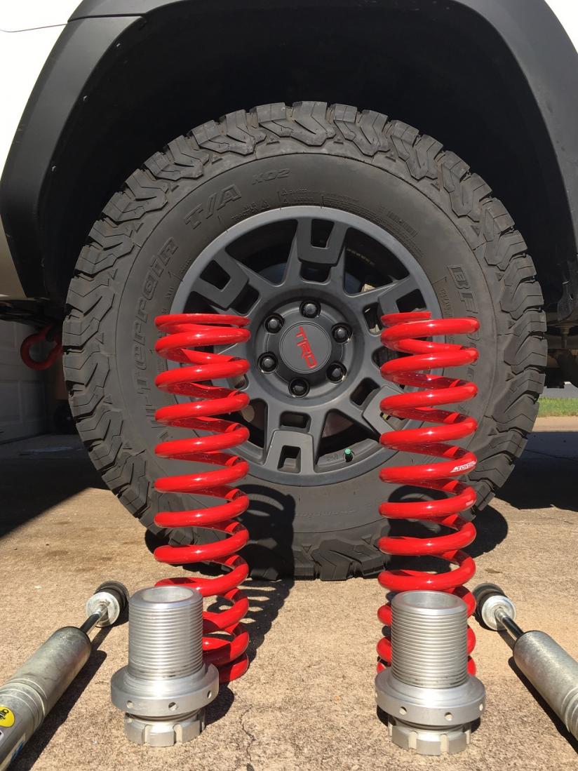

[MENTION=290929]YellowSnow[/MENTION] i'm selling the adjustable front toytec springs from the ultimate kit, fits the 5100 shocks. your front to rear stance looks fine as is, add 1" to the front might be too much. these collars would allow you to dial in a precise amount of lift. just a thought.

I just went 5100 all around and have the fronts at 1.75" with CF 1" rear spacers. Are the Toytec springs you pictured 3" in the front? How much are you asking shipped to 78748 (Austin)? How many miles on those springs?
