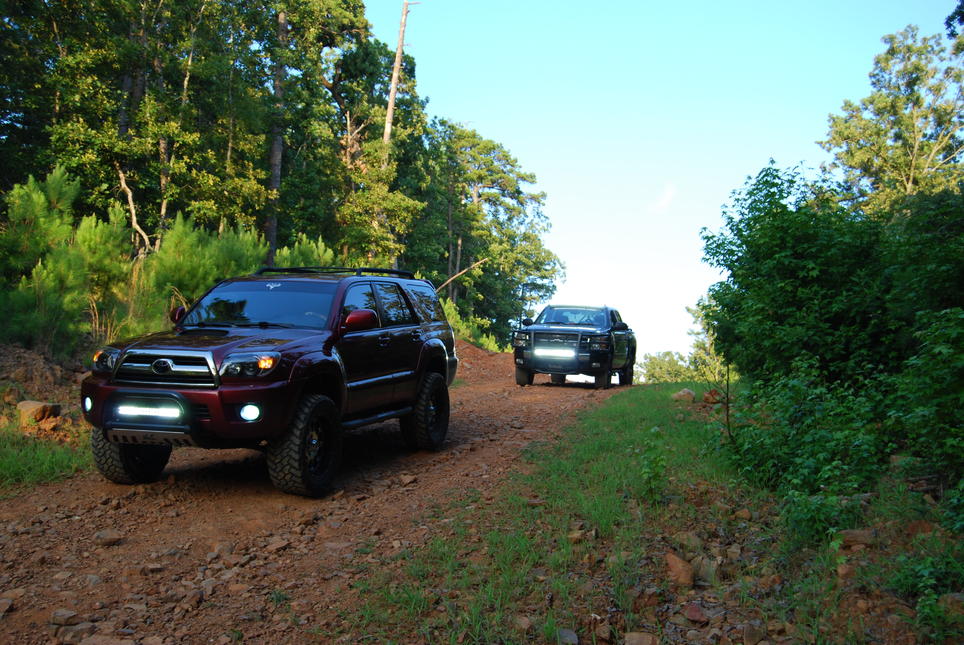

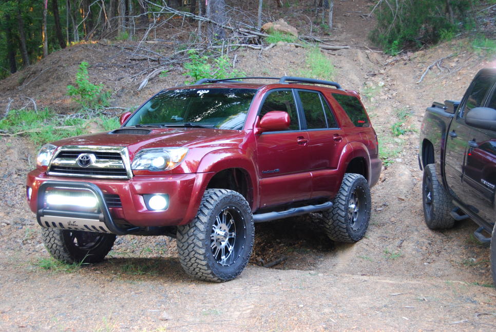

I've had 5100s with Toytec coils for over a year now without control arms. I'm going to replace them very soon though to get my alignment in check and to keep it from straying left and right on rough roads. It has done perfectly fine for a while but my ball joints on the UCAs are almost shot 20,000 miles later
