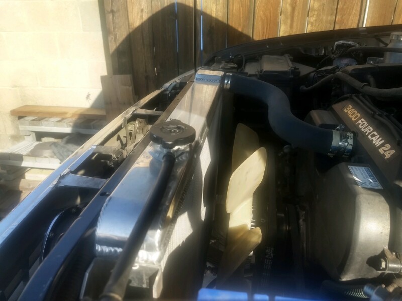

Yep, mine is not a crossflow, I'm betting its not that this it just a random pic. It cools well, been installed about 6 months, I bought the shorty for a 4 cyl, but it is 3 times the thickness of a factory one. meaning the core is full thickness of the tanks, 3 rows not one.

what is that on your upper hose ?

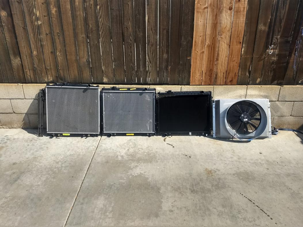

This truck has had so many variations to the radiator. Mine is a short 4cyl radiator because of my SAS and the front spring hangers, I can post up picks, also I have all three sizes.

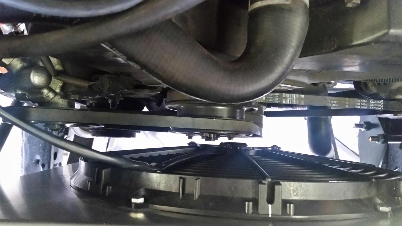

yes the factory shroud will fit, I just don't have one now, I need one, and the adapter in the hose is a temp switch to control an electric fan. the fan worked well, but with the shroud, fan and larger radiator, it would not clear the motor so I went to the mechanical fan.

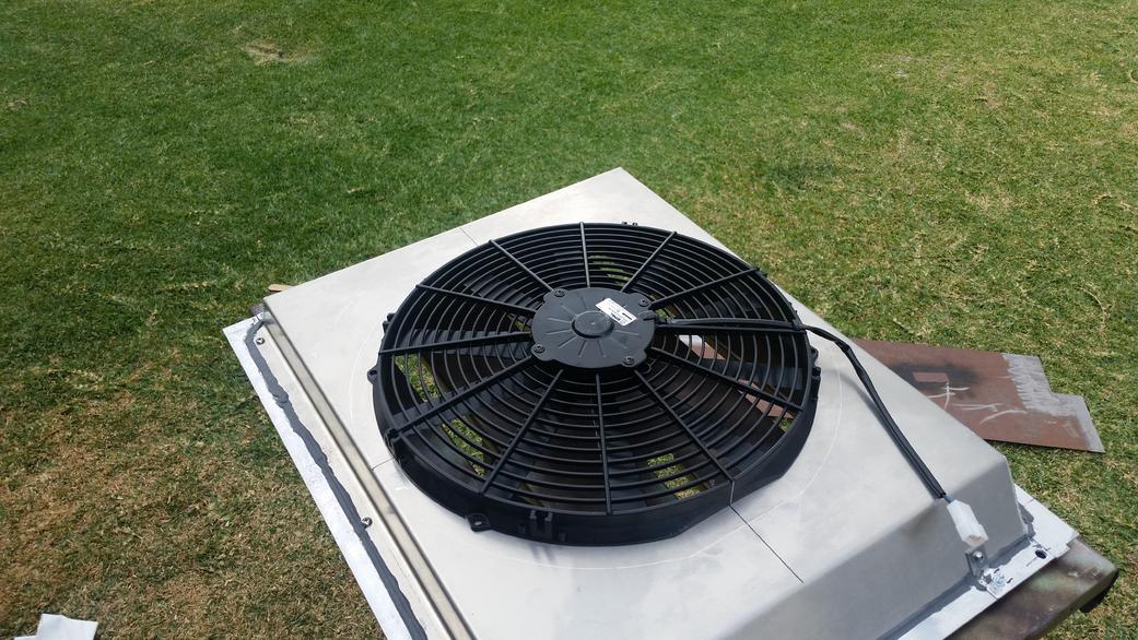

Does the rad in the last picture with the aluminum shroud and electric fan come from the same company?
Im in the process of SASing my truck and trying to het all the parts. The link you put up in the beginning is the shorty rad?
No, that's all custom, Built from catalog parts. the shroud was from Speedway Automotive, And the fan is the largest straight blade fan I could get to fit. Straight blades pull much more air, but are loud as hell.
I didn't want a flat plate with a hole cut in it. The shroud helps draw air across the whole radiator not just where the fan is.

somewhere I have the specs for all three radiator sizes that came in these trucks.
The idea was I went to a smaller radiator so I wanted max air across the radiator at low crawling speeds to cool at idle, but the single core small radiator couldn't dissipate the heat under load.

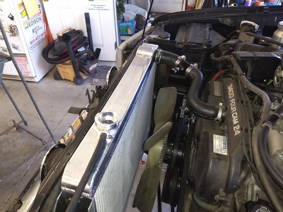

If you want a shorty radiator that does not hang below the frame you need one with an 18.8 tall core.
I think the stock core for a V6 is 23.6 and hangs below the frame pretty good.
https://www.championradiators.com/Toyota-Tacoma-Radiator-1995-2004

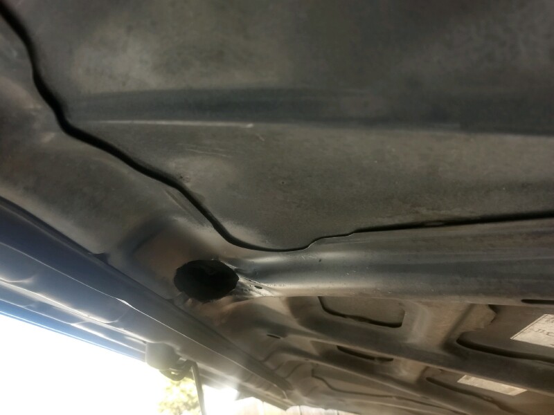

and the cap hits the hood, I trimmed my hood support to clear it, some here may not like or want to do that.

That looks a lot like the SPAL 16" fan I have, is that also what you have? Mine is a curved blade design though.
That's exactly what it is, the straight blade had a higher CFM#

So out of the 3 radiators your now using the 18” with the factory shroud? Is that the radiator link u posted above in my post?
Radiators
No that link was for the direct replacement. The one I used was a 4cyl Taco.
It's not a direct fit, the cap touches the hood. It will bolt in place with the factory hardware but the bottom of the shroud will need to be cut to clear your SAS. if your not good with cutting the hood Either do your own research and see if there is one that fits without cutting or move forward at your own risk.
