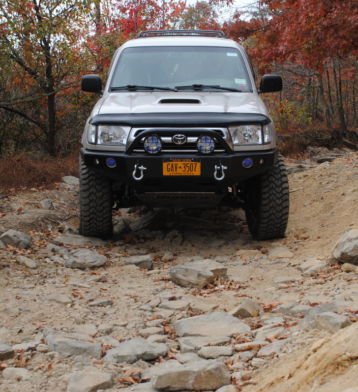

There are other after market bumpers that can accommodate a 1" body lift so there's no unsightly gap & the bumpers are less bulky looking too. Addicted Offroad, 4X Innovations, CBI, Shrockworks.
This is how mine fits with a 1"body lift.

Im gtting rid of my ARB bumper. The approach angle sucks and if you actually wheel hard, it will flex into the body. I have body damage on both sides from it.

you can modify an ARB to fit a body lift pretty easily. Check out J-money's build

You can slot the mounting holes on the ARB bumper to move it up to accommodate for a 1". But thats all there is. I used a torch to make the slots longer.
