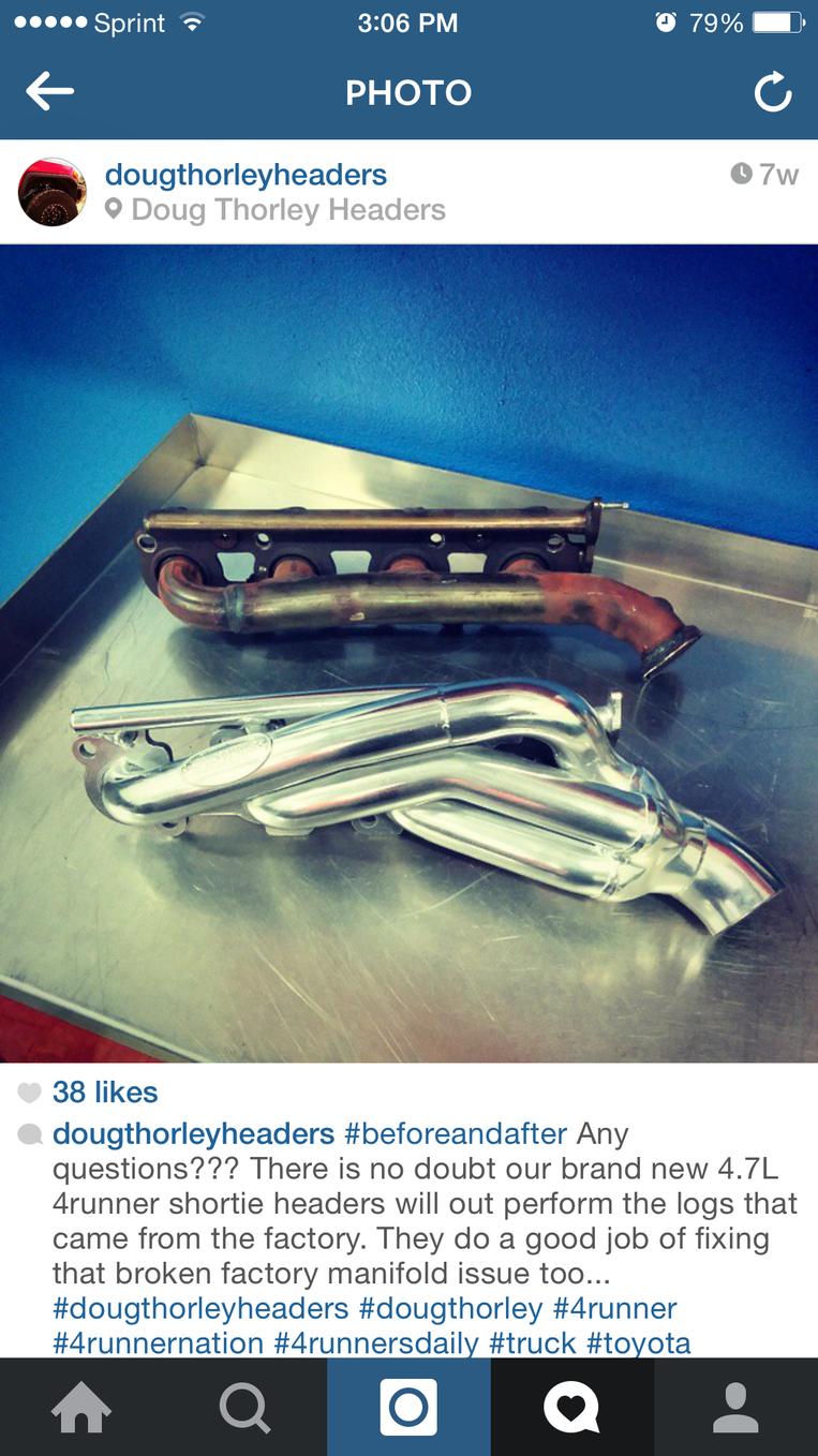

To be honest, cracked manifold is quite rare but they do happen. i had 150,000 miles on my headers before replacing them with Doug Thorley performance headers.
When i had them replaced, they were actually perfectly fine and never had any issues, just poor quality compared to Doug Thorley's. Here is a picture of OEM vs aftermarket.
