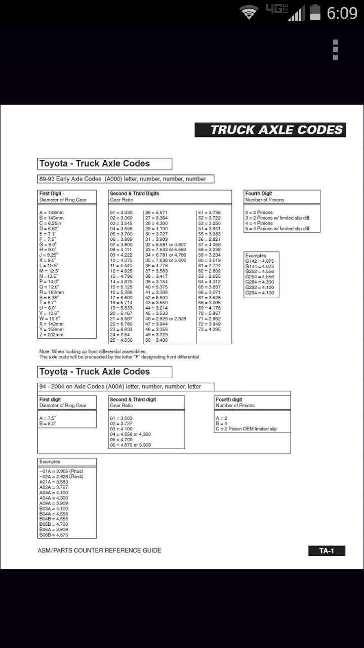

Will gears out of a 2003 Tundra axle code A03B work in a 3rd gen axle code A03A? They are the same size and ratio but the Tundra has 4 pinions? I wasn't sure what that meant.
