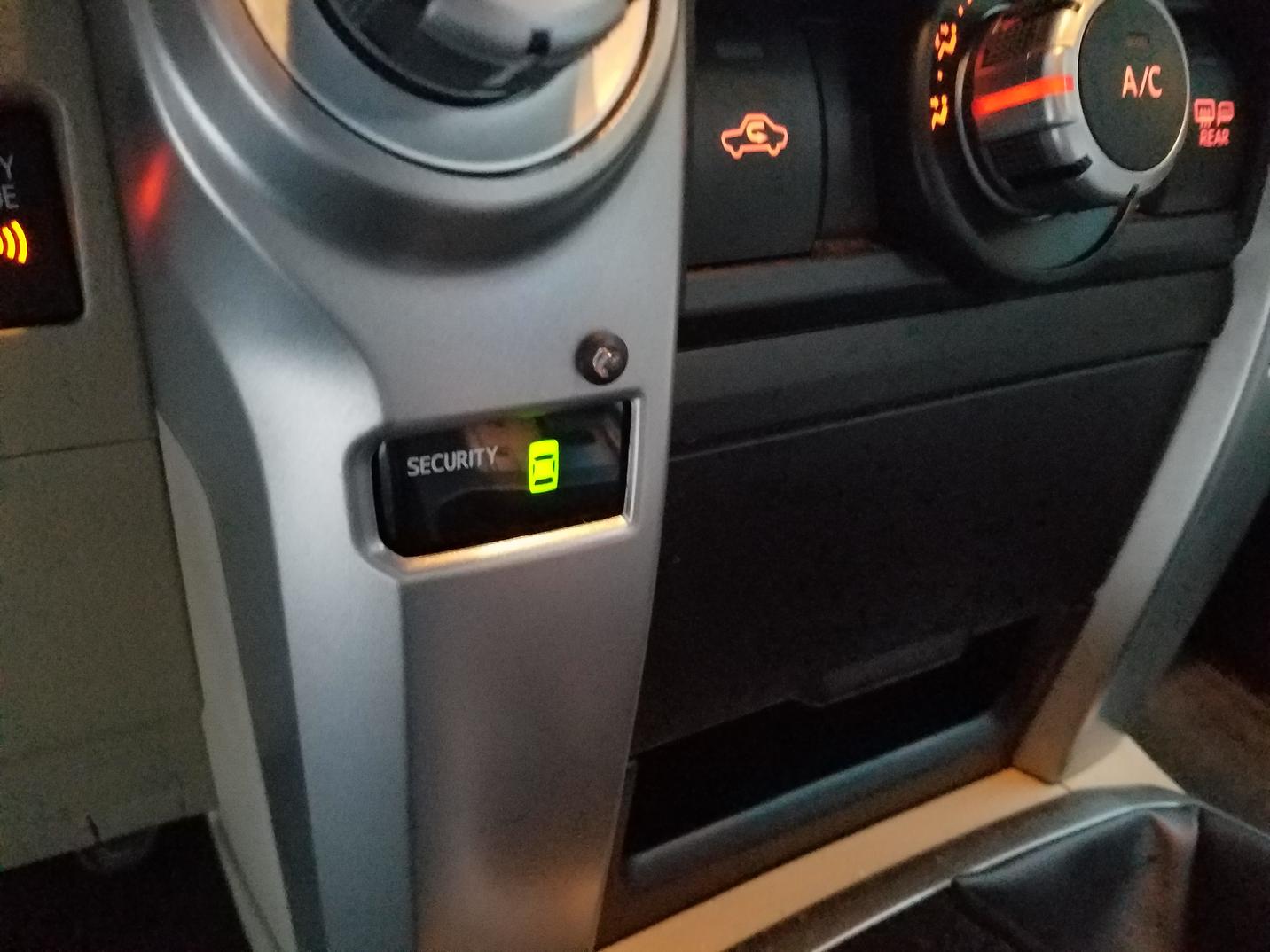

On the up side, I found this thread from [MENTION=93434]gshadow325[/MENTION] who was able to help me out with the system I wanted. He had it flashed and prepped for me, so the wiring loom was already started and done very well. He had documentation to help me with the wiring.. I did find some of the notes a bit confusing and all over the place, but I didn't expect him to have step by step install manuals.
I was able to install the system over a weekend and now have the great system I wanted.
And most importantly, I have remote start that doesn't shut off when I open the door!!!

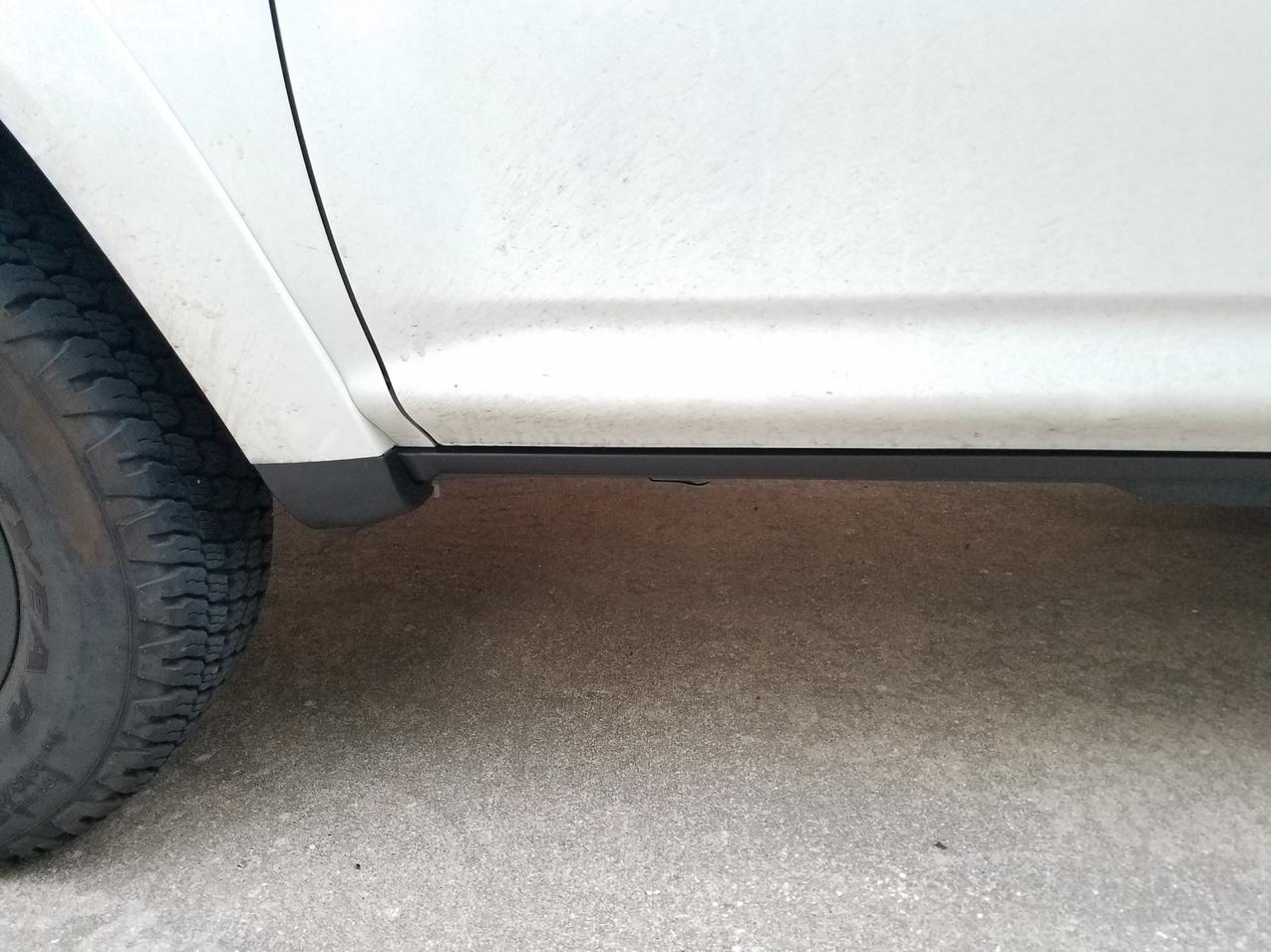

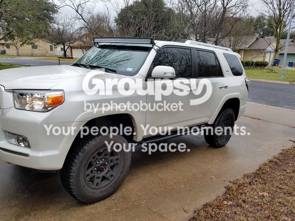

TE Rockers
I laid out the extensive funds to swap the rockers over to TE ones in prep for future rock sliders upgrade. I did not opt for the Mud flap addition. I am very fond of the new look. It really lessens the soccer mom look. Makes it feel taller and gives an additional 4-6 inches of rocker clearance from the huge SR5 rockers with faux chrome...

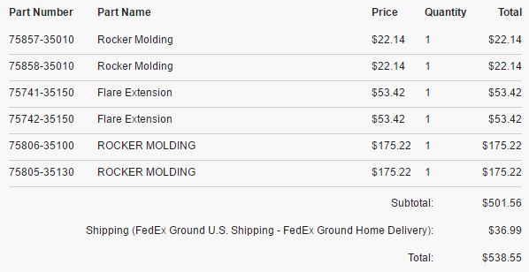

If you don't mind sharing, what did it end up costing you to make the swap. I'm considering doing this. I took my rockers off a year ago and do not plan to put them back on until I sale. It looks okay, but I have considered these to give a little more of a finished and clean look. Thanks!
Your truck looks great, but I may be a little biased. :)

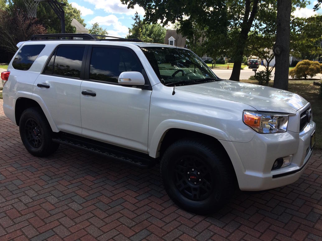

Here's what it would look like with a Trail roof rack and door handles:
I got the two TE rockers, the flare ends and the rear door flares and paid $538.55 shipped from toyotaonlineparts.com
You could leave off the rear door fender flares if you are ok with the look of the original ones. The are thicker in depth to the door. The swap is super easy.
There is a heap of info on this from other members like [MENTION=55815]Okki[/MENTION] Here, [MENTION=97134]IronManKansas[/MENTION] here, and a pretty awesome list of parts from [MENTION=8206]harper7[/MENTION] here..
Here is a screeny of my bill..

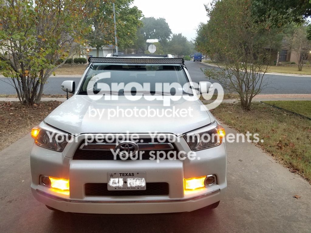

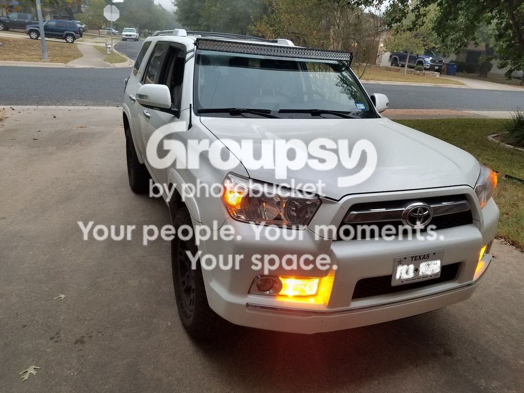

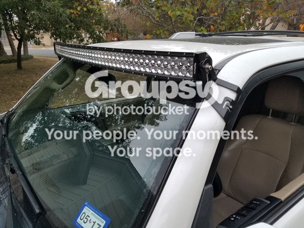

Curved 52" LED bar
Was able to get the new light bar mounted this weekend.
Used the Rago brackets. I think they are a bit too pricey for what they are, but I sure can't fault their customer service. Mama Rago emailed me status updates several times during the process, they put some candy in the box for my kid, and hand wrote a note on the box wishing me well and asking me to post pics.
I went with a cheapy bar from Amazon. I am an electronics guy, so I figure I can try and rebuild it if there are issues. I went with the Ridgidhorse one because it showed a measurement without brackets, claimed it had better more waterproof breather, had the '3d' dome optics on the LED's, and said it had OSRAM LED's instead of falsely claiming CREE like alot of the other cheap ones.
So far I am ok with the build quality. I can see some manufacturing nastiness deep between the cooling fins on the back, but it will be unnoticeable by others and should not impact function.
I still need to secure the wire in the side channel on the windshield, finish building my wiring, and wait for the fuse/relay/breaker mounting bracket from Shrockworks (Look for write up on my experience with SR later)..
I will try and get some lit pictures later..

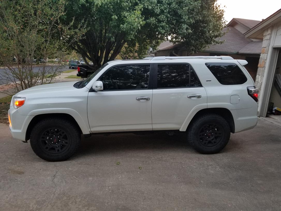

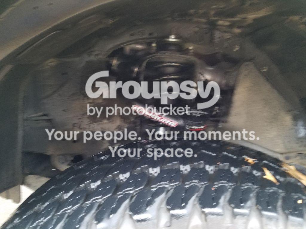

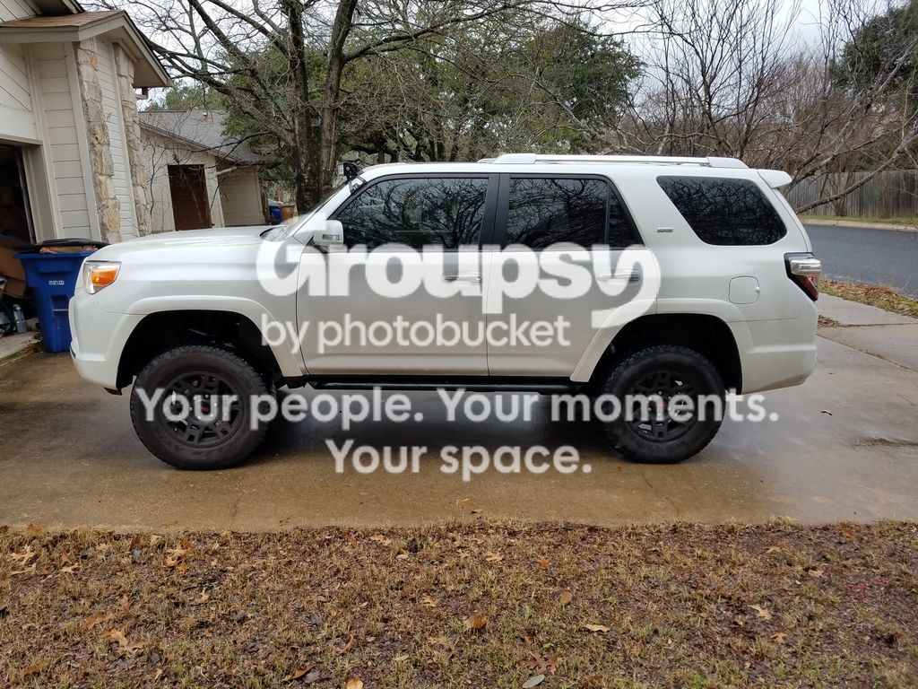

Lifted finally!!
Ok, I carried the suspension components around for almost 5 months until my buddy was ready to help me install everything. The nice part is he has access to a 2 post lift and hardly charged me anything to do it.
Here is the kit as installed:
Bilstein 5100's on second notch (Would'nt go any higher using OME's)
OME 2885 in front
OME 2889 in back
Camburg UCA's with Moog BJs
With a lift it only took 3.5 hours.
I was lazy and forgot to take before measurements, Sorry...
I have taken after measurements and will add them here when I find the paper I wrote them down on. The front is just under half an inch higher as I am sure you will notice. This should even out when the new front bumper and wich are installed. I have already placed the order for a 4x4 Labs early 5th gen bumper with headlight tubes.
In an attempt to make this post worthwhile, here are the pics!
