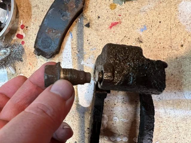

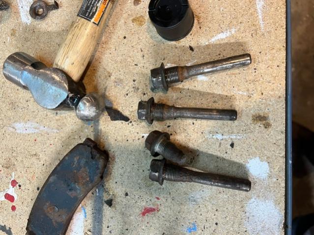

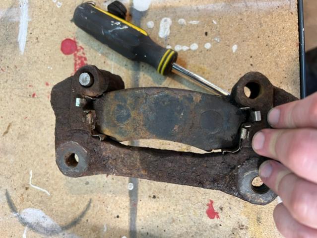

This one rotor pin bolt was super stuck, wouldn't break loose with an impact with an impact swivel so I decided to go old school with a breaker bar. The breaker bar, with a cheater bar broke it loose, unfortunately it sheared the pin off in the caliper bracket. I've tried quite a bit of PB blaster, attempted to beat it out from the other side with a punch that ended up bending, and I attempted to drill it out, but gave up on that too. All of the pin boots were also completely trashed. I've had the caliper bracket cranked in a vice multiple times while trying to beat the pin out. Is my best bet just to order new caliper brackets, pins, and pin boots/bushings for both sides? I'm pretty new to this DIY thing, so can you check what I think I need?

Replace... for the $50-60 for a caliper (what I've been paying at NAPA for their lifetime remans as I've been re-doing my brakes, I believe), it's just easier and more cost effective to swap the whole thing. I don't think there are different variations for the rear on a 4th gen (unlike the front).
The best way to get that out is by welding a nut onto what's left. Otherwise get a new caliper. Make sure you get all the parts you need as there may be variations as to what it comes with.

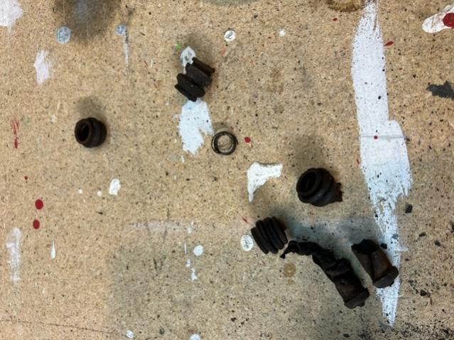

When I was previously taking everything apart, I found it odd, but didn't think much of it, that one pin loosened, but didn't zip out of the caliper. I ended up having to pry it gently with a screwdriver as I backed it out with the impact. I also noticed what I perceived at the time as really small and spread out "springs" came out at the same time. I thought maybe there were springs embedded in the rubber bracket hardware that were so trashed they just came out of the rubber.

Another trick I have had to use when in a pinch and cant get a new caliper bracket is take and drill a small hole on the back side of the bracket where the pin is. After doing that you use the little hose from the can of penetrant and spray into the hole. Let it soak for a bit and then take a torch of some kind and heat it up. Insert a small punch and knock it right out. Clean it all up good with brake cleaner. AFTER you have installed and completed the brake job then take any type of good sealant and put a dab of it over the hole you drilled. The rear I say after you are done is because when you insert the new pin into the bracket you will have some air pressure that has to escape from pushing the lubed pin in the bracket. It will blow your sealant out. Also, depending on which pin it is you will see a rubber plug that you can remove instead of drilling.
