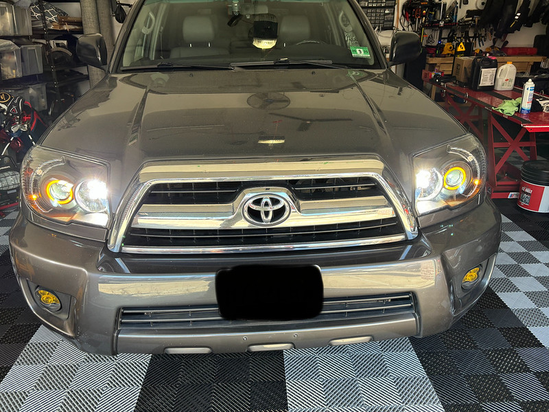

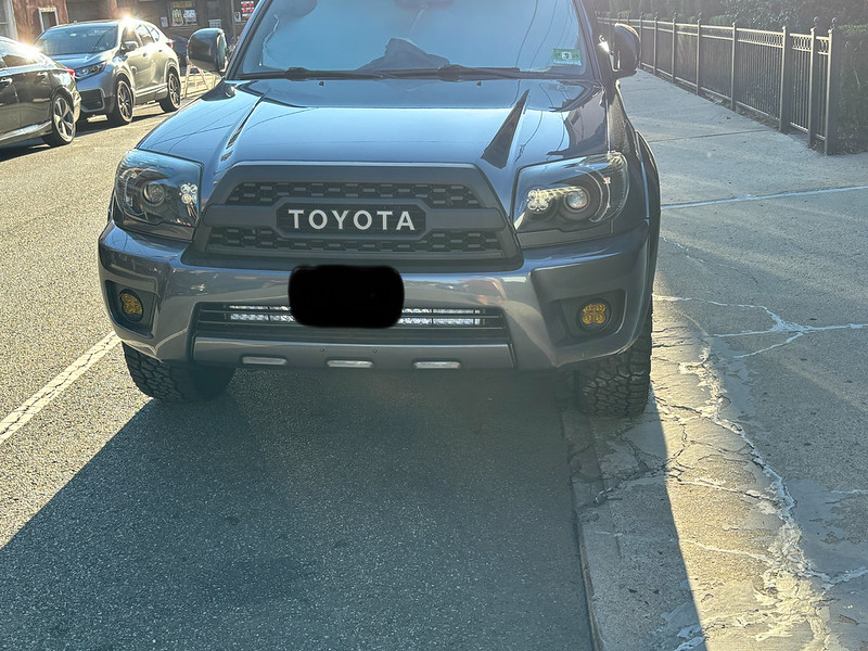

Just looked up their website and wow those look really nice, especially the ones with the pod lights for high beams. Do you have a picture of yours installed?
Not the best pics, lights are pretty easy to install and wire. Halos come on with ignition, flash on indicators and turn off on low and high beams. They come with direct plugs for low and high beams so no splicing on those you just need to splice into the running lights for the Halos.
