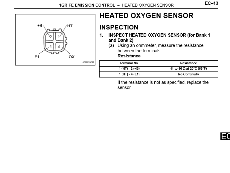

I found this FSM test for the sensor.
Did the test on the post cat O2 sensors, they both read 13.6 and 13.7ohm respectively. So i guess they are good.
So either my CAT is dying for real, or i got a leak in the exhaust.
Inspected the whole length post CAT, didnt see any cracks, may have to rustle up a smoke test kit to rule out exhaust leaks
