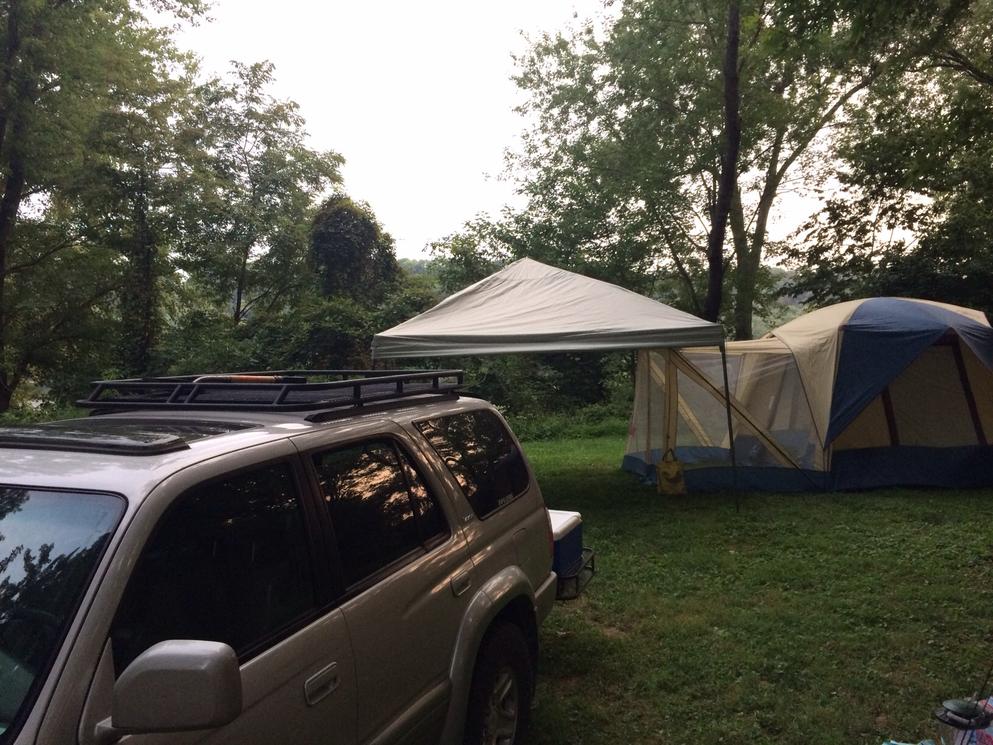

I received mine last Wednesday. I primed and painted it at work on Wed/Thurs.
I then installed it, filled it up, and took it camping from Fri-Sun. Got the tent, canopy, six folding chairs and table, and a shovel strapped to the top with a nice section up front still unused.
I have the stuff ordered to mount a shovel and axe to the rack. I even got something to mount the hi-lift jack for when I take it out of the Tacoma-though I don't need it yet for the T4R (no lift yet).

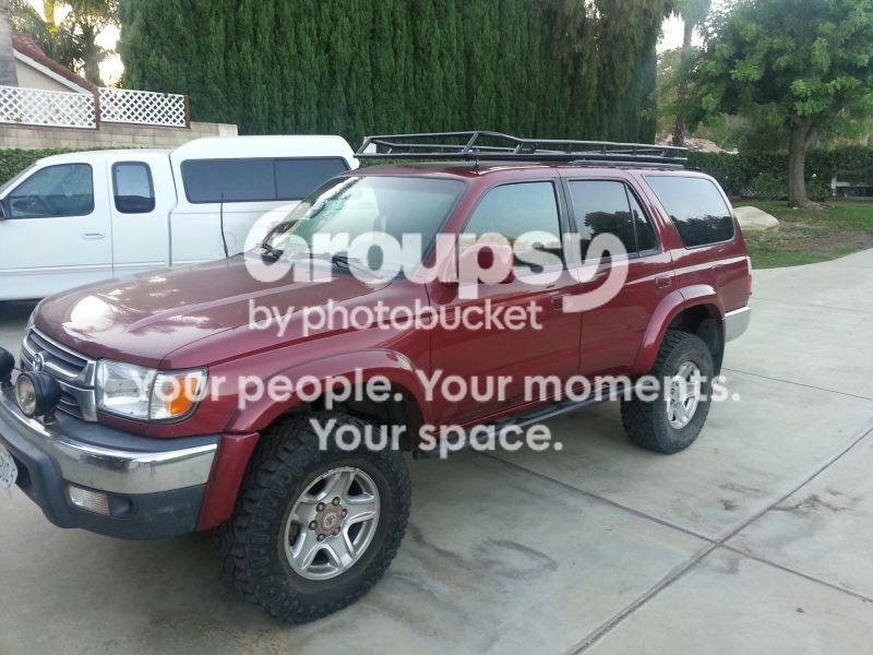

Looks good, did the fairing just fits right on ? I should be getting my rack this THURSDAY :)!!!!! Going to raptor line it... Like.bed liner.
I believe the rack is $275, unless the price has changed.
Yeah, it pretty much just fitted right on. Kinda hard to screw down but it worked.
Yeah, I just used rustoleum self etching primer and rustoleum truck bed liner. I recommend those products but I'm sure raptor line will work just as well.
