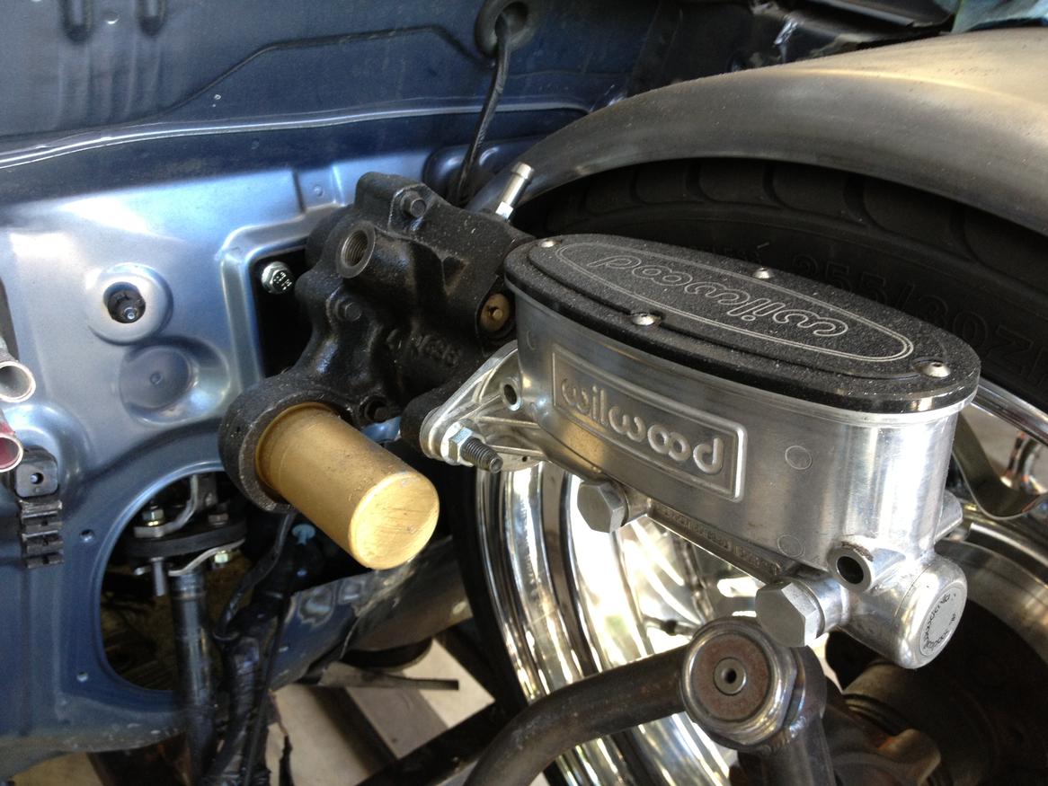

You may be able to go the route i did for brakes instead if you do decide to make it a trail truck. Run a power steering assisted hydroboost. I less than 300 for a reman'd hydroboost from www.custompowerbrake.com ....i sent him all the measurements and he made an adapter plate that fit like a glove and hooked up to the factory brake rod with no modification. now that price does not include the master cylinder itself but you can do that a lot cheaper than i did by going with a less expensive GM OEM unit. He also knows where to get the metric adapter to run the stock brake lines. My only issue is i sold my master cylinder and need a way to bypass the ECU that is on the master cylinder which maybe blackworksinc knows how to do by tracing wires. If i can get it working right it wold make a pretty awesome brake mod for trail trucks. I just wish i had one of the ECUs so i could lug it in and confirm that is the issue. Its the only item not plugged back in after my teardown.

You may be able to go the route i did for brakes instead if you do decide to make it a trail truck. Run a power steering assisted hydroboost. I less than 300 for a reman'd hydroboost from Custom Power Brake - Hydraulic brake booster conversions for your brakes! ....i sent him all the measurements and he made an adapter plate that fit like a glove and hooked up to the factory brake rod with no modification. now that price does not include the master cylinder itself but you can do that a lot cheaper than i did by going with a less expensive GM OEM unit. He also knows where to get the metric adapter to run the stock brake lines. My only issue is i sold my master cylinder and need a way to bypass the ECU that is on the master cylinder which maybe blackworksinc knows how to do by tracing wires. If i can get it working right it wold make a pretty awesome brake mod for trail trucks. I just wish i had one of the ECUs so i could lug it in and confirm that is the issue. Its the only item not plugged back in after my teardown.
