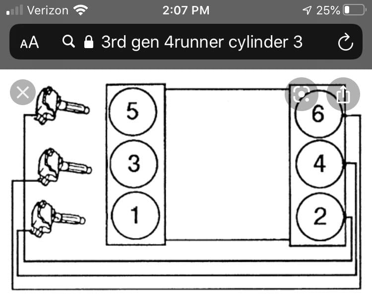

P0303... cylinder 3? Start there by checking coil/boot/plug. If your not smelling a fuel rich exhaust, could be an air/fuel/vacuum/injector issue rather than electrical
If your not misfiring on cylinder 4 as well, it’s more likely the boot or plug at cylinder 3... does that make sense?
Missfire detection is poor on our rigs. I had a bad coil on the 97 Puppy Hauler and she drove it 20 miles home from Reading PA with it shaking at intersections and having that off exhaust tone from dropped cylinders.
It was a bad coil and driving it from my house to my garage where I worked on my stuff it only shown a missfire code turning into the driveway 2 miles down the road.
You will melt your cat if you don’t solve this soon.
I’d buy a new coil and a new wire set that includes the coil boots and install the complete wire set and the coil for the cylinder that fires number 3 cylinder. It’s where I’d start.
