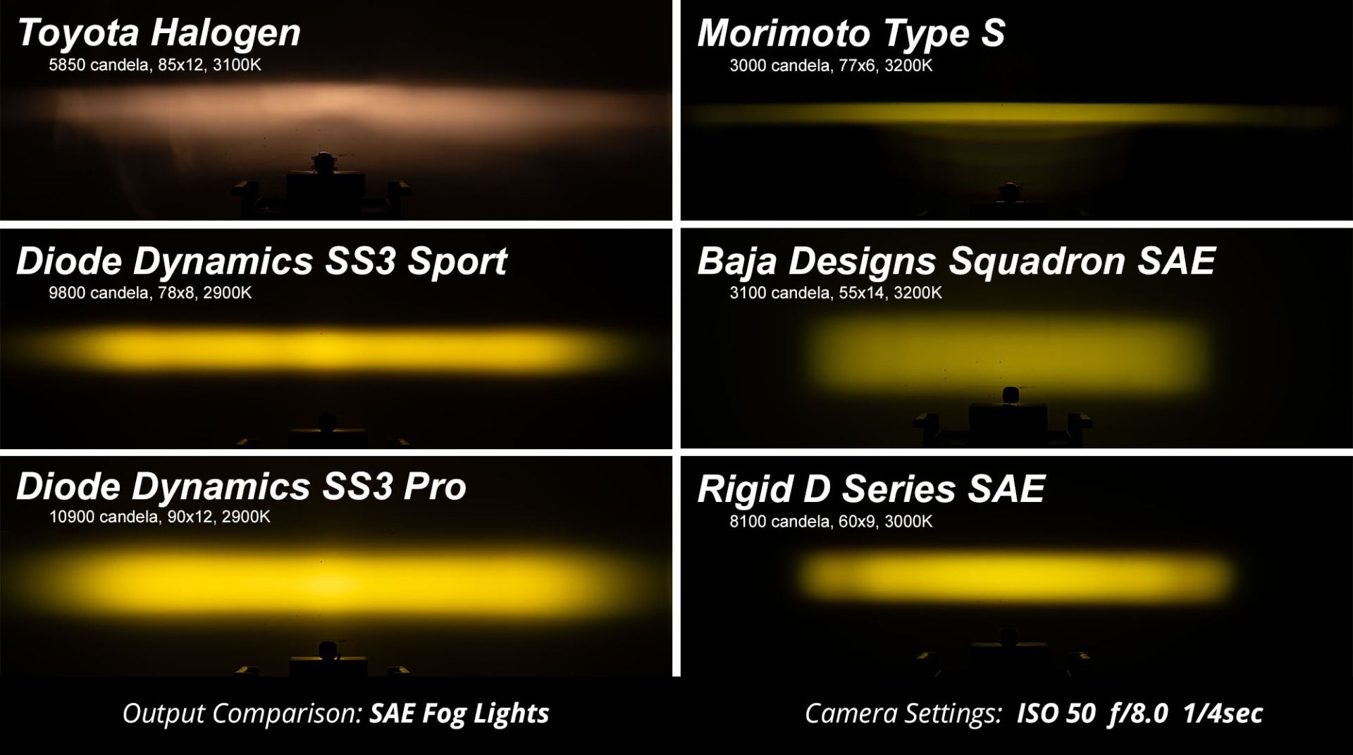

They suck. Get the Diode Dynamics SS3 SAE Fogs. I ripped out both those BDs that you mentioned
This.
The BDs are not even vaguely competitive with the DD fogs. They took a non-street-legal fog and put a crude rectangular frame in front of it to make it SAE compliant. Which results in wasting a lot of the light as well as a diffuse beam pattern.
The DD on the other hand are optically designed to be SAE compliant, so the cutoff is way better and the light is a lot brighter. Better beam pattern and brighter light. Depending on the model you choose, I think they can be cheaper too.
They sell a 4Runner-specific kit too.
If you do some searches you will find people here swear by DD if you plan to use them on the street.
definitely get the diode dynamics ss3. i have baja for somethings, but not for sae.
i run a total of 7 pairs of ss3 pro between my 2 trucks.
