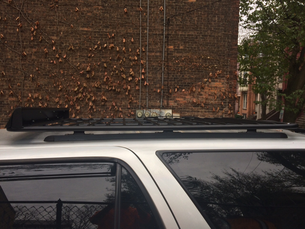

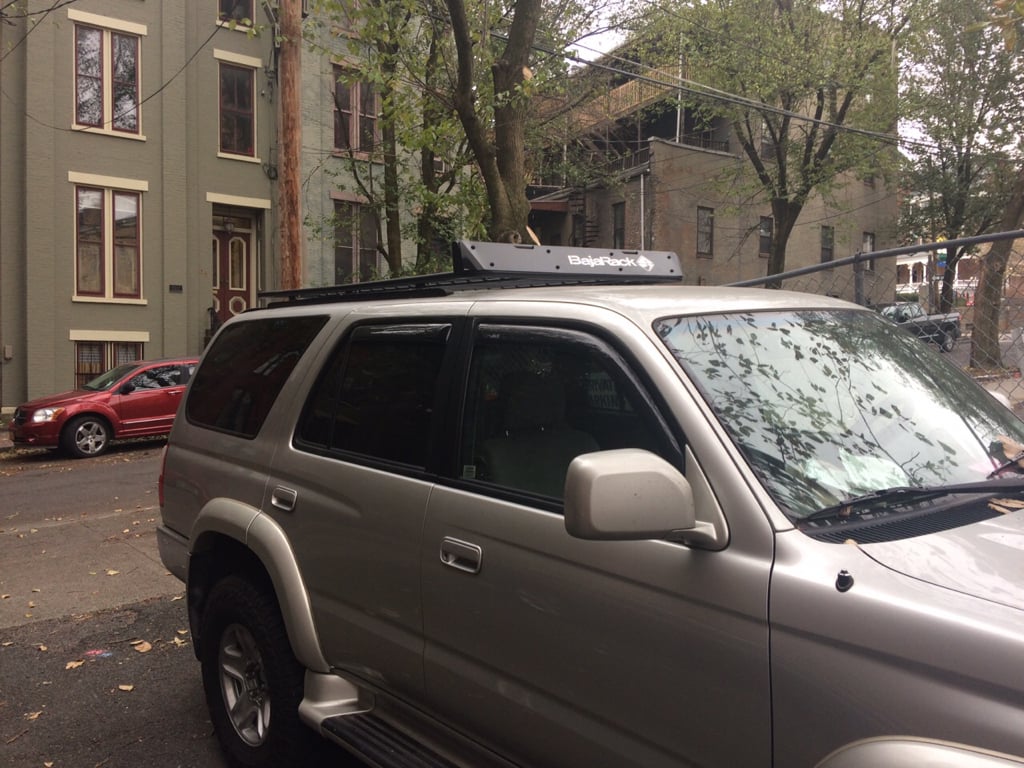

10 weeks ago I ordered the BajaRack Utility Rack from Ok4wd because of their free shipping.
It arrived at the shipping depot this Thursday. It was well packaged with no damage.
I installed it today in about an hour.
Positives:
Light weight. Only 38lbs
Hardware is stainless
Low-profile
Strong- I can shake the vehicle w/ it. I can stand on it also
Negatives:
Made in Mexico
Powdercoat quality is questionable
One of the brackets wasn't drilled properly and I had to enlarge the hole.
I have only seen one other 3rd gen with this rack that wasn't a BajaRack display truck.
I plan on mounting 4 PIAA LP550s, hi-lift, awning, and my lightweight camping items up there.

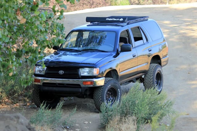

I had one, super easy to mount. I then sold it and went full length with a Frontrunner Outfitters.
It stayed probably four months on top of my rig, didn't have any issue, but I was in CA so the weather wasn't harsh!

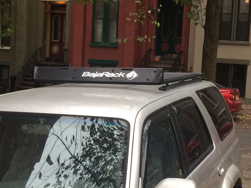

Looks sharp!
Looks good, I've never seen one mounted before!
Thanks, I see people with the standard and full length 5" height racks all the time. This is the only other flat rack I've seen that wasn't a demo/display truck for BajaRack

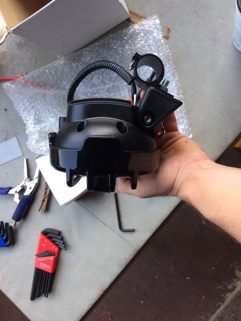

Crappy night picture, but I mounted my Power GS Clamp Mounts and PIAA LP550s. I still have to do the wiring in the cold unfortunately.
