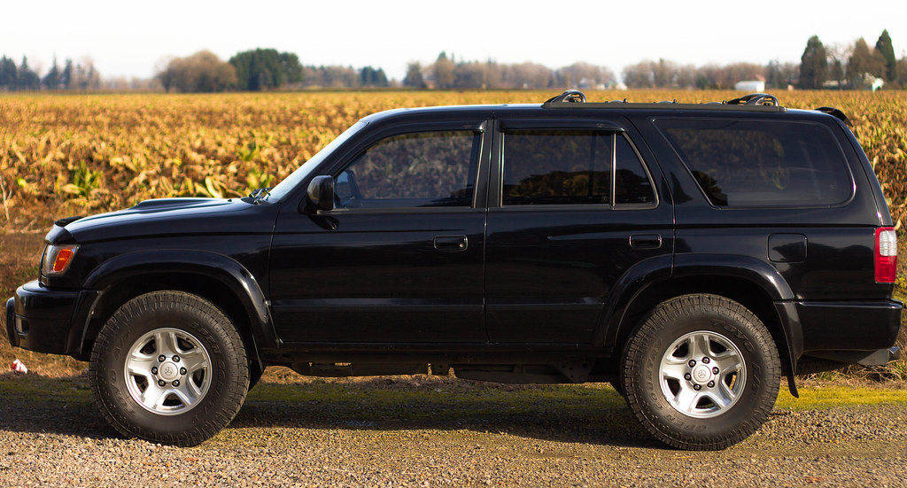

Relatively flat ground:
'00 Toyota 4Runner Highlander. by Bucky Images, on Flickr

Thanks Hepar. I just want about .5"-1" in the rear, to offset when it loaded down for trips to the Lake, as well as convenience when loaded with gear when off-road. I don't mind the ride the stock suspension is giving me right now, quite smooth actually, but just want the rear to sit a tad bit higher.
