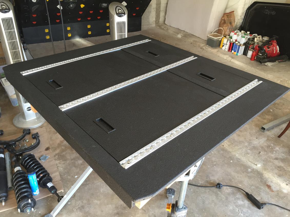

I have a TE which came with nothing and in this configuration there is an drop of about 3 inches from the folded rear seats to the carpeted floor. There is an angled piece that helps with the transition but when sleeping back there it's uncomfortable and when loading gear its a pain.
I removed the foam, sound insulation and carpet back there and that makes the drop about 4-5 inches.
The rear seats are at a slight angle and with my load floor installed it's flat at the same angle across the folded seats and all the way to the rear. The pictures don't show that very well. When I'm done I'll take better pictures with a better camera and show it in more detail.
My design also salvages most of the space under the load floor with 4 opening doors for storage.
The doors and the load floor are all different levels because when it gets linex applied, in some areas there will be multiple layers of linex and in others only one. Once it's applied he doors, l-track, and load floor will all be flush.
The hardware consists of the stainless 3/8 inch bolts that run through the unibody frame, l-track, some hidden lift off hinges and some recessed handles.
I'll post links to the sources for the hardware on the original post in a few days once it's finished up and I'm sure it all works.

I chose to drill through the floor. There were a few existing bolts but they were small and not ideally placed. Given that I could potentially be using the tie downs for a significant amount of weight I chose to go through the floor with 3/8 inch stainless hardware. On the outside bolts I went through the reinforced unibody frame channels that are a few layers of sheet metal and used large inch and a half washers to distribute the load.
I sprayed the holes with self priming automotive paint to inhibit rust. Should be ok.

There is a unibody reinforced frame element that runs left to right under the carpet. There are a couple more that run from to back that are under the cargo area under the truck. They make the sheet metal pretty rigid.
There is foam and carpet normally installed over all of it but I removed the filler styrofoam to add mores space to the storage pockets.

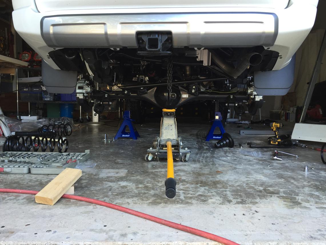

After work I installed the Toytec Boss 3 inch lift front and rear as well as the Light Racing UCA. Had a few trials and tribulations but in the end I'm really pleased with how it came together. Decided not to install the radiator support spacer because it looked like such a kludge. Instead I ground down the radiator support and then sprayed it with black machine paint. Much better.
Have an alignment scheduled for thursday but my eyeball alignment drives great and tracks strait, so it seems like I may be pretty close.
Also had my 255/80/17 Cooper ST MAXX pizza cutters mounted on my stock TE wheels and balanced. This was a bit of a soap opera with the local NTB, but I'm too tired to write it all down.
Finally I finished all the prep on the rear deck for going to the Line-x Guy tomorrow. So if all goes well the rear cargo compartment will be good to go for the weekend.
I didn't take many pics of the install since I was a one man band.
Here is one just so this thread isn't worthless without pics....
