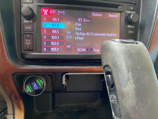

Engine running and nothing else on you should read anywhere from 13.5 to 14v at the battery posts.
Get a cig lighter volt meter.
If your battery is in good order then you should be seeing 14.2 to 14.4 volts at start up. Anything less than 13.4 volts under load at idle(AC, Defrost), fully warmed up, is a problem.
Battery volts can vary depending on the brands. When the cars on the volts will always be 13v+ but when its off it depends on the battery. My autozone agm is 12.6 when fully topped off while an optima will be over 13v when full.
The cig plug volt meter is just a small device you can plug into the cig plug and it shows your voltage. To get exact voltage read from the battery. The tiny wires going to the cig plug will drop the voltage down slightly
I never heard of a cigarette lighter volt meter. How does it work ?
