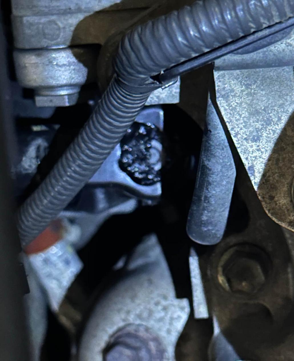

The black plastic cover that goes over a bolt on the alternator appears to be melted. Any thoughts on what might cause this? I attached a pic.

The plot thickens…
The black plastic cover that goes over a bolt on the alternator appears to be melted. Any thoughts on what might cause this?...
As one of possibilities: bad connection under that plastic cover (bolt not tight?), bad connection is going to get hot when current flows through it consequently melting that plastic.
And if I am correct and that connection is bad then it also would explain your voltage reading.
This was it, thankfully. The nut apparently broke when I tightened it before and I didn’t notice, so it had a bad connection and must have been arcing, thus melting the plastic cover.
I cleaned everything up with electronic cleaner and put on a different nut. I cleaned up the battery cables for good measure.

How important is that black cover? Do I need to get a new one? Is it safe to drive without it?
I was thinking of just hitting it with some dielectric grease to insulate it.
You can drive without it. It is there to keep shorts from happening, such as if you close the hood too forcefully.
You can drive without it, but IMHO I would recommend getting a replacement or finding another way to cover it with insulator\plastic cover at some point in the future.
That bolt is connected directly (no fuse or fusible link) to the positive side of the battery, if any grounded conductor touches it (like part of the car in accident\ any metal tool \wrench when you are working on the truck) then more than likely that metal will be instantly welded to that bolt\wire… consequently the process of melting of the wire and your battery will began… and it can lead to fire.
If it was arcing and melted plastic with a bad bolt, it will arc to metal that gets too close... best to not leave it exposed.
