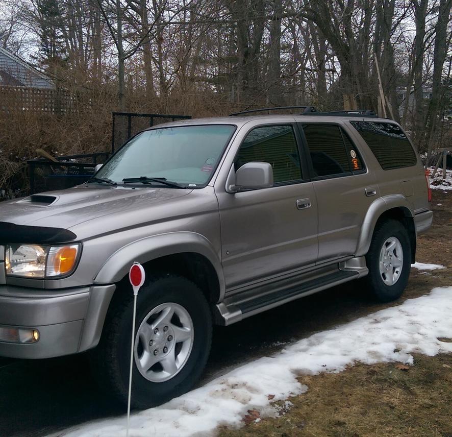

2002 T4R Sport Thundercloud 188,000 owned since new. My second 4R. First was a leased 99 sport for work. Lives in Northern New England with severe winter weather, mountains, ocean, snow, virgin construction sites. Up here 4R take a beating from salt. It was walnut blasted and re-undercoated after 9 years , always washed after every storm, has been serviced by the book or better, new shocks and springs at 170K, $1500; a new mother board controller $500, and at about 170,000 miles vehicle paid the New England salt price in many small and bigger ways. Rust replacements: Steering rack, front sway bar, a shock mount replacement, several frame welds, rear diff cover replacement [Barnes 4WD] , numerous metal underneath pieces, yearly under coating redo, and then the electrical corrosion. The combination of salt air and salt roads plays games with the complex electrics on the vehicle. After the extended 100,000 mile warranty expired I've put about $1000 into corroded or failed electrical parts plus the time to figure them out. Right now the only issue remaining is a sometimes battery warning light that comes and goes.
Having said the above I will tell you this T4R has never left me stranded in any place , any weather, regardless of what was going on with it's idiot light xmas tree. It pulls a 2900GVW trailer weekly, and at 184,000 mi hauled a fully loaded trailer over the mountains to Montreal and back with no issues. It burns no oil, gets 17 to 22 mpg, runs all day at 70 mph on the turnpike or crawls through mud, snow ice [4 studded snows in winter] with the most flexible AWD/4WD and center locking diff system available. It goes anywhere, effortlessly. Not the cheapest to own or run , but the Best vehicle I have ever owned.
I will drive it until one of us dies. Its license plate says it all:
'NVAGVUP'
