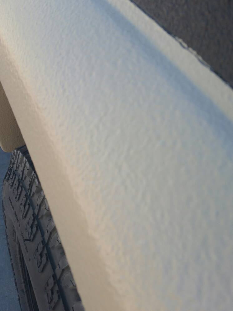

Over a year out in the socal desert on the monstaliner.....no fading at all.

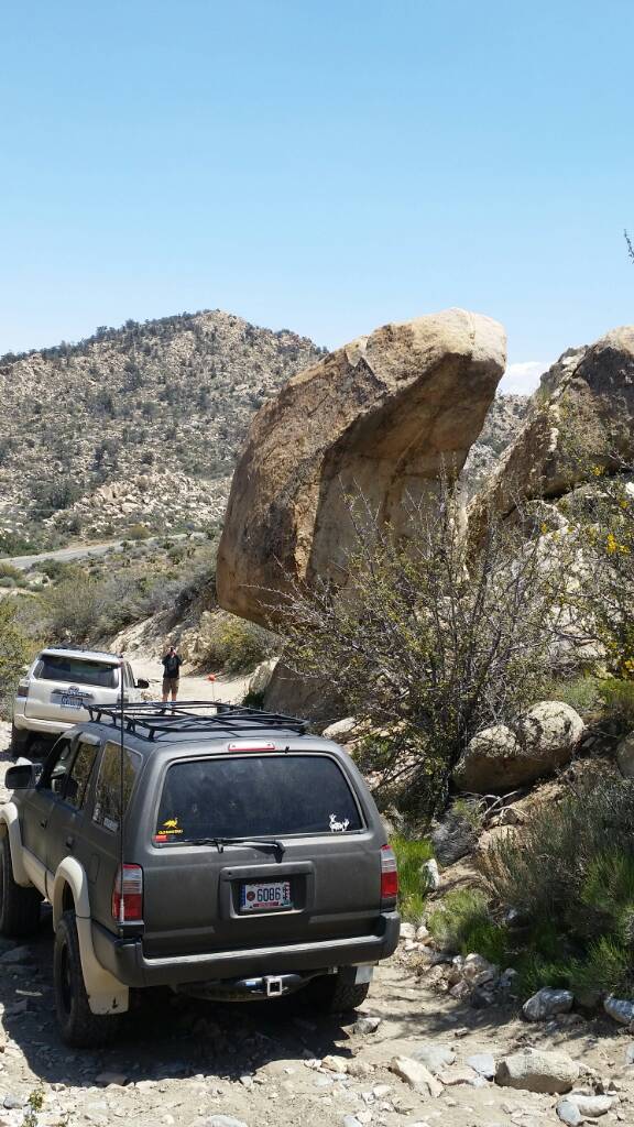

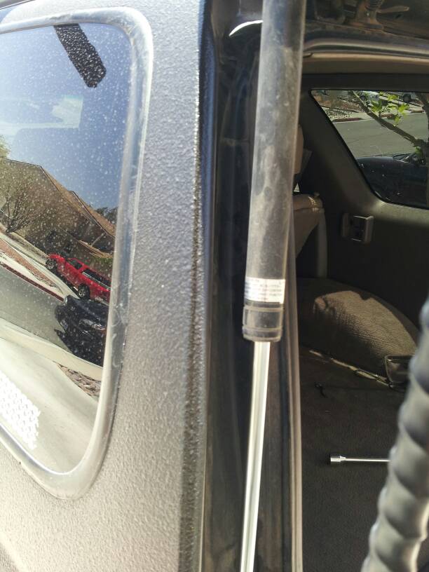

Monstaliner is 100% uv permenant. Out here in 29 palms pretty much everything else gets chalky in a year or less. Herculiner, line-x, and rhinoliner. My truck hasnt faded or chalked and its parked outside in the weather year round.
Plus you can tint monstaliner any color you want. I used Toyota anthracite 1a1 with no binders since that was my stock color. No door jamb. It was pretty close to bang on for shade.
My fenders are rolled. I sprayed the body though.

It takes rocks a lot better! No more pinstripes from brush or branches, no more waxing, hides dirt well, and it washes easily. You have to make sure you prep well everywhere. I have a few spots where it didn't stick well. It was hard to see how well I had covered the paint while I was spraying because it was the same color.
There is some sound deadening to it.....but not enough that I would do something like that just for quieting down the panels. I'm adding 80sqft of sound deadening here soon when I get around to stripping the interior lol.
