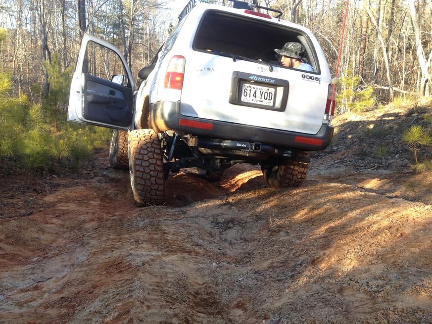

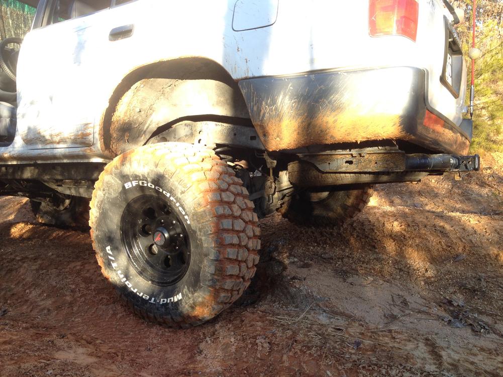

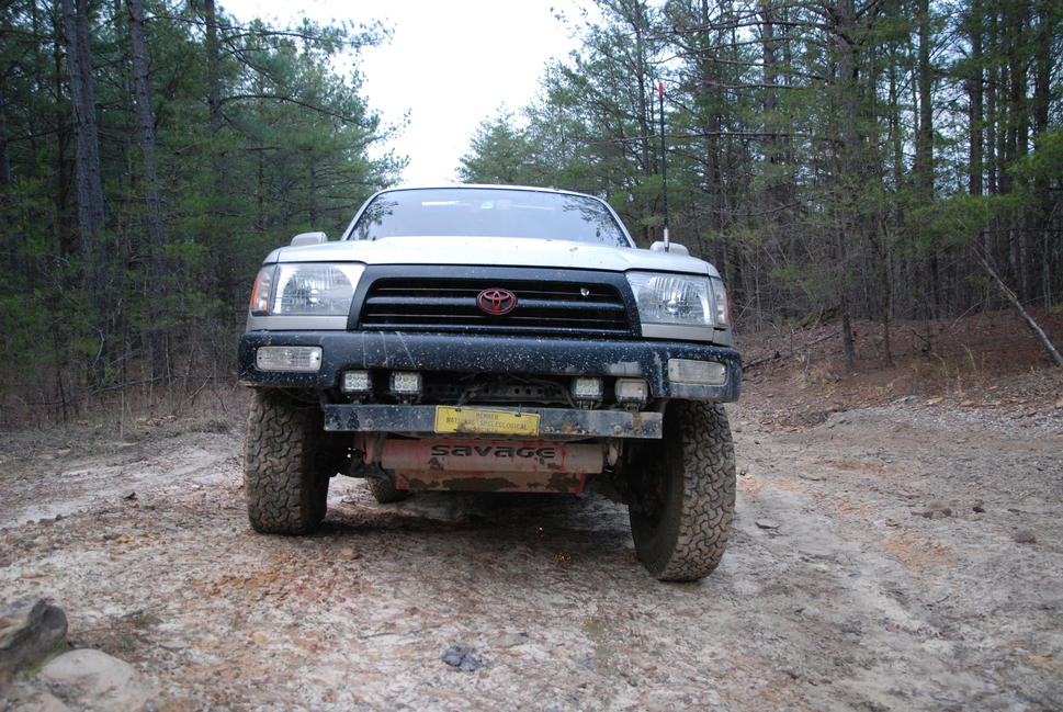

stock front coils flex really well with 5100s on the third perch, granted no sway bars. sway bars are for soccer moms.

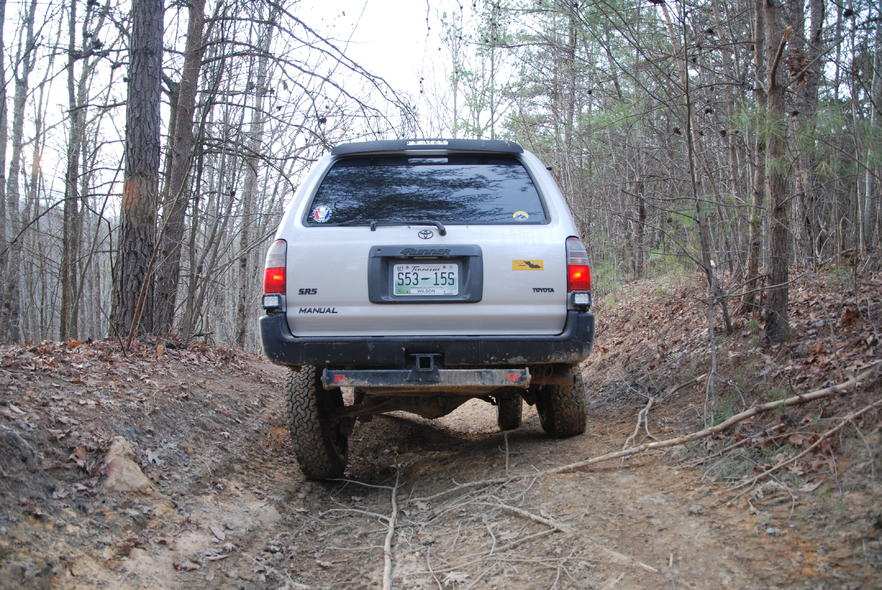

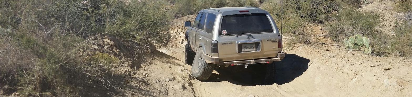

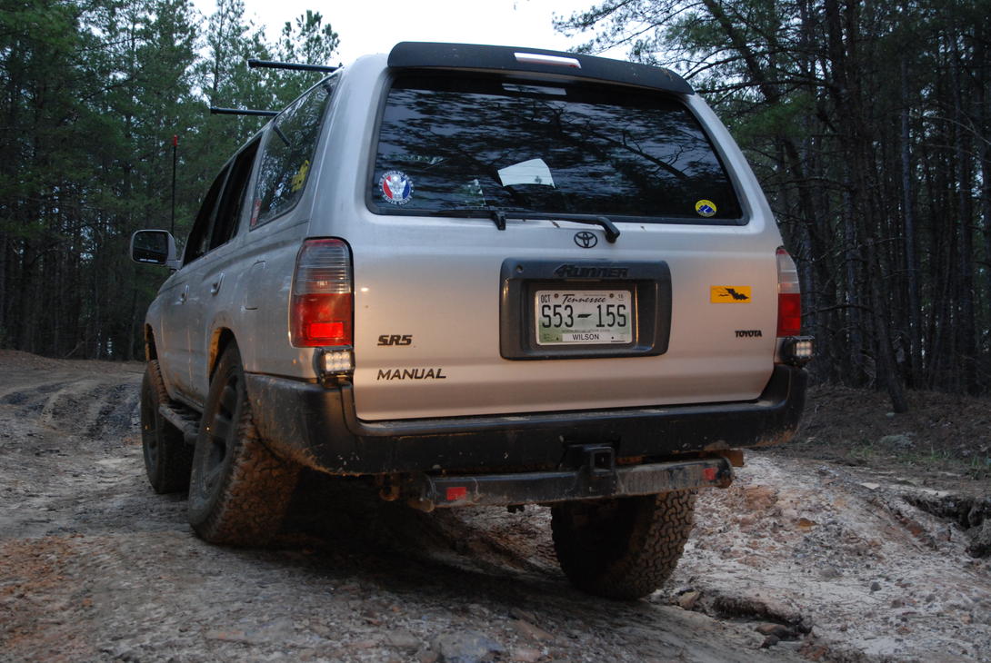

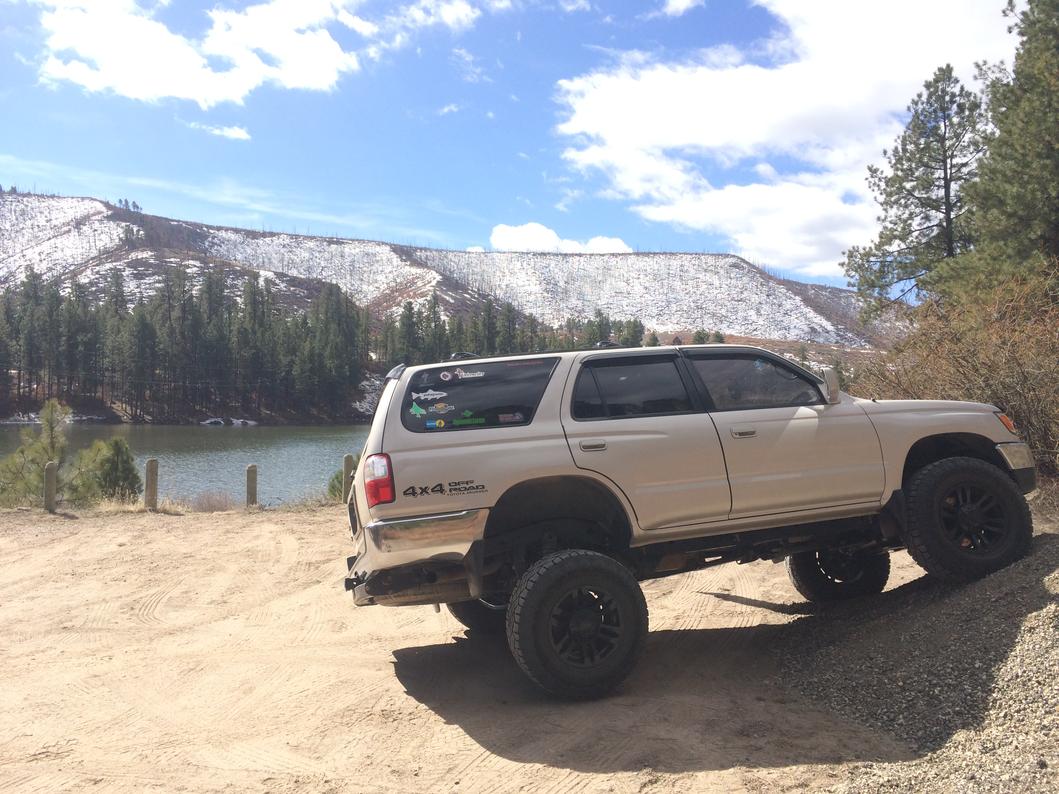

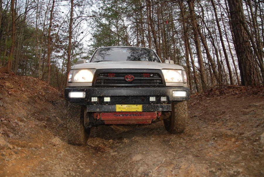

My mediocre flex...
99 Tall Springs, KYB Monomax Shocks, 235/85/16 BFG KOs aka 32x9.25r16, no sway bars.
Here in the next month or two, I will be shortening my front bump stops, extending my rear shocks, and modifying my rear control arms.

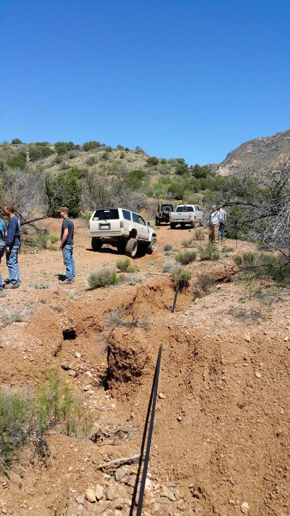

Ive learned that clearing 285's PROPERLY with no body lift takes a lot of modification if you wheel your stuff hard...
1999 limited
Toytec ultimate lift with superflex rear coils
285/70/17 toyo rts

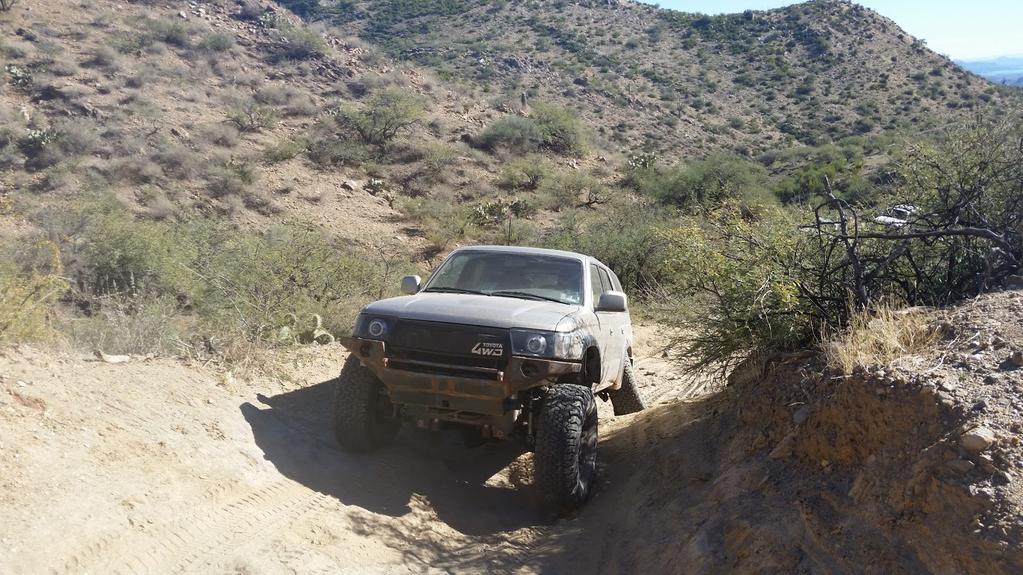

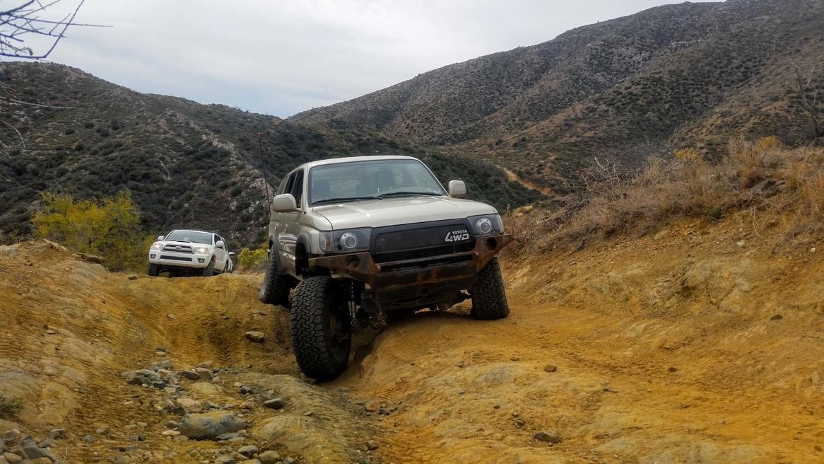

I have cut the bump stops down to just before the sgocks bottom out, the bump stop compresses half an inch. I also tubbed my firewall and "massaged the inner fender with a bfh. also cut the fenders. then i have a tapered body lift of 3" I only run about 1.5" of suspension lift, my truck at full droop fender to hub is 29.5 at full compression its 18.5. I measured this by taling out the spring and using just the shock, and then using my hilift to lift the truck. at ride height I think my fender to hub is around 25" maybe a bit less.
also heres the video.

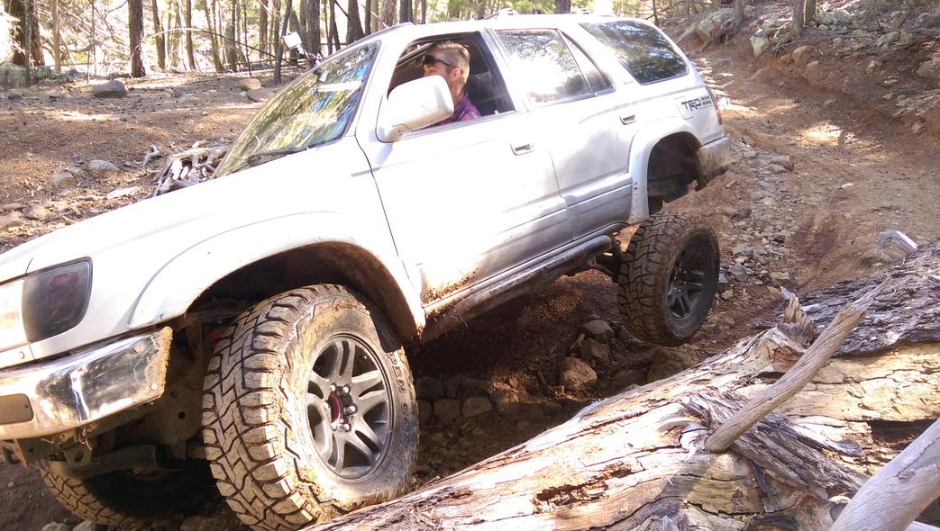

Year: 1996
Toytec Ultimate/Superflex/Extended travel bilsteins
34x12.50r15
