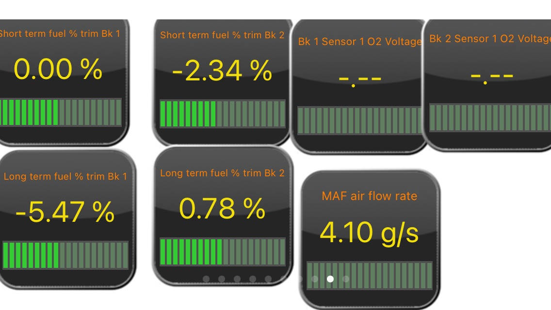

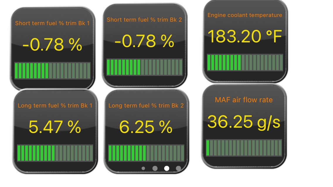

I am working on my new to me 07 T4R Sport. Initial thought was a head gasket but the HG radiator test did not turn the blue fluid yellow, so Im not really sure. No codes, smooth idle. So Im wondering if I have a clogged fuel injector. With the truck warmed up and driven for 20 minutes my LTFT on bank 1 is normal (near sero) while driving, but bank 2 is looking lean +7.8%. So here is what is odd to me. In park idling the numbers flip. Bank 1 is lean and bank 2 is normal.
Im mostly concerned about bank 2 and if the reading is normal at idle, but lean while under load, I assume its not a vacuum leak. Would I be off target by thinking its a bad fuel injector on #2,4,6 cyl? What else could cause this issue?
Screen shots of fuel trims at idle and and with foot on gas while parked.

Those numbers don't look bad at all. Ideally, you'd want the trims to zero out when the pedal is applied, but anything under a 10 plus or minus is usually ok. Don't think you have anything to worry about. Is fuel economy ok?

Generally speaking as long as LTFT is below 10%+/- from 0 you are OK
STFT within 25%+/- from 0
If your numbers are outside of those parameters you could consider cleaning your mass airflow sensor, looking for vacuum leaks, or checking to make sure your upstream O2 sensors are working properly.

As the air volume increases, the lean condition also increases. Possible issues are a bad O2 sensor upstream, bad fuel injector, ... any other suggestions?

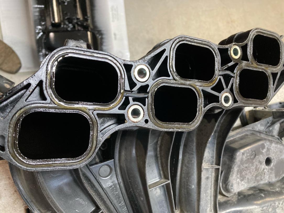

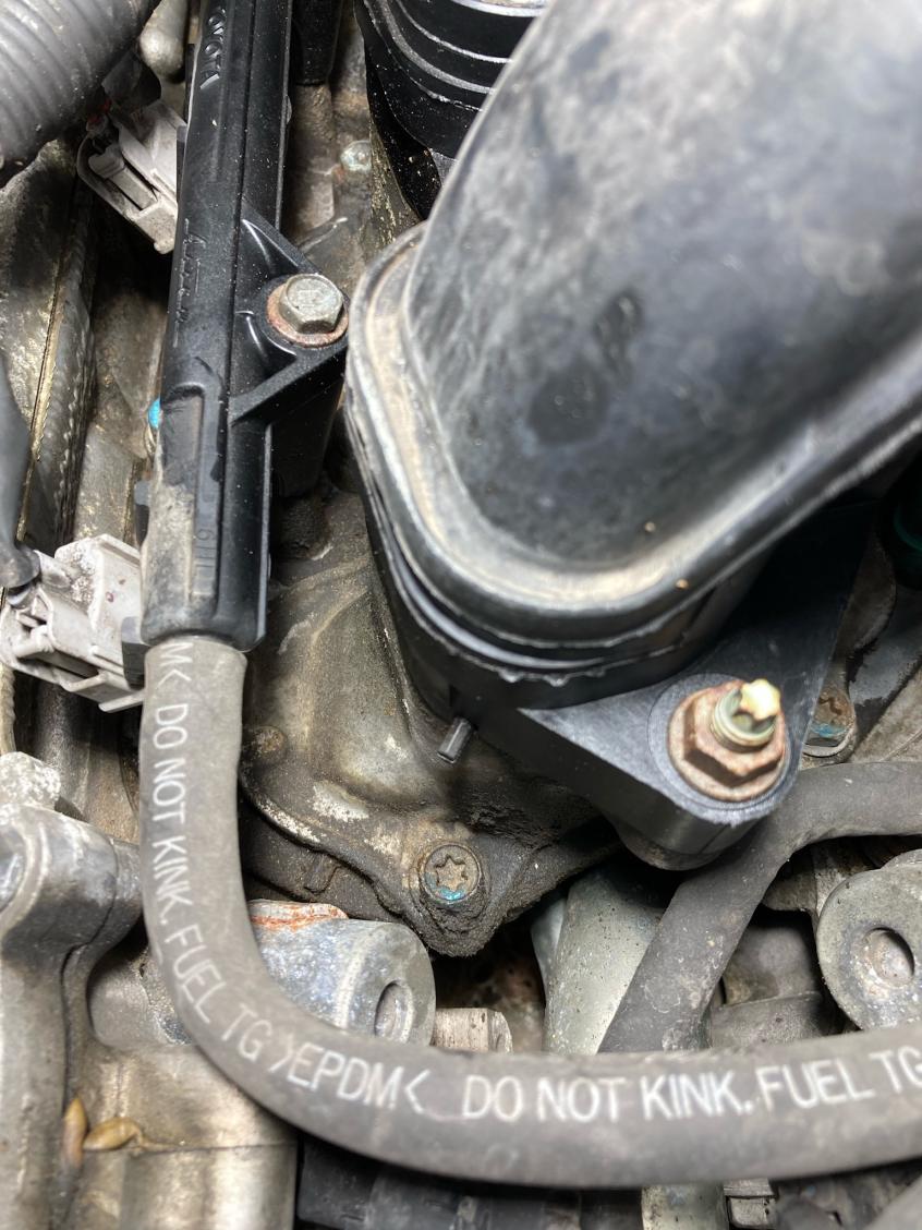

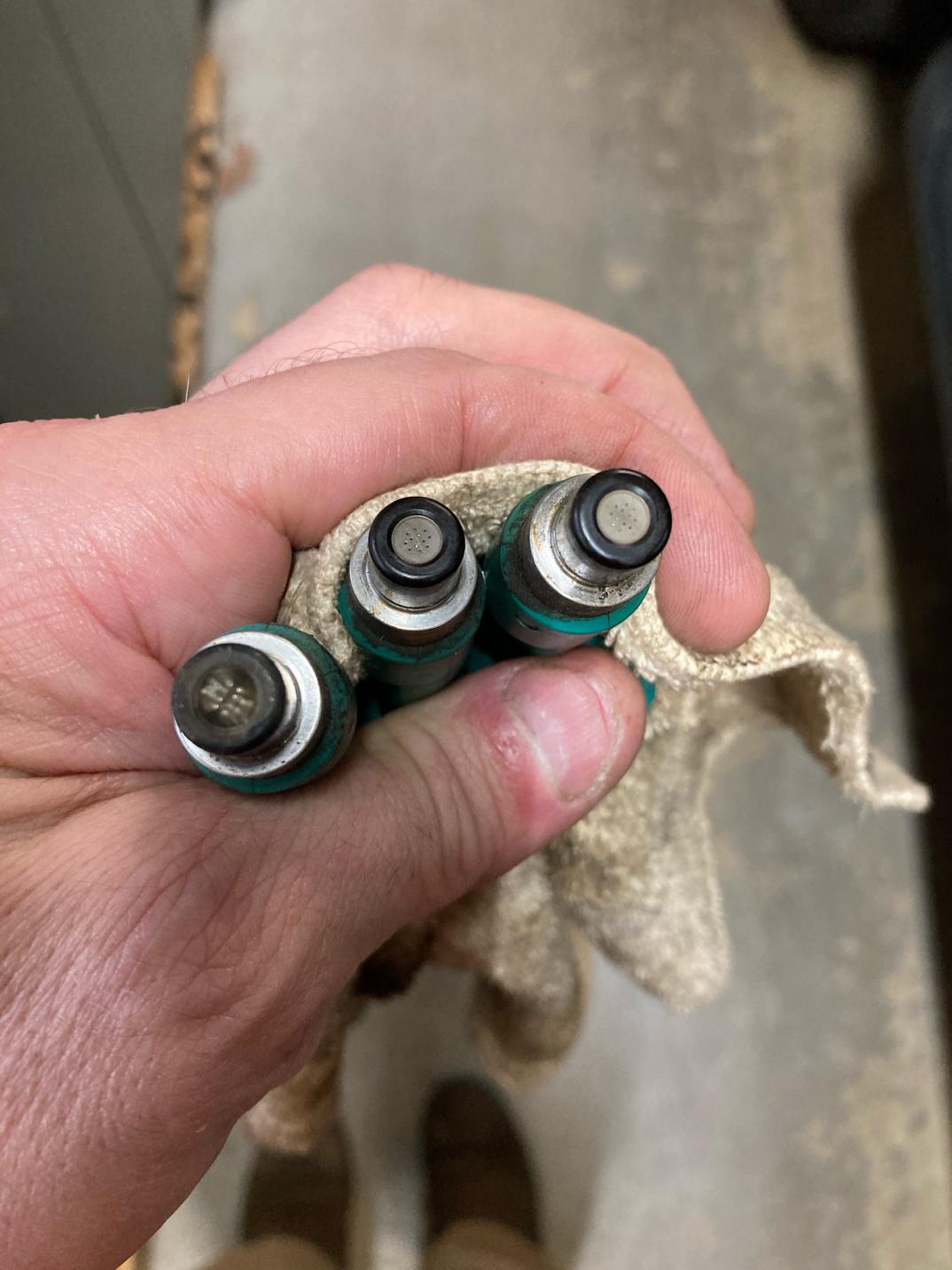

I had some time this weekend and dove into the fuel injector project. At the same time decided to replace the valve cover gaskets as well. As I started removing the intake plenum, I found some oil build up on the lower intake and fuel injectors and my best guess is the oil is coming from between the plastic intake plenum and lower intake. You can see in this picture all the oil outside the gasket area on the plenum. The gasket was hard and compressed and probably the source of the air leak I could hear.

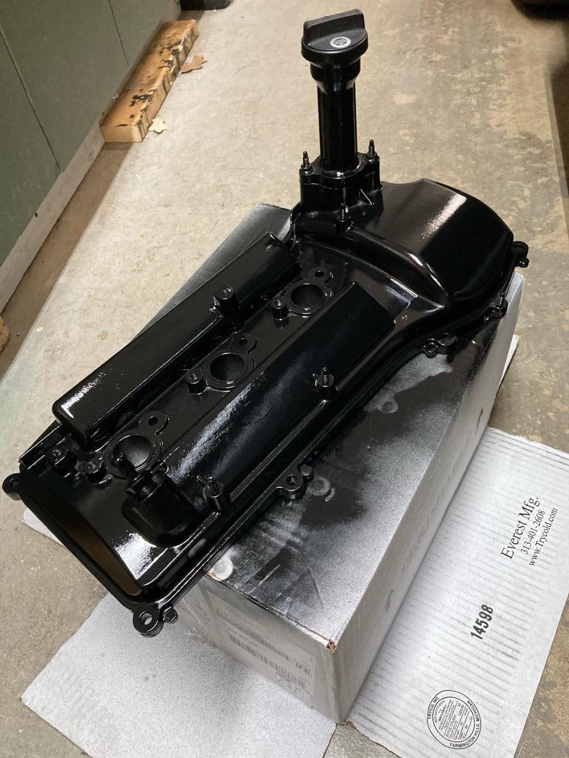

As for the bank 2 LTFT being lean under load, the number 6 injector (far left) looks clogged. Also the lower injector gaskets were hard and loose and gave no resistance to being removed. There’s no way to know for sure if they were clogged, but I replaced all 3 on the drivers side just so I wont have to go back in this deep again. Im waiting for the valve covers to dry from a quick paint job in black and then I can put it all back together and see what, if any impact all this work has had. More to come.

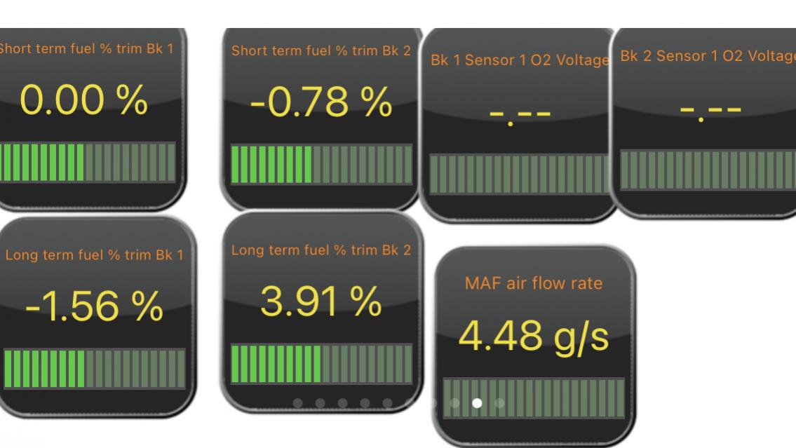

I made some progress. Put it all back together, reset the ecm, took it for a test drive. The LTFT is now 3.21 to 3.91 on bank2 which is good.
Now I think I can look at the MAF or bank2 upstream O2 sensor to get better results. The O2 sensor is responding quickly, so MAF will be next. Any thoughts?

Update. After replacing all six injectors and the MAF the LTFTs were still unbalanced. So I replaced the fuel pump. Finally the fuel trims are balanced and within a reasonable limit. Im sure the O2 sensors are most likely original with 223,000 miles. It runs fine so I dont plan to change them until it throws a code. At $120 each, I can wait.
This was driving on the highway at 70mph. Routinely adding just 5% under load but balance left and right

Nice methodical approach. I was going to suggest running a bottle of Red Line SI fuel injector cleaner as I've had good results correcting LTFT imbalances on other vehicles (I run this before most every oil change as preventive maint).
Did you take a fuel pressure measurement before replacing the fuel pump? That would be good data, although your replacement definitely seems to have corrected the remaining issue.
It's my experience that as delivery pressure decreases, discharge volume increases (PV=nRT) and I've seen cases where low pressure caused negative LTFTs albeit on both banks. One was a bad pump, the other two were bad fuel pressure regulators with likely worn-out springs.

I didnt test the fuel pressure because its a toyota and nobody carries the correct adapter to plug into the fuel line, and a new kit was too expensive $300-$400 IIRC. So for $100 I bought a new denso pump and diy’d it. My thought was under load I had a lean condition and the ecu was adding fuel to compensate. With low fuel line pressure, the bank 1 injectors were not getting the same volume /pressure as bank 2 and hence, the imbalance. Just a theory.
