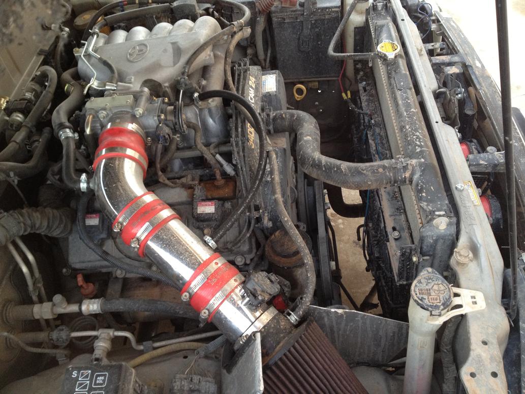

What intake do you have that you are getting a lean code? The airflow meter should have more than enough room in its programming range to accommodate for the increased airflow of an intake. unless the sample tube portion of the intake is drastically different in size than the stock air box.
intake pic

What size is the tube itself? Factory should have been about 2.5" ID, and that is what that sensor and ECU are calibrated to use. Increasing it by even 1/4" will cause havoc with the ECU's tuning. This is a good trick to use when you want/need to run larger injectors and have more head room for the MAF under boosted conditions. You could potentially use a fuel pressure regulator to increase pressure and "fix" the fuel issue, but you will want to monitor spark timing. As the ECU sees less air from the larger tube, you will move the timing map into what is most likely a more aggressive amount of spark advance.
If the tube is the same 2.5" ID then I would check the vac line that feeds the fuel pressure reg. should be around a 4mm vac line, (you have some hose clamps on it) make sure you are getting a good signal from the intake to the regulator. although generally this should cause it run rich under WOT rather than lean.
wheres the vacuum lines that hooks up to that tube on the intake manifold ?
those lines were never there that i know of?
And yeah the intake tube is bigger the inside diameter is 2 3/4. Sometimes under WOT when the check engine light is on it will pop/Backfire and pick up again would that be that its running lean at WOT or rich? Im getting headers and trd dual cat back would uni unit be good ?
Yeah you are running lean ... I don't want to jinx you, but if you keep it up you are going to damage the engine. I would throw the stock intake back on at least for now. Find some smaller tubing for at least the MAF section of your intake.
Take a look at a lot of the bigger "name brands" injen, fujita, AEM, etc this is why they will have that bottle neck at the MAF sensor.
o man i been running it awhile like this and i have done a few road trips and like 5 hard trips to the local dunes but it has only has back fired on my like 3 times. i always wonder y my tundra k and n intake had that bootle neck now i know. do u think i will be ok if i leave it and add the fuel regulator?

Man you are already throwing codes and you haven't even added the SC yet. I would get the ECU working correctly before modifying your engine any further.
