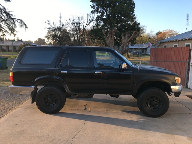

Nice looking rig. I will try and get a pic of mine posted tomorrow. And one of these day (not anytime in the near future) I would like to do the 3.4 and manual swap.
Still have to lower the front a little.

Looks really good! Actually looks down a bit in front to me from that picture. Be careful with the optical illusions of the 2nd gen's: the wheel wells in front are like an inch or more higher than the rear. (Use the horizontal body line across the doors as a reference). The rear wheel wells are lower than it, fronts are higher. Tends to throw off the eye a bit.
Overall, looks really good! Ready for 32" or 33" tires!
