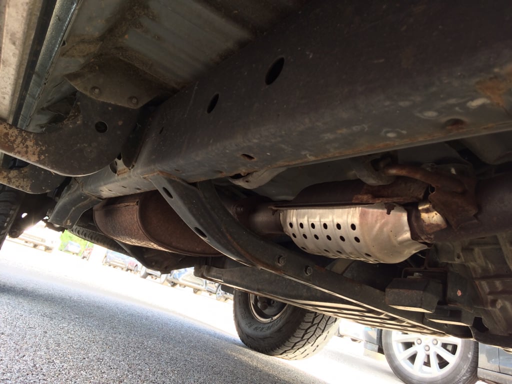

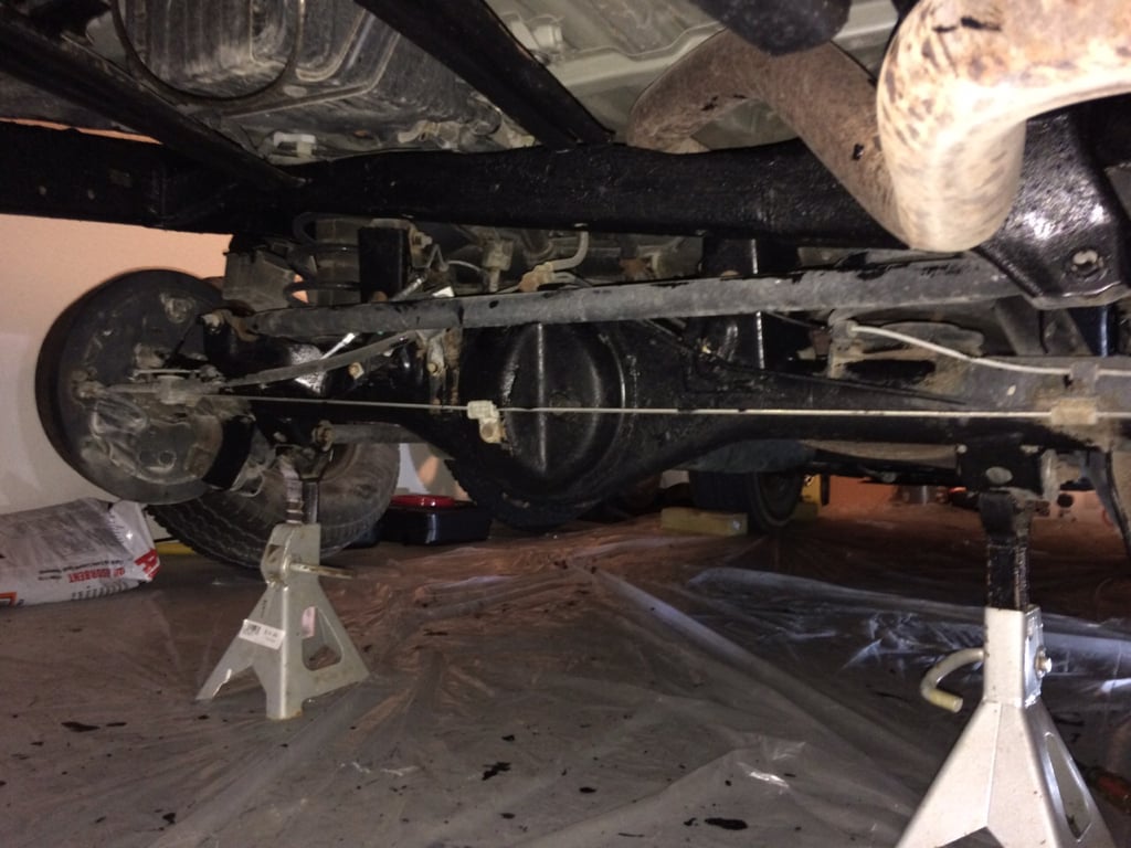

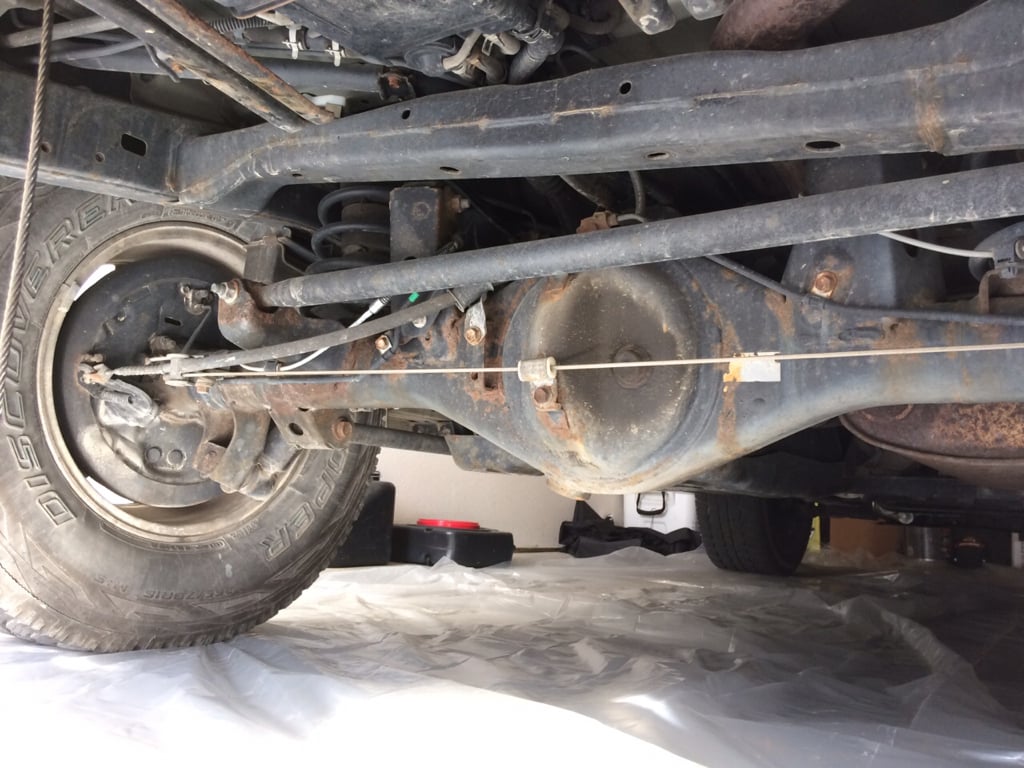

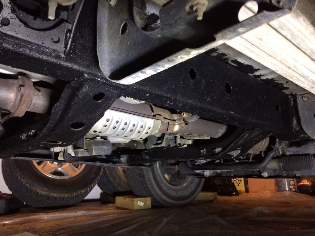

This is what I used. I haven't been under it again since I did but I am waiting for winter to get over to check it out.
I put the truck up with a lift and used an angle grinder and twisted wire cup brush head that removed a lot of rust, but was messy.

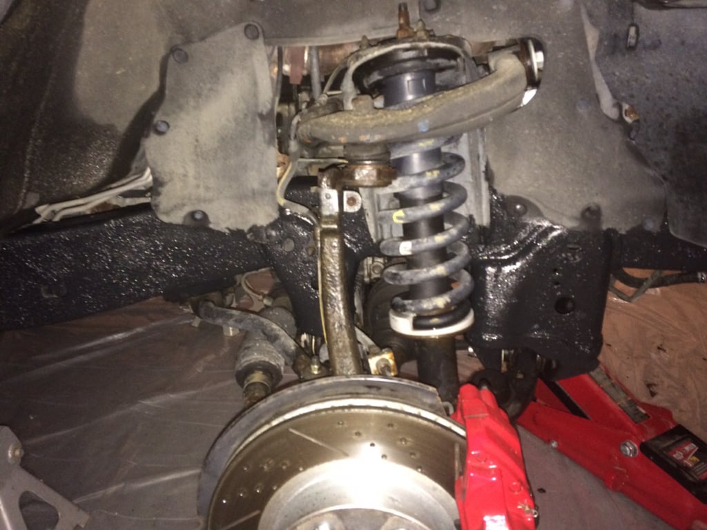

I cleaned the undercarriage, applied rust converter the flaky areas, duplicolor bed-armored the frame, then before winter used 12 cans of fluid film inside and outside of everywhere including body panels.
I don't have any pictures of the fluid film but that goo is everywhere.
