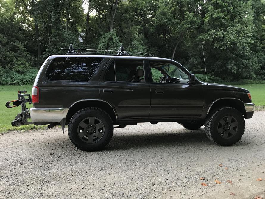

I just put the same shocks/struts on my 1997 a few weeks ago. I put the front struts 2 notches up from stock, and added an 1.5" polyurethane spacer on the rear. My goal was just to clear some larger tires, but I noticed a huge improvement in on road handling, too. I'm really happy with how it turned out. To answer your original question, you don't need anything for the rear, but you will need new bushings for the top of the strut in the front. I reused the originals, but they were pretty beat. I'll pull it apart and replace them in the very near future.

Awesome. Nice looking truck! That's the exact look I'm going for as well. What size tires are those?
Thanks, man! They are 265/70R17 BF Goodrich KO2's on 17" factory FJ Cruiser wheels. I don't do much wheeling apart from driving on the beach for surf fishing, and the occasional forestry/fire service road, so I really just wanted a slightly modified/stock look. I couldn't be happier with how it turned out, and wasn't hard on the wallet, either.
