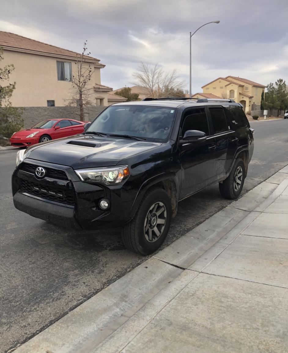

Just installed 5100s w Ome coils
Front - 884
Rear - 889 Medium Weight
Anyone else running this setup?
Currently just a lift. Nothing else. Awaiting wheels & tires...

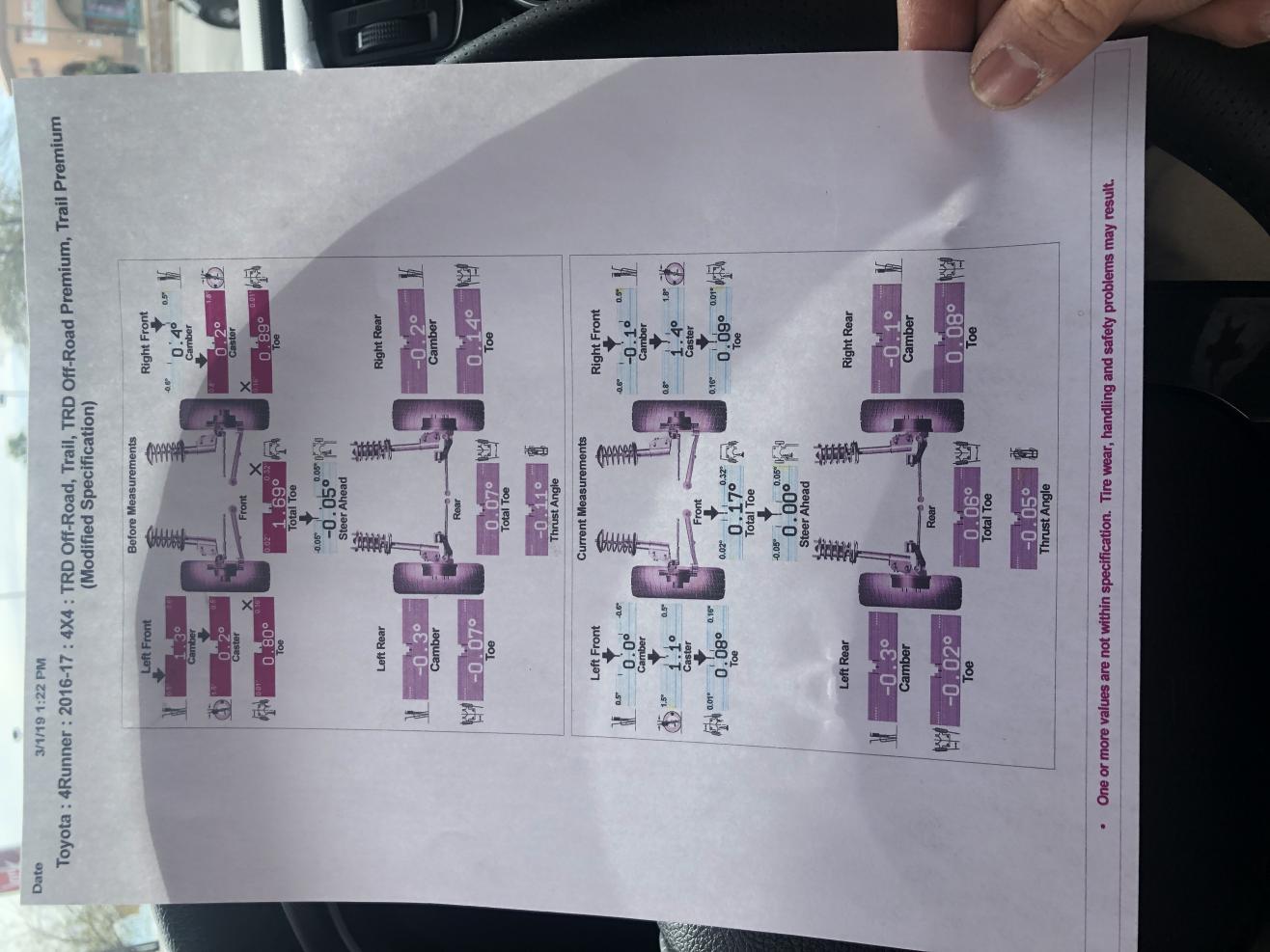

I had alignment done. Do you see anything wrong?

pretty close to it!
just be aware of the height increase... your rears will blow out eventually if you go over the 2" lift max recommendation by billstein.
You desperately need UCA's, that caster (1.0 and 1.5) with a lift will make that thing drive awful. Caster with a 3" lift should be in the 3-4 degree range.

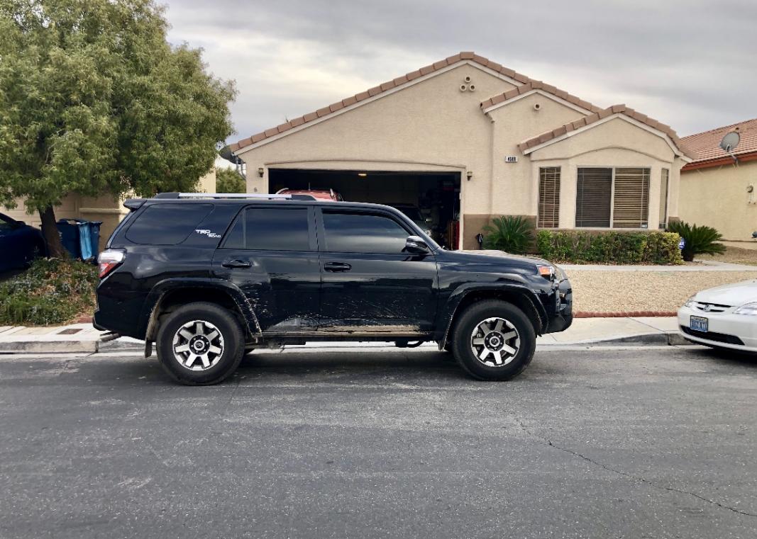

i am on the 2nd notch.

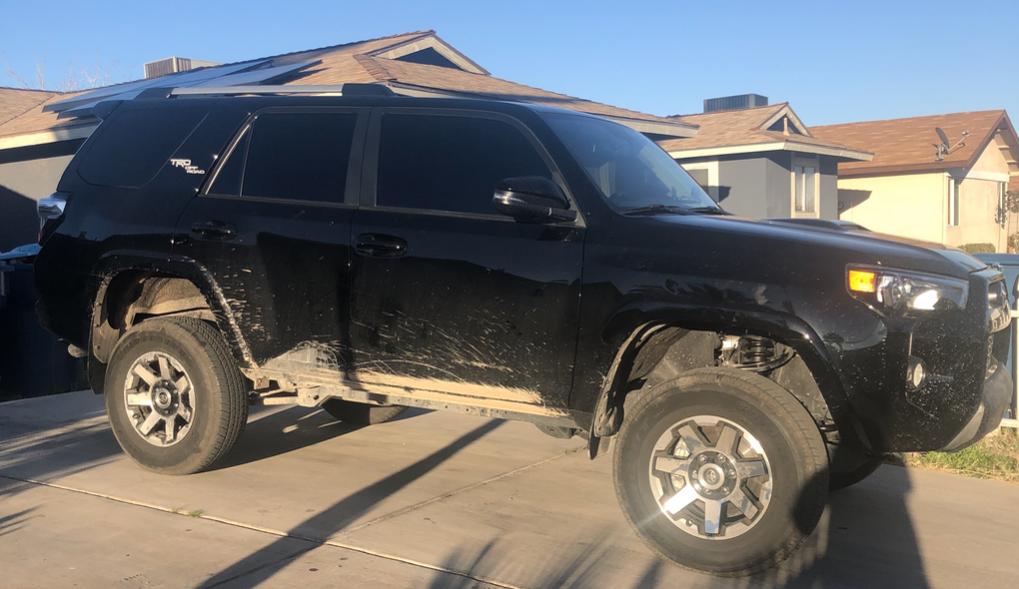

Hey do you have any pictures after installing your tires? And how was it on the second notch? I'm planning to do the same and came across your picture. O ly difference here is I'm ru ning heavy duty springs up front and back
Sent from my SM-G975U using Tapatalk
I've been running 5100 in the 2nd notch and 5100 in the rear for 2 years and the Truck drives better than new. I have 1.5 inch wheel spacers as well since I'm running the stock rims. When I take it offroad I have a much more responsive suspension over stock. Washboard fire roads and moderate ruts don't slow the vehicle down.
