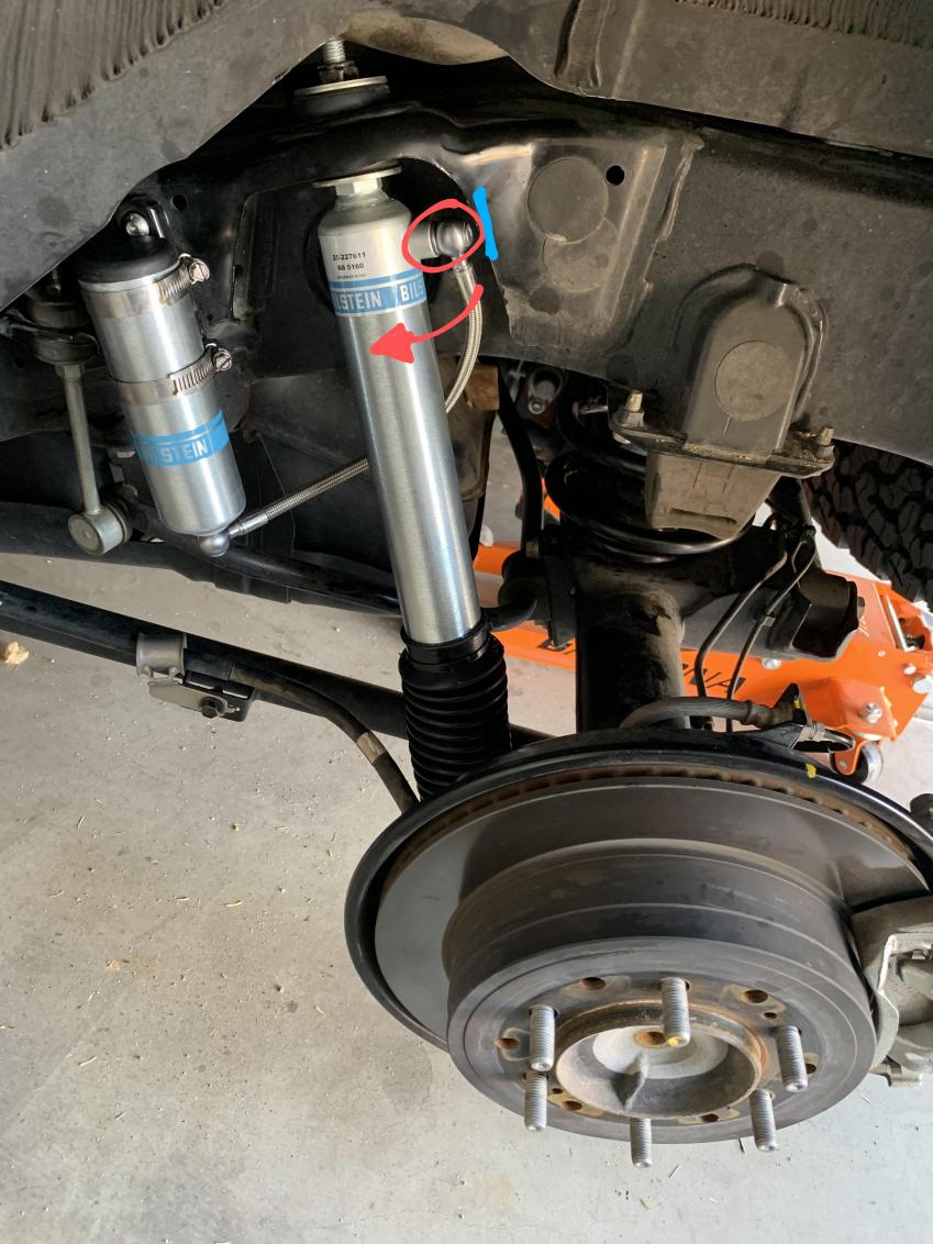

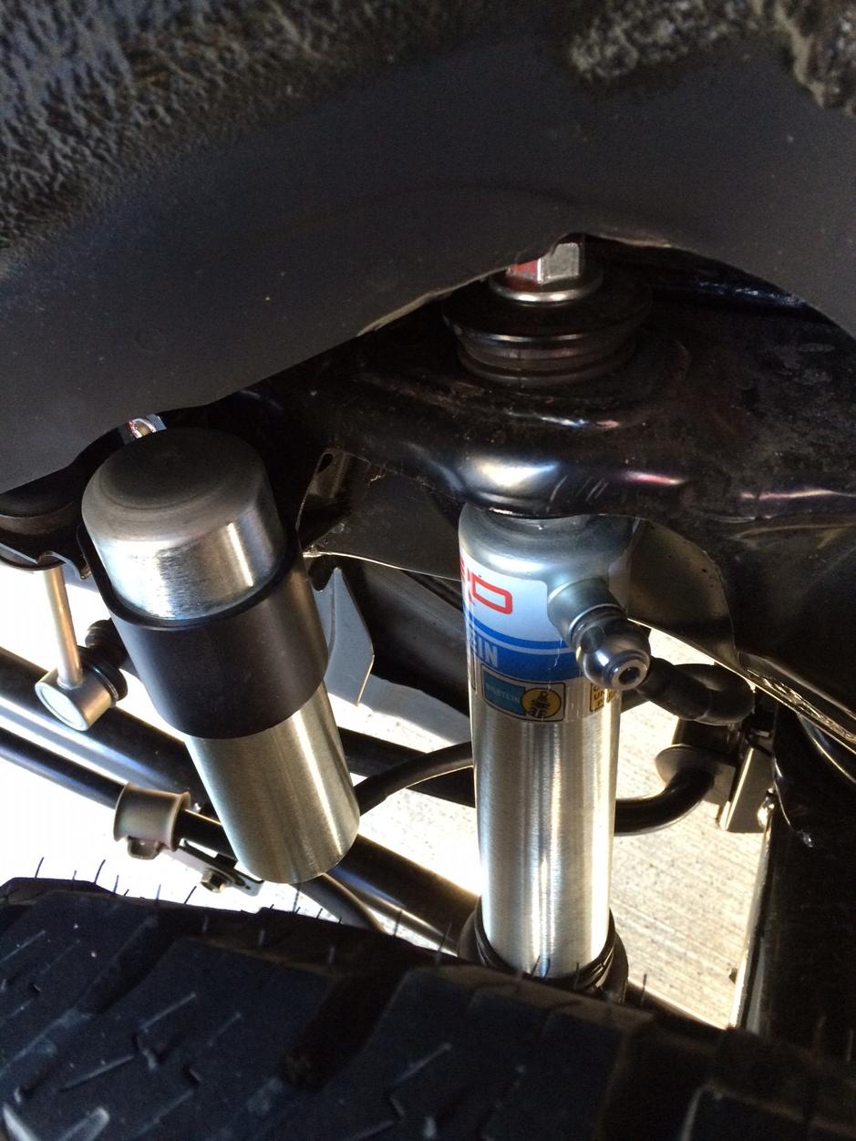

Pic for attention:
The reservoir hose fitting should have a Threaded banjo bolt that can be tightened just like a brake line to brake caliper. You can see the copper sealing washers and it appears to be some type of swaged/mechanical connection of the hose to the shock head. Poor engineering design and the Germans always pride themselves on their superior engineering but not so much on the 5160. They could easily fix their design flaw but from my experience they don't listen to their customers (German products of all kinds) and only change/fix their mistakes when they feel it is their superior thinking that brings about a change. Pathetic in my opinion. Keep sending them back and don't back down ever.

Pic for attention:
Had 5160s on for 5000K+ miles now, and so far so good. I'm wondering if the way you have the reservoir fitting pointed directly at the upper shock mount gusset on the frame has anything to do with it. It could be that during flexing the shock moves enough to have the fitting hit the gusset. I have the shock twisted out a where the fitting is angled out towards the rear tires a little, and away from the gusset. I believe this is also how the factory TRD Pro has the rear shock mounted. I also noticed that if the top mount is too loose the shock tends to twist back inwards after some driving. Looking at your first picture it looks like the top mount could be tightened a little more. Good luck !

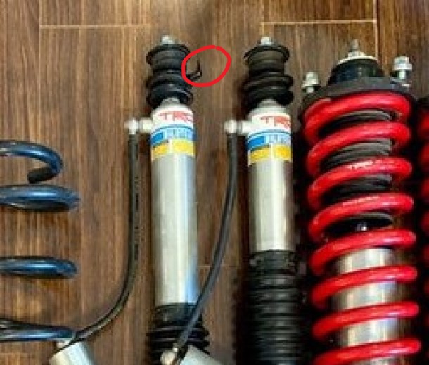

Not mine, but I have the rear shocks positioned like this. I had the TRD version of the Bilstein 5160 before, and remembered that there was a fixed washer on the shock with a prong sticking out that goes into a hole in the shock mount on the frame to prevent twisting during driving\off-roading. I'm assuming that was to prevent the fitting from getting too close, or hitting the shock mount gusset on the frame. Too bad the Bilstein 5160 didn't come with this same feature.
Thanks for the insight. Not sure what you mean by the "reservoir fitting pointed directly at the upper shock mount gusset on the frame"...are you talking about the round ball/hose part that goes from the top of the shock needs to be angled down more. In any case, I will pay attention and twist the shock body more towards the tire in the next install and hopefully thats that. Bilstein instructions doesn't mention anything about angling the shock body except to "Orient the hose fitting toward the rear of the vehicle as shown in Figure 7". I'll also note to screw down the top mount more and compress the bushings even more.
What I meant was the round hose fitting on the main body looks to be too close to the frame mount. During flexing it could come incontact with the part of the frame I marked in blue. Twist the shock outward a little so that the fitting clears the frame. I think Bilstein doesn't mention this in the instructions because the shock can be used in other applications that may not have more clearance than the 4Runner application? I know for sure the stock TRD Pro Bilstein 5160 shocks are pointed outward from factory with a prong that keeps the shock from twisting
Thanks for the clarification. Too late now to rotate it since its already leaking, but I will be mindful in the next install.
Also from a quick google pic search on "4runner 5160", seems to be most people have the hose fitting installed similar to mine, maybe the Pro part vs the 5160 is a bit different and the nipple or whatever is at a different angle?
I respectfully disagree.
As long as there is clearance there it should never contact the frame.
Mine was installed in a very similar way and 80k mi, no issues with any contacts.
Sure turn it to a different position. That will give you piece of mind.
I think the failure is mechanical on BILSTEIN’s side, not that the installer.
Just my humble opinion.
Don’t get me wrong, BILSTEIN makes good products, but this was just a failure on this individual T4R.
