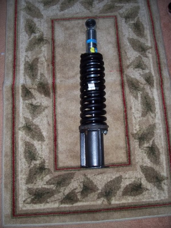

Has anyone did this to a 6112 shock? And how's the ride quality? IMG_1433.JPG (I know it's a 5100) ohh yeah sorry trying to do a 6inch lift on myT4R
isn't that the wrong shock for the 5th gen 4Runner? there's supposed to be a stem at the bottom.
also, i'm not so sure about a 6" lift on a 5th gen 4Runner without a bracket lift.

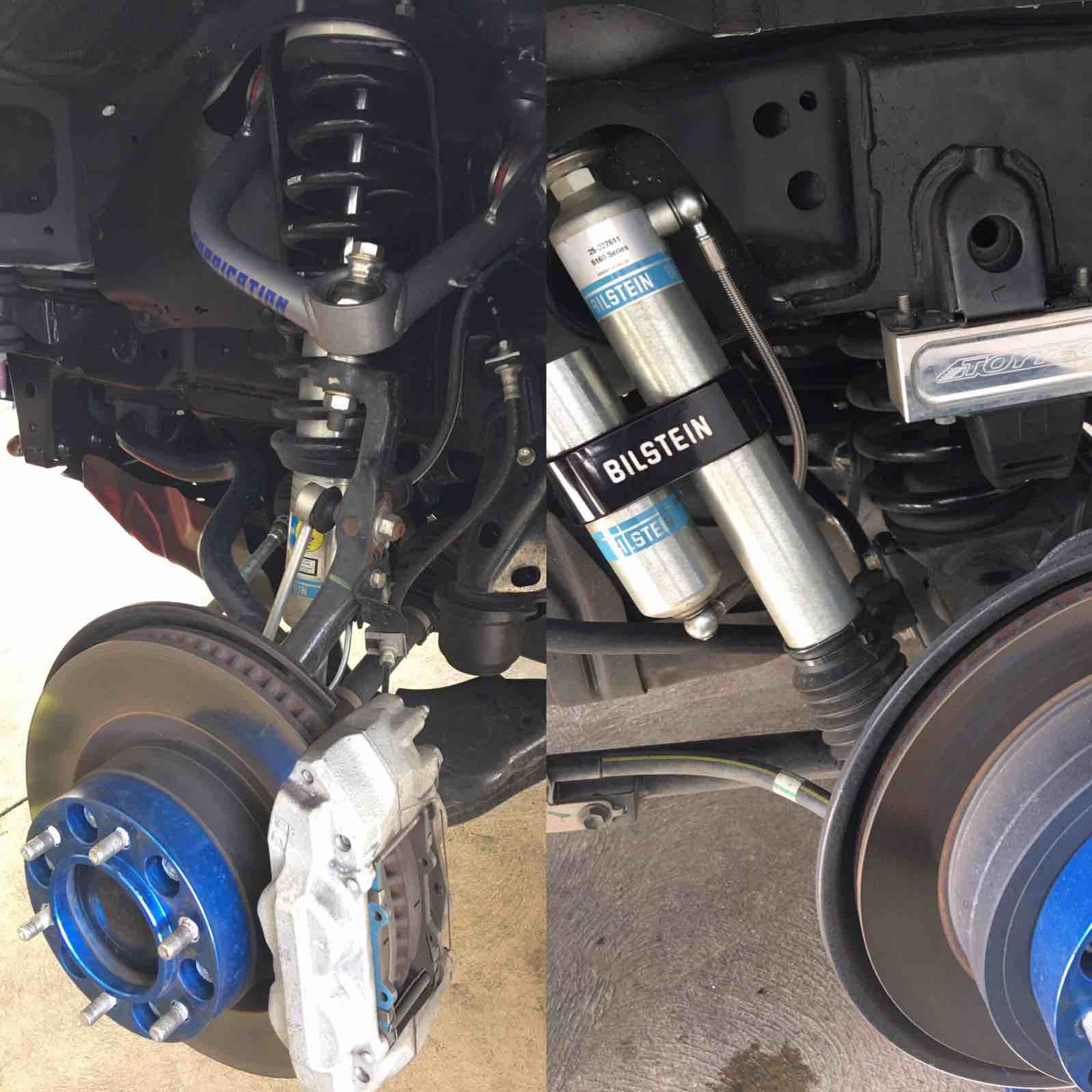

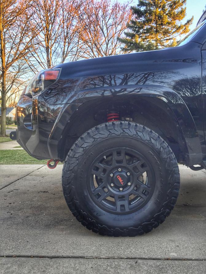

6112's set at the highest perch

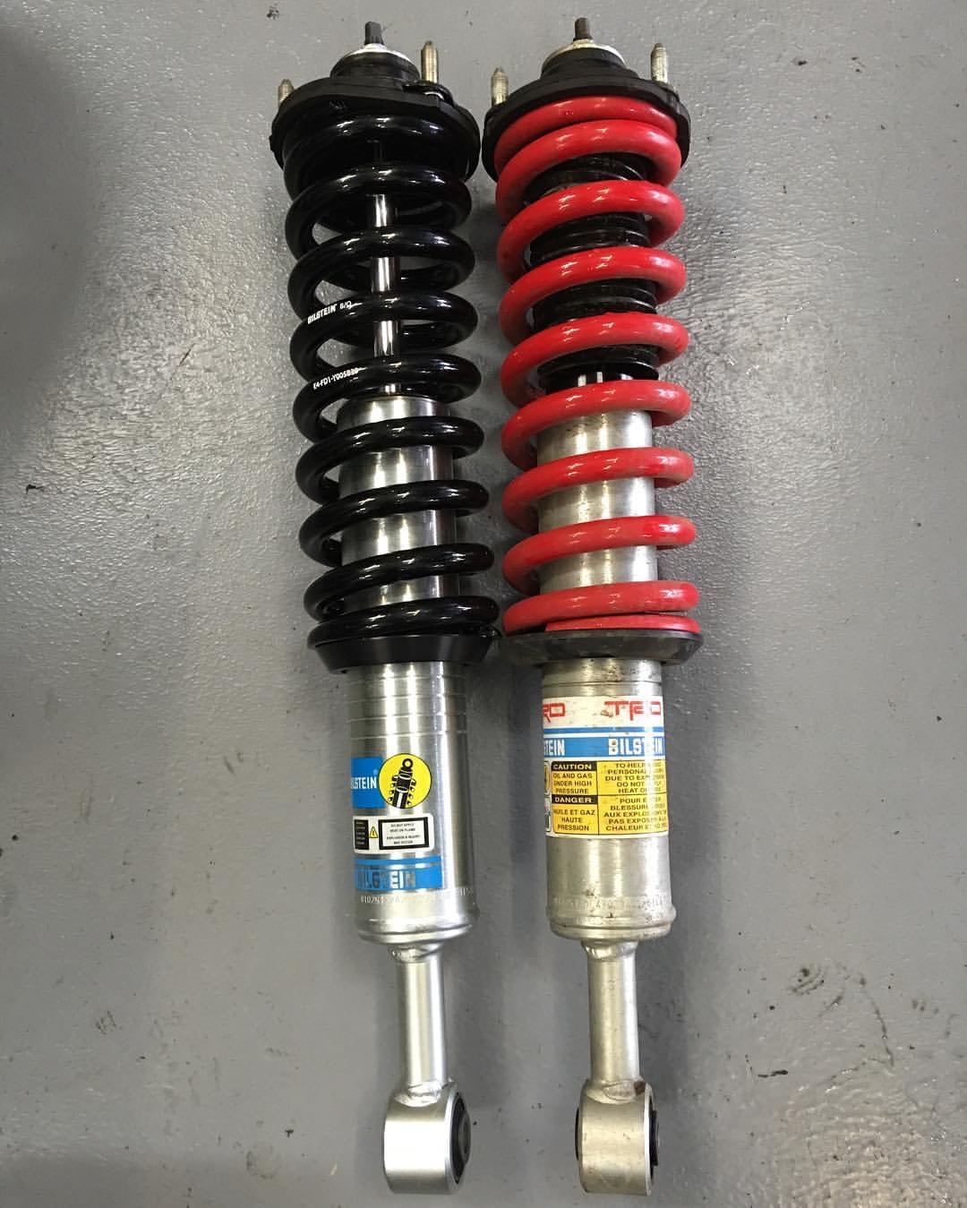

They are the 6112 springs but I had them powder coated to match the original TRD suspension.
I see, Would you happen to know if the TRDP front coil springs will fit the bilstein 6112 shocks?
Here they are side by side. Pretty much identical diameter body just with additional notches for height adjustment on the 6112s. I believe the 6112s are valved differently tho compared to the TRDP shocks due to different spring rates. The 6112 Springs being stiffer minimize the brake dive that the stock TRDP Springs have.

It seems that the 6112 coils are not only stiffer but are also longer since the 6112 shocks have adjustment notches below the lowest notch level of the TRDP shocks.
I was thinking that the TRDP coils are longer and could provide more lift than the 6112s could.
Is the TRD shock in the picture from the FJ, 4runner or Tacoma? I am curious, because the FJ kit has the spring perch 1" lower on the shock compared to the 4runner and Tacoma. The FJ kit also uses a 14" spring to make up the difference. Is the 6112 spring 13" long?
