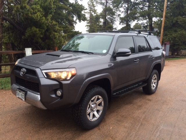

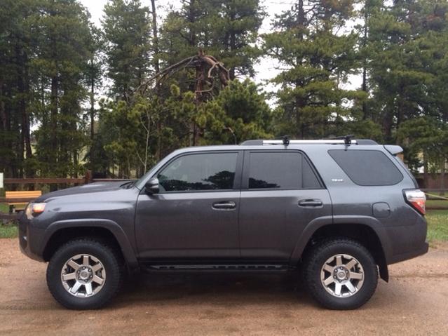

The 6112's are installed in the front at the third C clip setting for ~2" lift on a 2015 T4R Trail. The rear 5160's are installed with the Icon 2" springs. Tires are Nitto Terra Grappler G2's. I'd say I came right in at 2".
Before After Lift
L Front 34.5 36.5 2.0"
L Rear 37.0 39.0* 2.0"
R Front 35.0 36.5 2.0"
R Rear 36.75 39.0* 2.0"
(Actually, 39 1/8" but i rounded...)
Notes:
I'm amazed that the side to side "lean" disappeared after the lift. [MENTION=103267]Saker[/MENTION] noted similar equality between the sides.
No lift noted from the 5160s, only the springs. My dog is in the back and it came out 2 inches exactly. Now, he needs to jump a tad bit higher...
The mechanic said the Alignment came in perfect. (i do not have the sheet)
It's raining in Colorado today so everything is wet. All I have are dirty pics...
We took it for a drive up High Grade Road. Yes, it's pouring out... a real good test. Driving has a much improved feel. Tracking, bumps are indeed handled better (the driver alert bumps kinda melt away). IMHO, this is how the 4Runner should be stock. Yeah, suspensions are subjective and definitely wont say this is the best thing since sliced bread sprinkled with unicorn dust but, really... I do like. :guitar3::guitar3:
