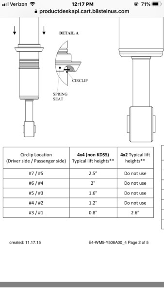

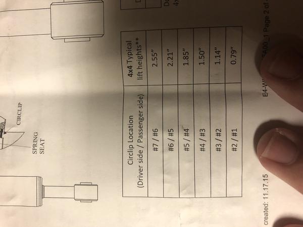

I hate to create a thread about this but nobody else has caught this as far as I can tell. I recently got a new set of 6112s and had looked up settings on the Bilstein website before they got to my door. I screenshot it for later reference. I happen to look at the actual instructions that came with my new shocks and it has the old settings from a previous revision date. Here are the old and new settings to compare. Your instructions will likely have the old settings.
NEW CURRENT SETTINGS
OLD OUTDATED SETTINGS
With Updated KDSS Settings
If anyone wants to correct the rotation of this pic feel free

Is there anything updated specifically for KDSS 4Runners? They were/are suppose to update that as well.
