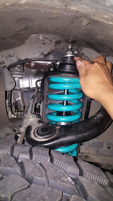

has anybody had this issue installing 5100s strut on the limited?
the strut seems like its too long my truck.
the springs dobinsons 300. strut set at 0 level.
i took the leaking xreas out.
need your expert input and suggestions,
thanks

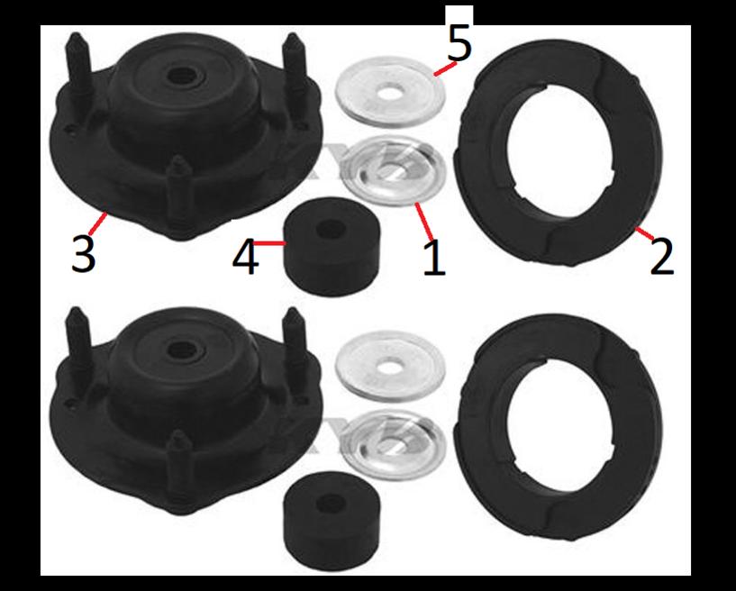

Pretty much but that pic doesn't show the bushing inside the tophat. Also the OP removed the shock cover and it seems to be the general consensus that if you do this then the metal washer that is part of the shock cover still needs to be used.
Pic of the lower rubber bushing can be found in the Amazon reviews. Anyways, the point should be moot since it's attached to the tophat.
https://www.amazon.com/gp/customer-reviews/R1FNNZL61PTF3K/
