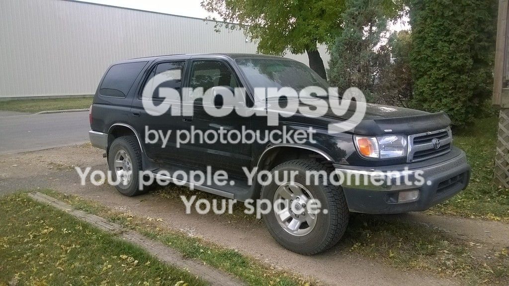

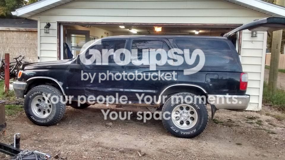

Here it is when I first got it:

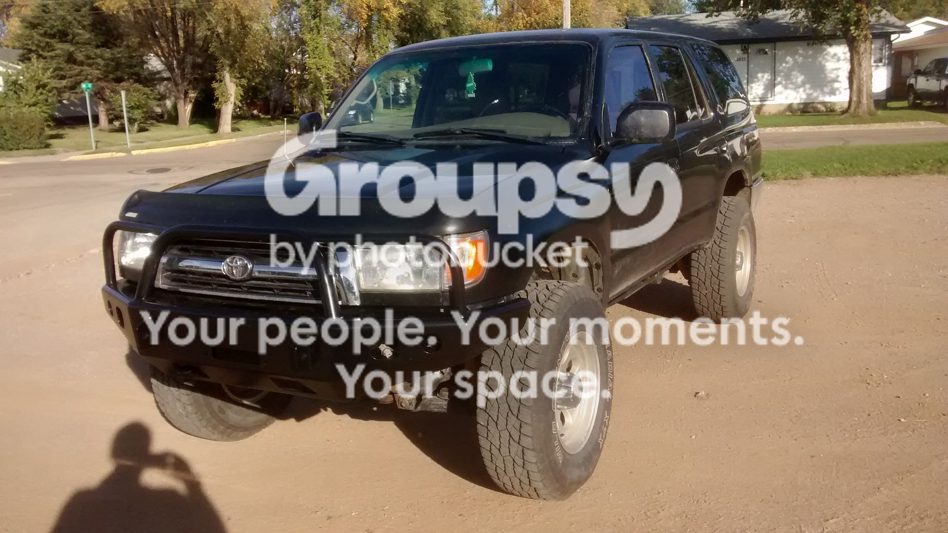

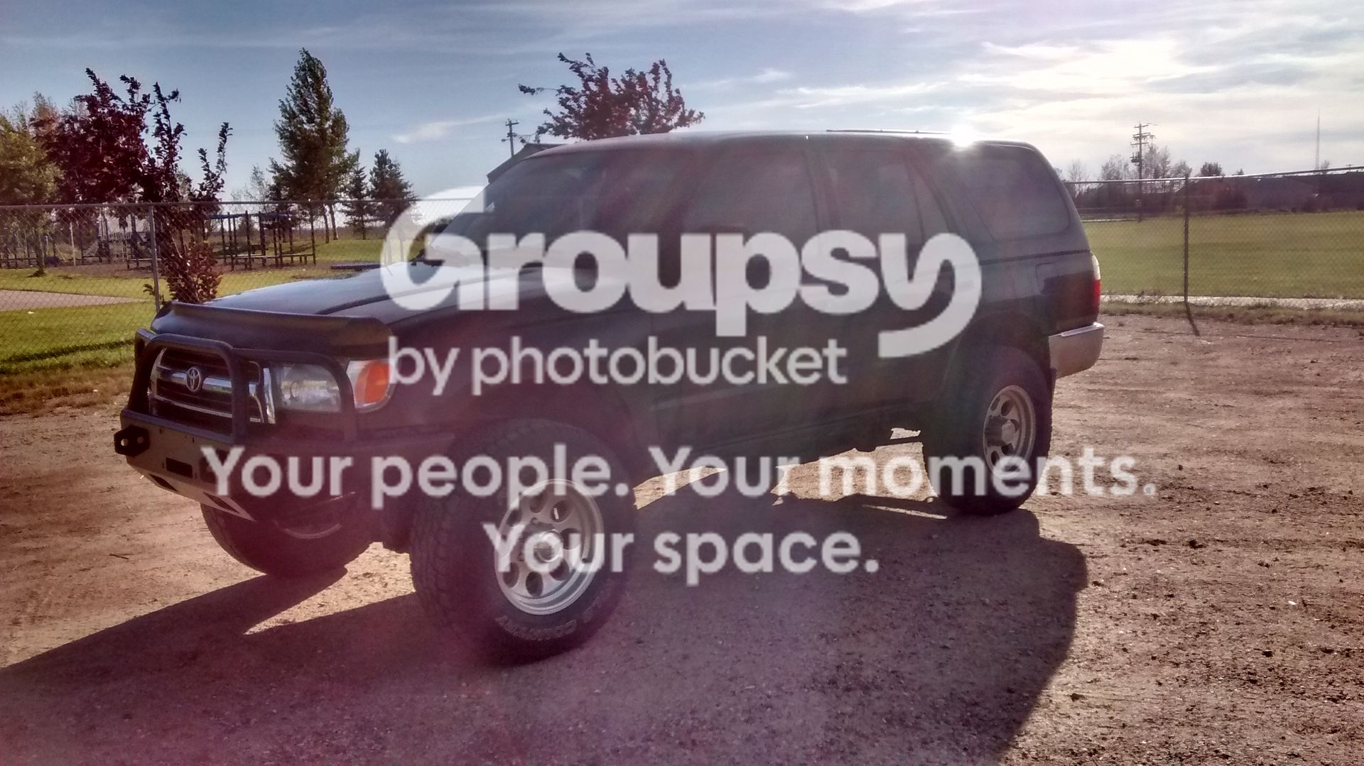

How it is now:

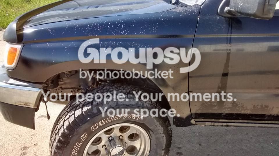

Here's a look at my front fenders that I changed out. I painted them with aerosol automotive paint from NAPA and they came out pretty good.

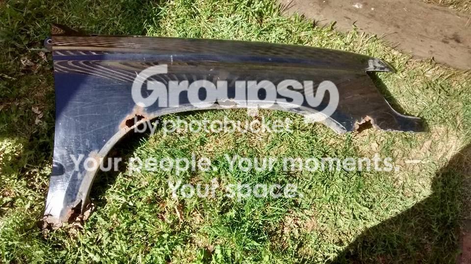

The silver strips on the old fenders concealed a lot of rust, and there were big rust holes in the front of the fenders.

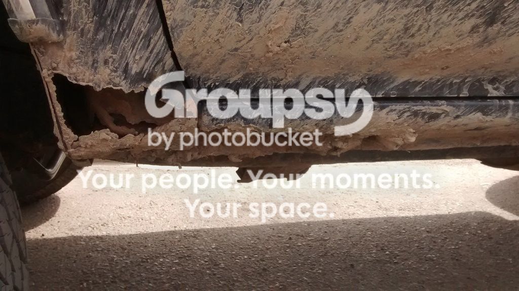

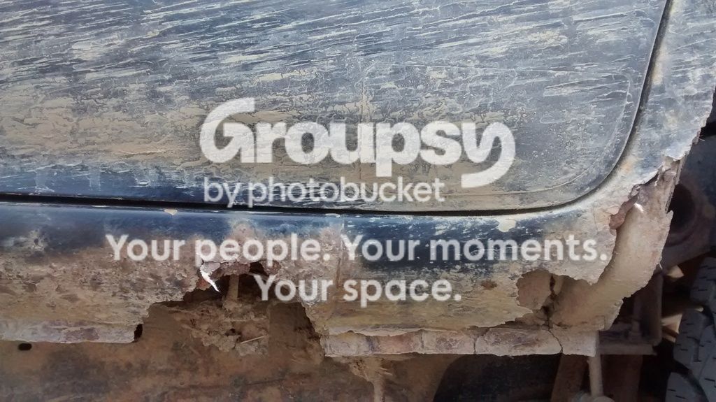

Here's some of the rust I am dealing with. I'm sorry if you live in the southern US and these pics make you cry.

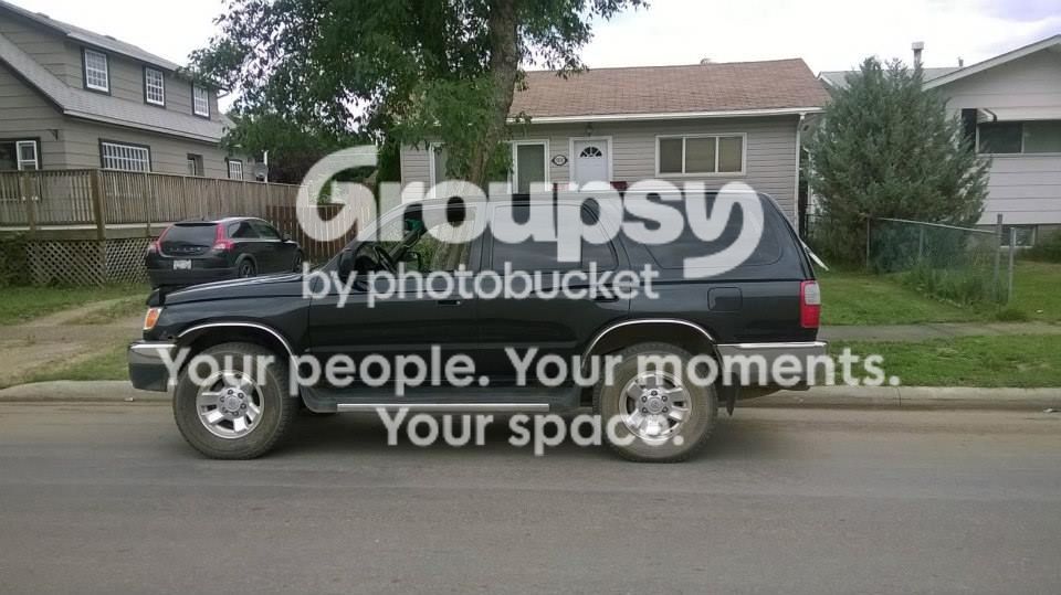

I removed the side steps. They concealed a lot of rust!
I will eventually replace the rust rockers with new ones in a year or two. I trimmed back the rust and the new front fenders certainly help with its appearance too. I have cut out all of the rusted spots, sanded, repainted and sealed up the good metal that is still left.
