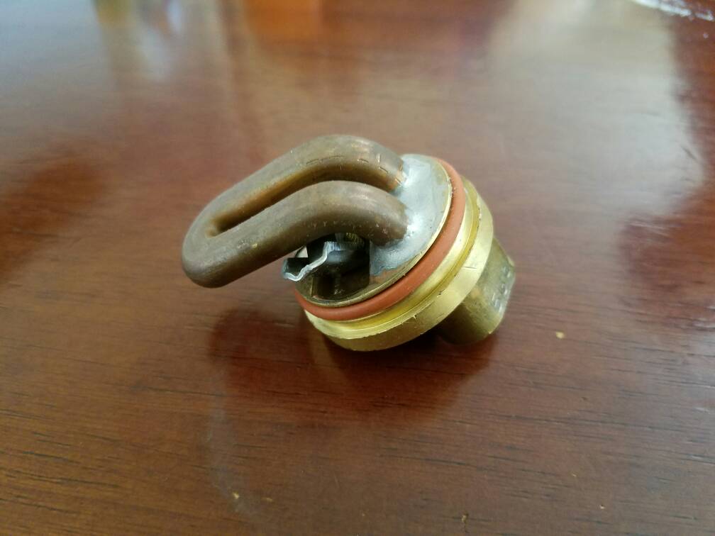

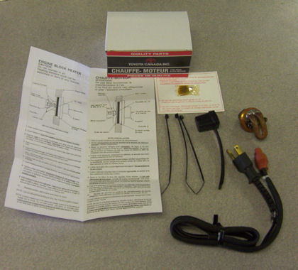

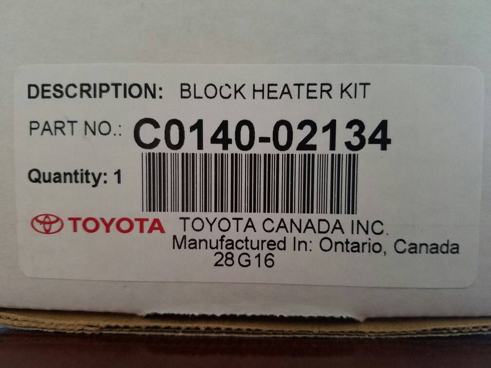

Has anyone installed or had trouble installing a block heater on the 3.4L V6? I found Toyota's part number C0140-02134, but opted to not go with name brand for cost saving. I decided to go with Kat's Heater 11414.
First off, let me say what a pain in the @$$ this was to install....
First, I couldn't get it to go in because of the clearance between the cylinder and the out block wall. For this I had to play with that sweet spot for the bolt and butterfly bar while figuring out that you actually have to insert the heater @ the 5:15-ish position while turning down to 6 o'clock position to seat it.
Second, as I was tightening the bolt, the o-ring under the bolt head would twist and pop out from behind the bolt head. Had to replace that with a smaller more suitable o-ring.
Third, now that its installed, its not flush (guessing because the heating element is right up to the cylinder wall) and leaking by the o-ring. According to Kats instructions, said not to use FIPG and to use a light torque.
I'm half tempted to purchase the Toyota model because (based on google images) the heating element appears to go over the butterfly bar, which in theory should help with getting it in the hole. But cant see how it would clear the cylinder wall.
The 2 attached pictures are the Toyota (from google) and the Kats Heater 11414 which I had.
Input with pictures are greatly appreciated!!

Verdict:
So I removed the Kats heater 11414 and installed a Toyota block heater. The Toyota heater went in effortlessly and without any issues. Highly recommend Toyota part #C0140-02134! I found mine at the local dealer for $49.99. Found others online for $60- $70.
If you look at the Kats heater, the element is too long and is a b*tch to get in with the element too long and the butterfly bar sticking out to far to make the angle to get in. Too many factors and too few sweet spots!
Comparatively, the Toyota brand heater was shorter and more compact with the butterfly bar tucked under the heater element. It also came with a small package of grease to help seal the oring. The cord also came with the cover for the plug which Kats didn't. And part of the cord was wrapped to protect itself from heat as you'll need to route the cord near the exhaust manifold.
Here's the catch, according to the dealer, Toyota never sold a block heater for the 3.4L 5VZ-FE here in the states.. the dealer ordered them from another dealer in Canada because they are only sold in Canada.

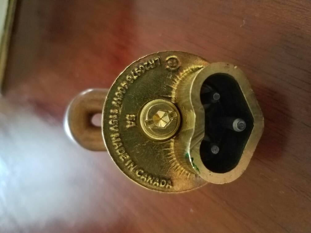

I cannot figure out the manufacturer of the heater (as I prefer to order straight from the source). On the heater is casted LR20976. This crosses over to Hotstart heaters, but this number is no where in their catalog. Thru other websites, the Toyota part number is listed as PYR02134 which comes up as Pyroil Canada, but I cannot find a website or any information about them.
If anyone can help figure out the manufacturer and where else to buy, I'm sure others would appreciate this bit of info.

I meant to add the stamping of the part for reference..

[MENTION=149505]hagnecco[/MENTION] thanks for all the info! I'm gonna cross reference the Toyota part number when I get to work today and see if I can pull any more info on it and if there are other options besides the Kats one.

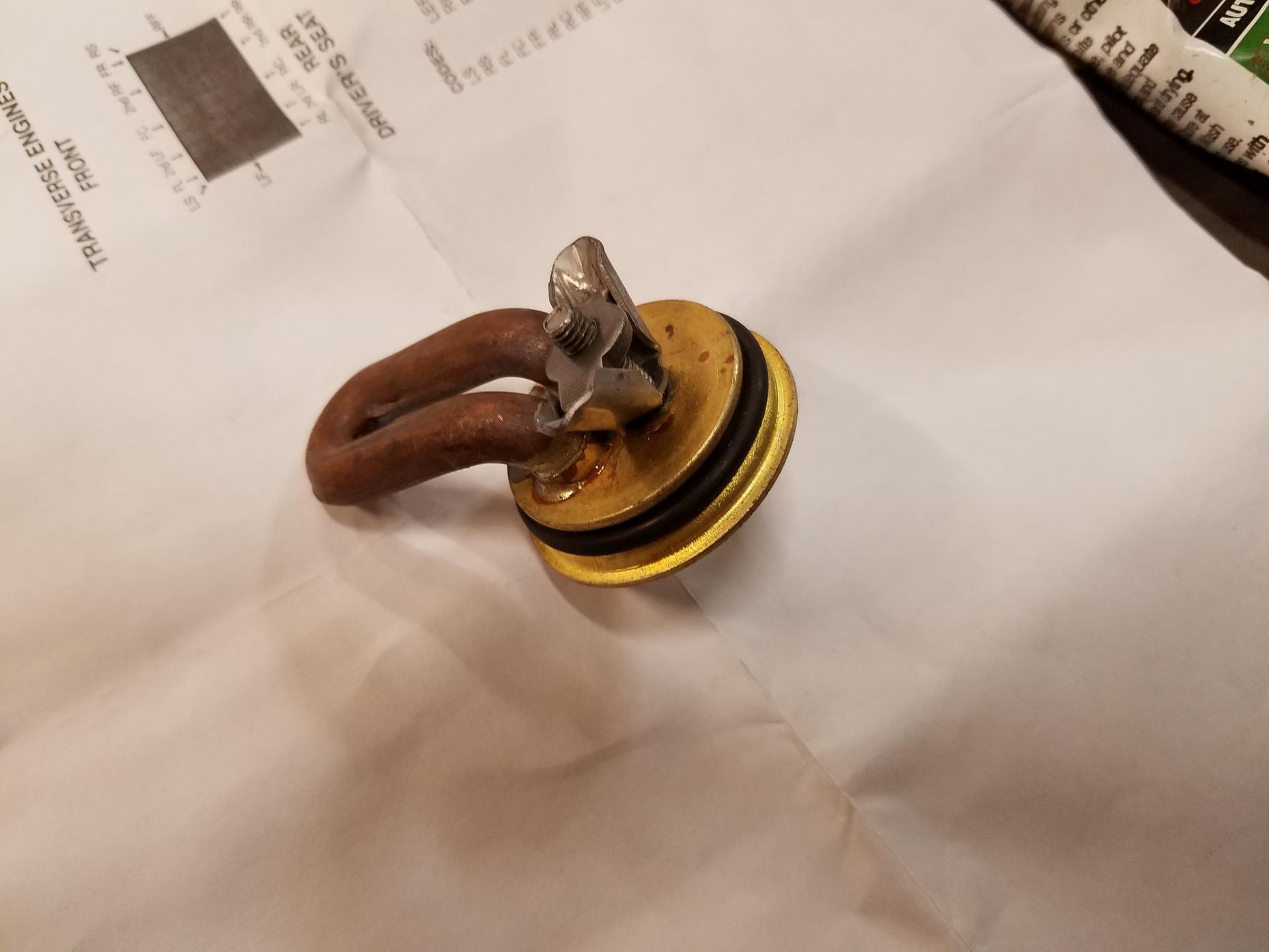

When you installed the toyota brand heater, what position did the heating element face? straight down?
I am having trouble getting my toyota brand heater in place. With it facing the 6oclock position, the top half didn't seat properly and popped part of the o ring out and caused a leak.
Any recommendations to get er to fit right?
I’m gonna be taking mine out this weekend since it’s leaking. I live in SoCal so I don’t need it. How does it go in? Screwed in or does it hold with just pressure?
