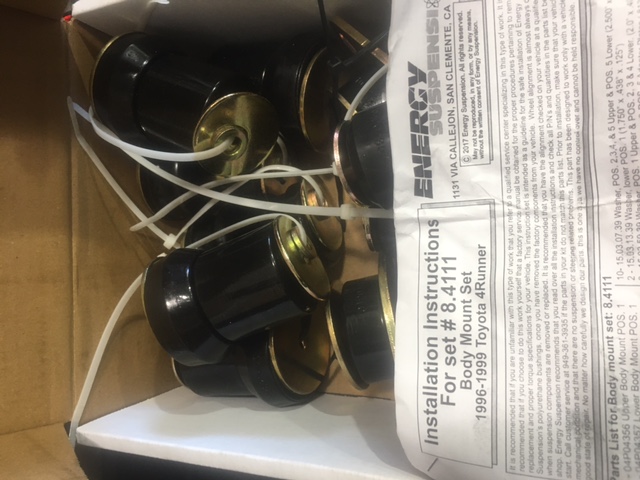

Poly kit is in tha house!
I don't seem to hear/see any mention of any lube/goop
for the mounts a la suspension components, is that because
these don't really move nearly as much? I'd hate to get everything
assembled and realize I missed a step and it's squeaking like mad...
