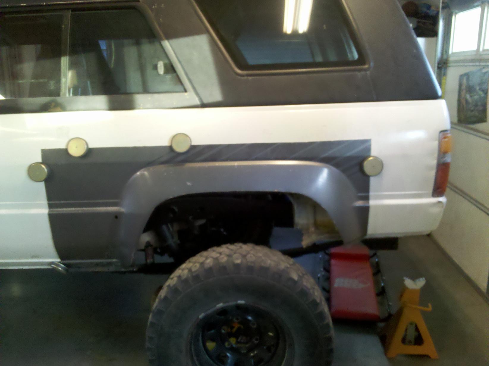

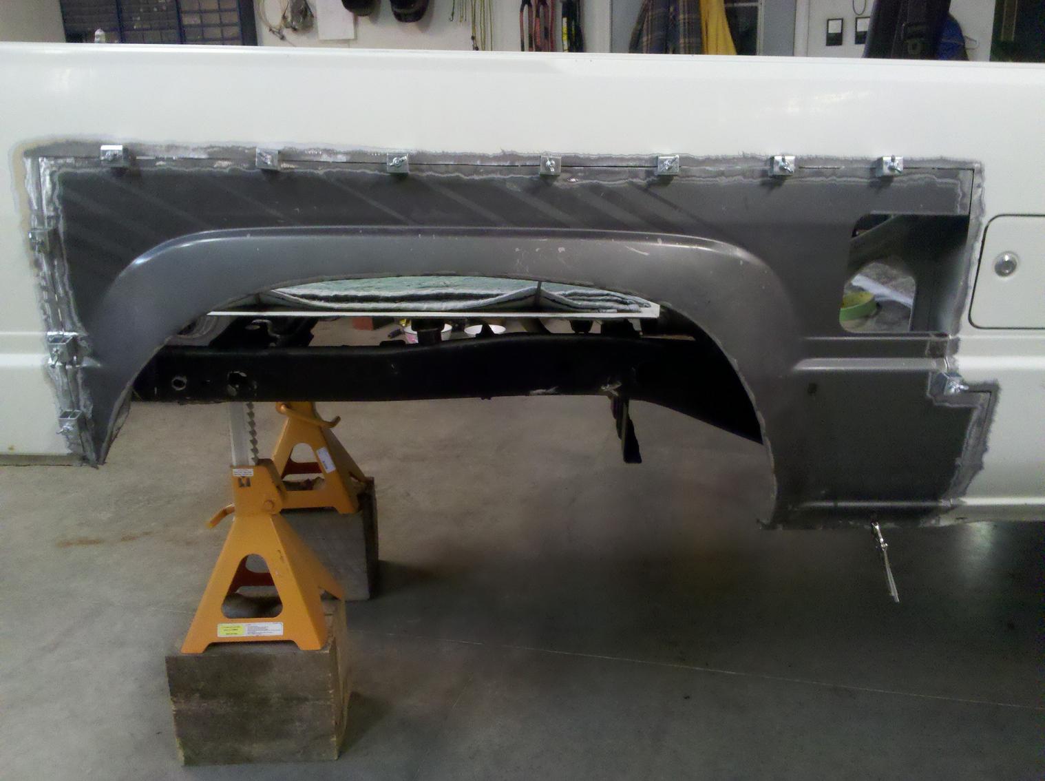

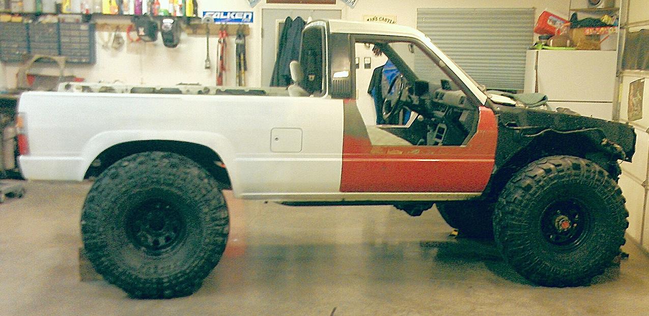

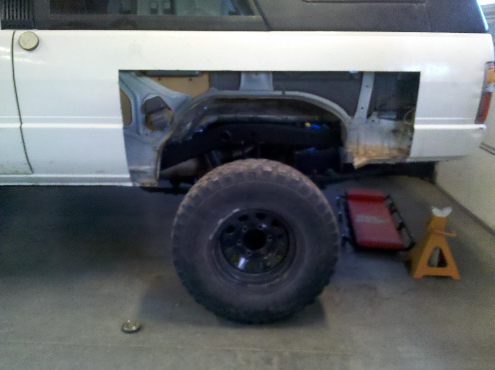

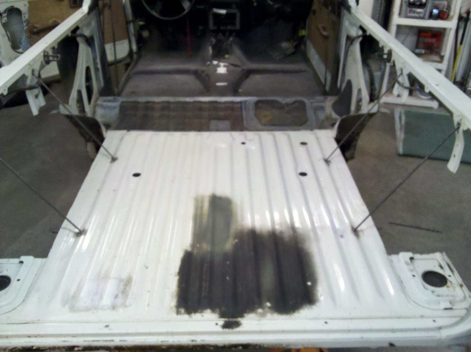

Here's mine. Stretched it 7 inches. Pretty much just layed out lines on my truck and did the exact same lines on my donor truck. From there I cut my truck out 7 inches back. On my donor I cut it 7 inches forward.

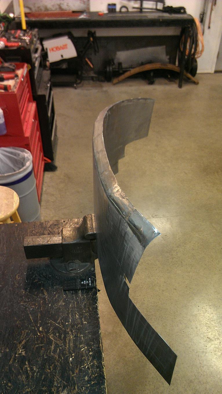

So do you transfer the inside too? For a more factory look or just extend the wheel well aft with some sheet metal?
Neat project, tons of work!
It doesn't look like he stretched the body, looks like he just moved the fender opening back.

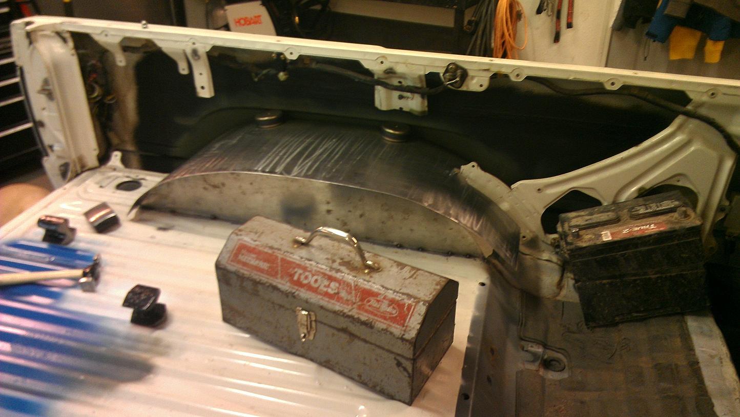

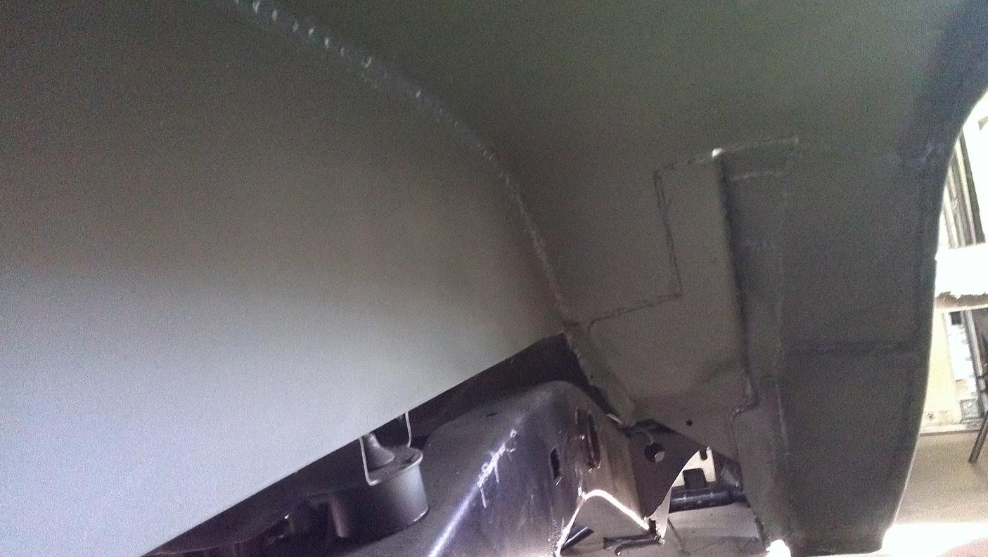

I'd like to see pics of the inside of the bed - did you shift the the wheel well too?
Yeah I cut out the inner fenderwells and made made my own. That was the hardest part. Only pics I could find at the moment
